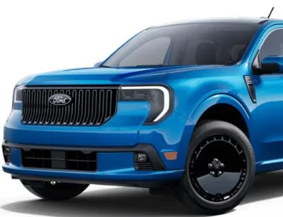

They do come 2025 with fog lights you just need to get the lower bumper valance that comes with them.
Can you help me out on the 2025 with fog lights. I have done some searching and cannot find anything on it. Do you have pictures?
Carlitos_92
Mar 24, 2024
2,293
4,664
They are only on the Lobo trim for now.
Pics are on the Ford website, but make sure you are on the 2025 models.

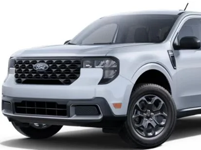

Is this what you are referring to in this picture?

Now I see what @Vtec87pr1 was saying about have to buy the bottom valance.
Ford Maverick F-150 Fog Lamp Switch and Wire Harness Installed in Maverick - DIY 1738714490627-tu
Looks like it would fit.
And what would the cost be I wonder. Would have to get body shop to paint it to match.
We can dream.
Carlitos_92
Mar 24, 2024
2,293
4,664
Yep!
We can dream.
To be fair, I think he was trying to put it on his 2022. 🤣
But body-wise, you should be able to do it on your 2025, but you'll probably have to do some wiring at a minimum.
