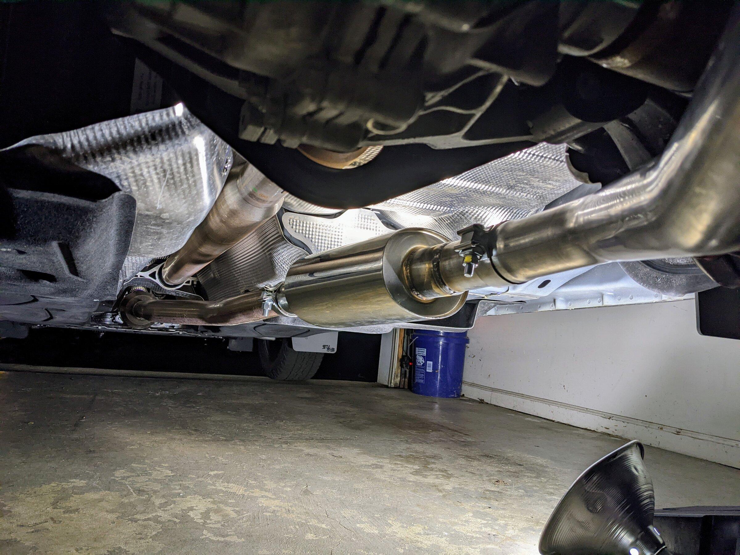

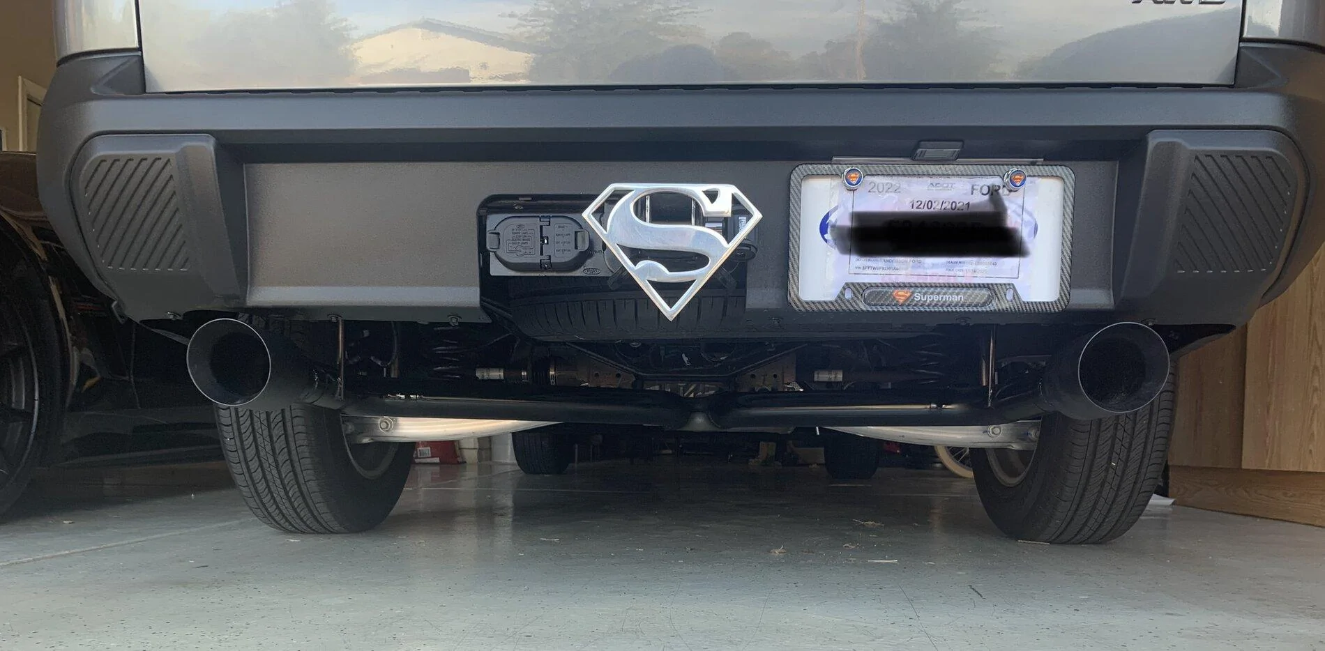

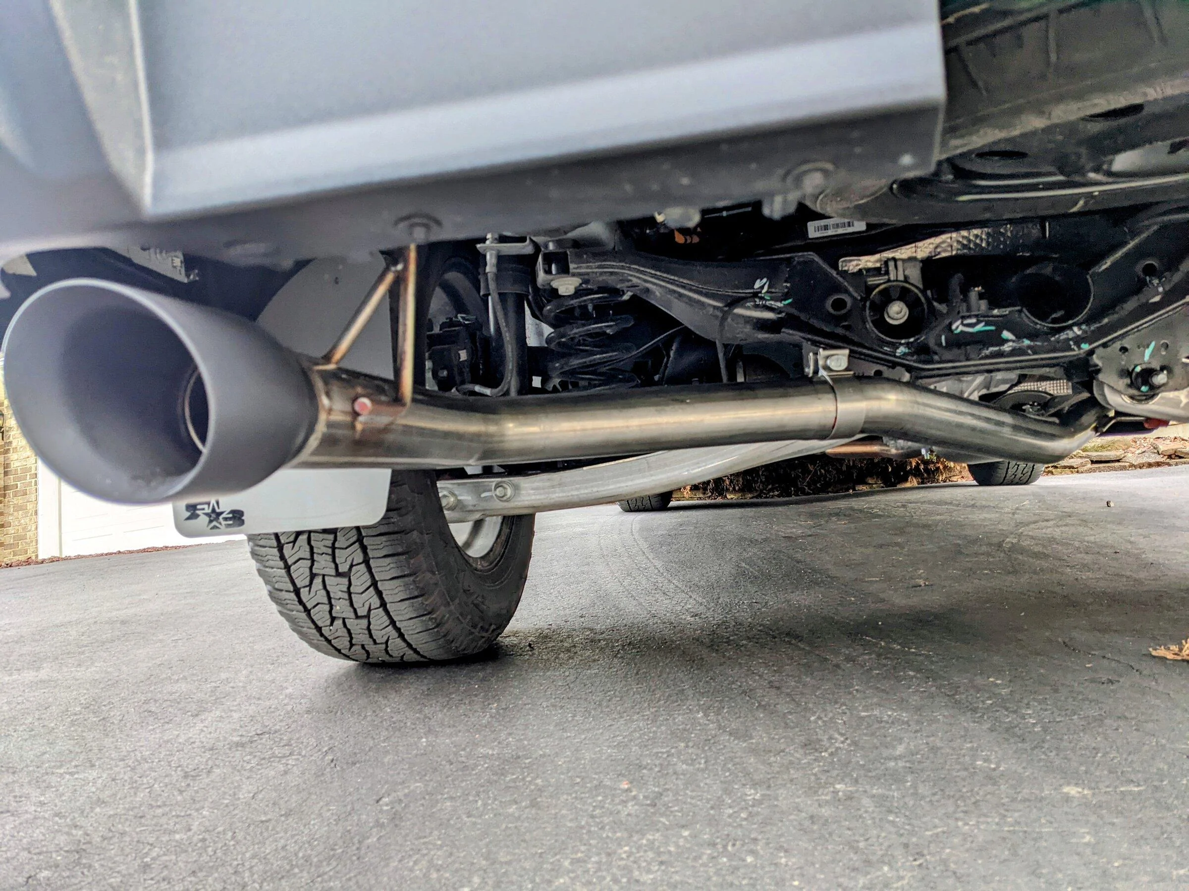

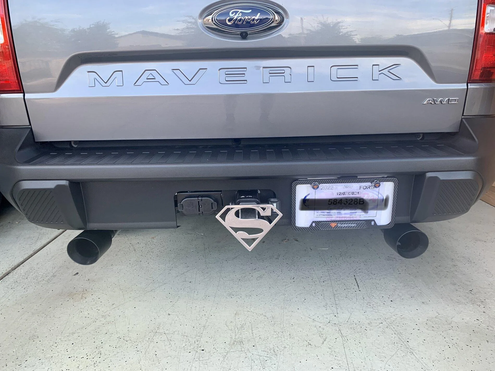

Now sounds like a deep throaty Focus RS. Shaved off 26lbs
Ford Maverick Exhaust will need serious help. 927DB543-674E-4054-A706-22CC1FE3954F

How do you tuck that anymore than SPRMAV did? Looks pretty tucked to me.
