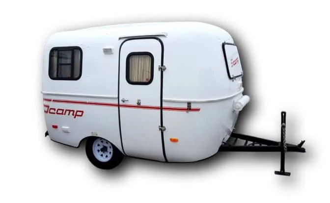

Scamp Travel Trailer $10k-$22k (~1200 lb dry - dry means no gear/water...)

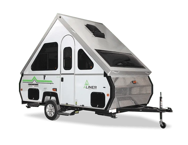

Aliner Ranger Classic 12 $20-30 k ? (1750 dry - getting close....)

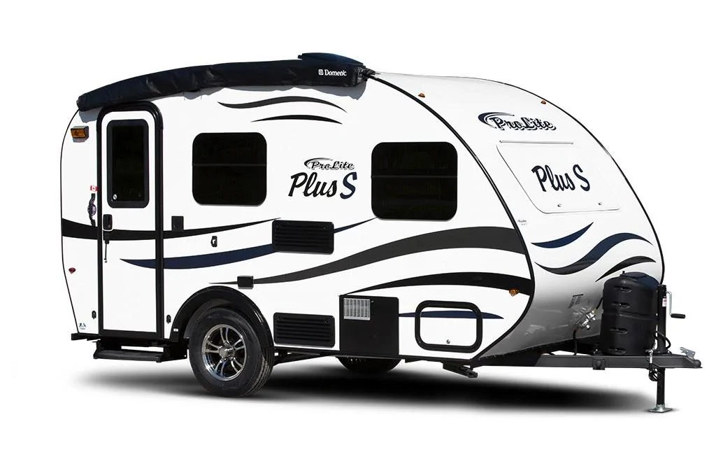

Roulotte ProLite Plus S $20K (1400 dry)

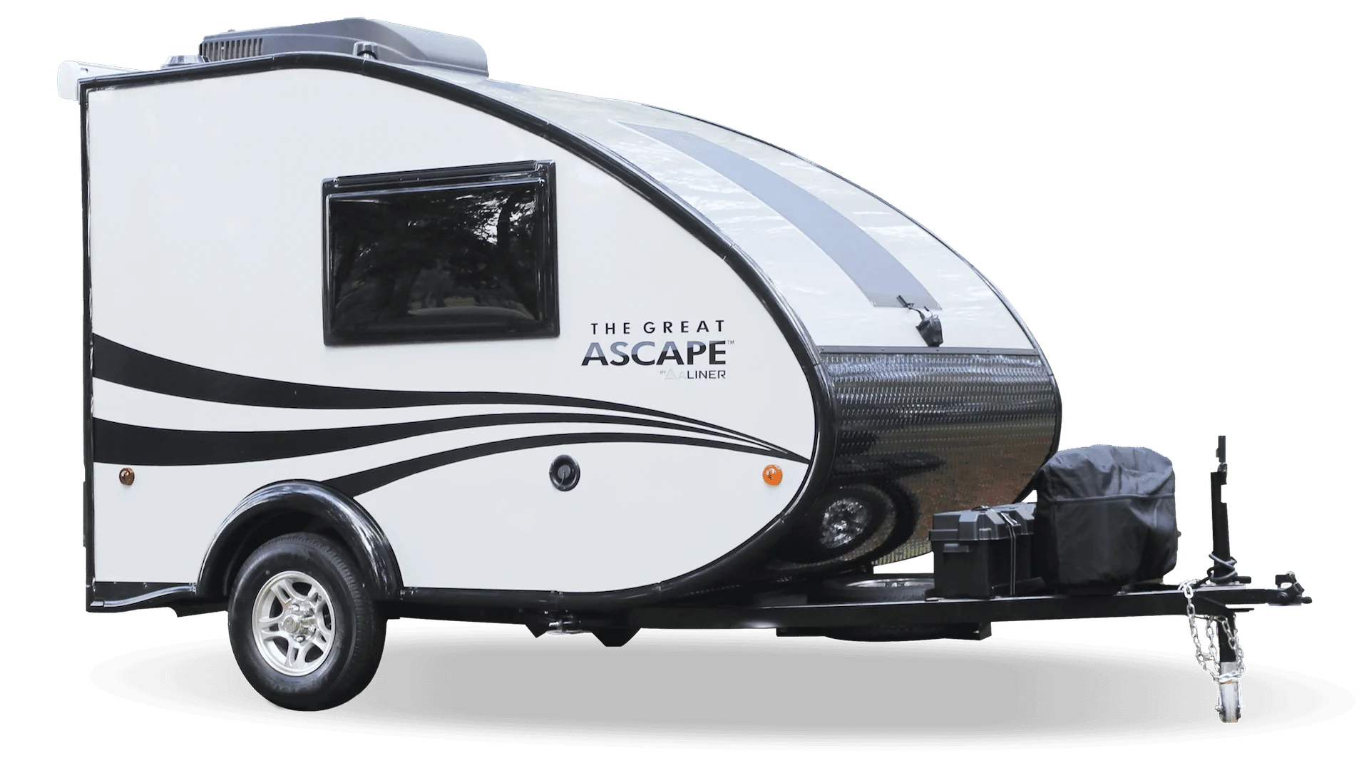

Aliner Ascape

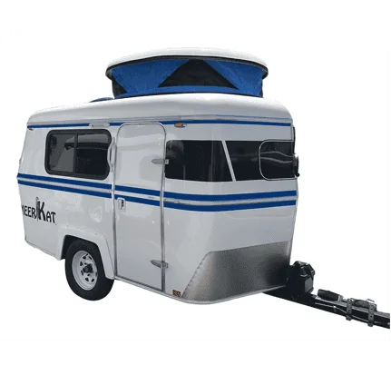

The Meerkat (900lb dry !!!)

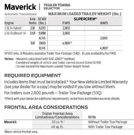

Is the non-tow package 2.0 eco AWD also max tow rated 2000 lb?
I know tongue weight also calculate into max payload and must be 10% of trailer weight.
What would be the heaviest tear drop or square drop trailer I can haul?
Based on the following, I believe even though you have the 2.0 Eco with AWD, it appears the max weight limit is 2K. Could be based on the New Vehicle Limited Warranty and the gear ratio difference between the Tow package. This will mean if you are near 2K tow weight limit, you probably have nothing to worry about, you will have the horsepower and torque.

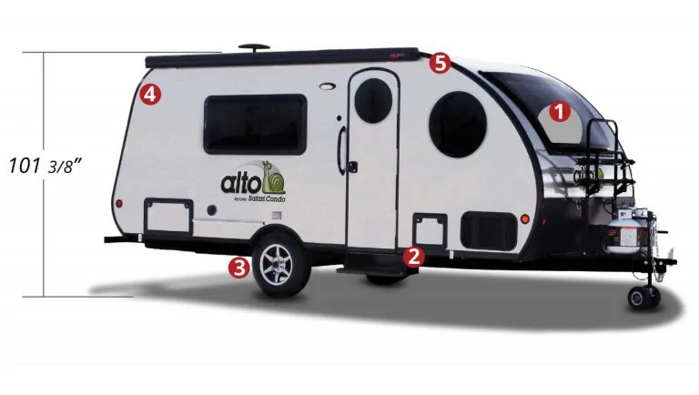

Have you seen an Alto in person ? They look pretty legit, seems like there is a big difference in quality from 20-25k to 35k-I am hearing the quality on these cheaper trailers especially the ones built in Indiana is pretty bad, half the work force is new, doesnt care and call out sick a couple times a week. I really liked the Aliner Ascape but they halted making them over a year ago and now just offer the Hard side pop-ups that get really mixed reviews.
I saw an Alto F2143 this week :) And it is a nice and solid build. Of course it is around 50k US. and a two year wait :-(
