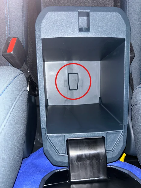

I was thinking of adding the locking safe/vault to the center console. But that would block access to the key slot at the bottom of the console. Is the only solution to cut an access hole in the bottom of the vault?
The vault from Ford does not have a bottom.

Thanks. Because of Ford’s price I was looking at alternatives. But after your reply I dug a little deeper into the vault offered by Ford. It does have a bottom , but there is a cutout for the fob access. Guess I’ll have to recalculate to decide if I really need it at the price. Thanks again.

For a 2025 Ford Maverick with a push-button start,
the backup key fob slot is located in the bottom of the center console storage compartment. This is a fail-safe feature designed to allow you to start your vehicle if the battery in your key fob dies.
How to use the backup key fob slot
  1. Open the center console and remove the rubber mat or cover from the bottom of the compartment.
  2. Locate the slot, which is a recess or outline specifically designed to hold the key fob.
  3. Place your key fob into the slot.
  4. With your foot on the brake, press the engine Start/Stop button as you normally would. The vehicle's system will then read the fob's chip and start the engine
