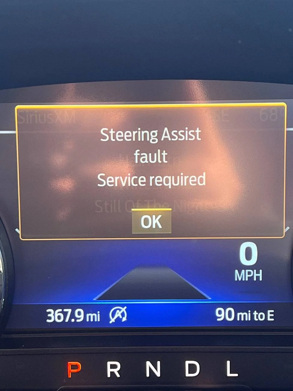

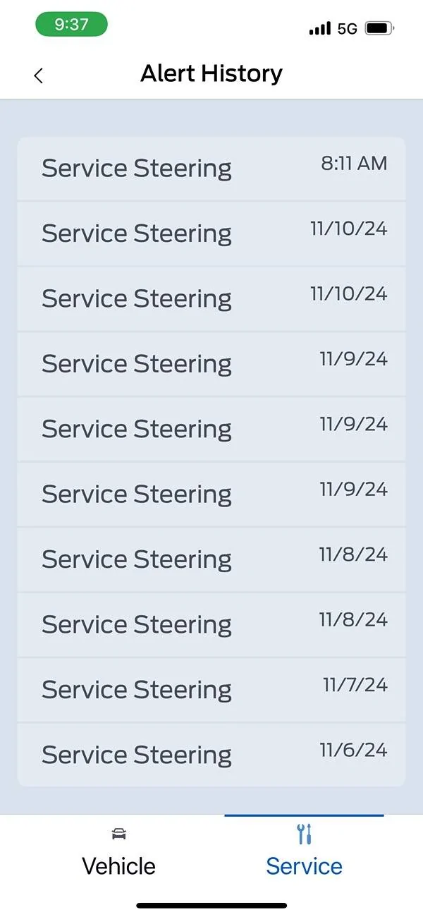

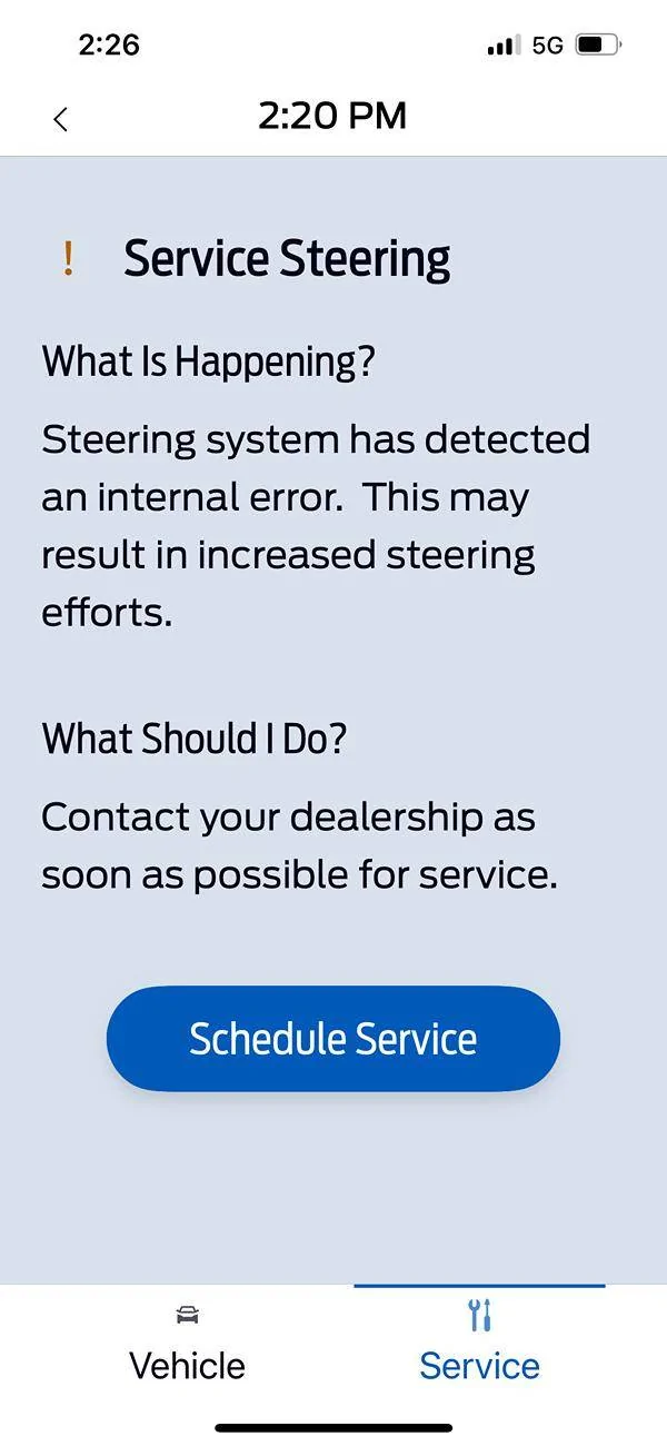

Just bought a ‘24 Lariat last Thursday and got this error while driving home from dealer (30 miles on odometer.) My truck was on the showroom floor with the battery disconnected before I test drove it. No error during test drive.
Went back to dealer right away and they said the error should probably disappear after a few miles, but it didn’t.
I went back to the dealer yesterday and had the battery fully charged, since a battery that isn't fully charged can apparently cause all kinds of errors. Was told that should probably fix it.
Well it didn't... The next step is to put it back in the shop for more troubleshooting.
I will be dropping it off tomorrow.
This kinda sucks the fun right out of buying a new vehicle.

Dealer just called. It’s a bad sensor in the steering column. It’s available and has been ordered. My truck should be fixed next week. Fingers crossed.
I chose not to go the “Ford Motor Company” user account way, since my case is already moving satisfactorily.
SgtThump
Nov 6, 2024
St Louis, MO
Maverick Lariat
Got truck back from dealer after a few days and all seems well so far. The steering assist errors have gone away. Maybe I can enjoy now, instead of worrying! LOL
