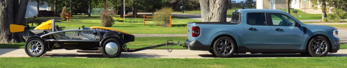

I have an XL with Silvers coilovers and they're set pretty low with a 5" drop all around (more info on the set up in my build thread here, post #13).
Ford Maverick Eibach lowering kit towing issues tow3

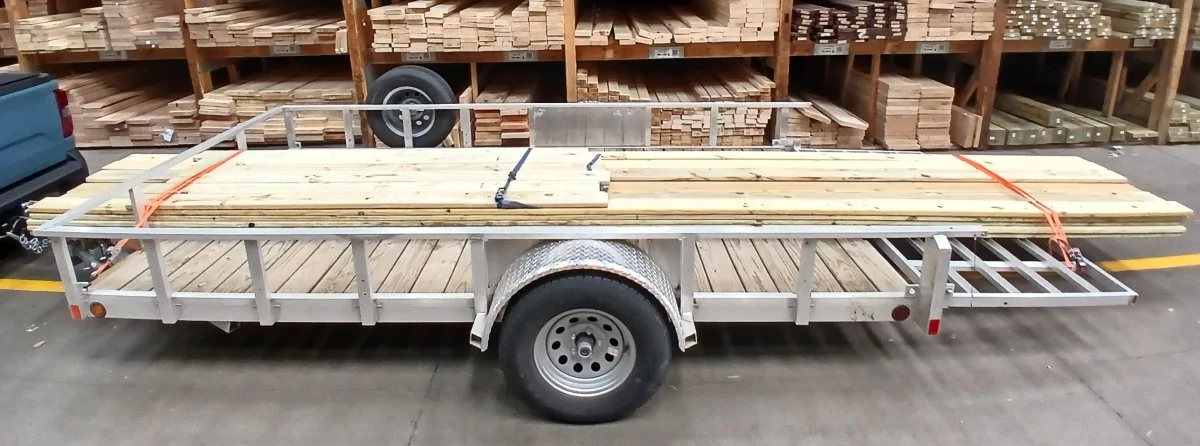

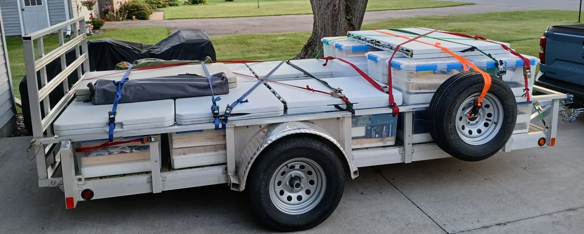

I tow a dolly with my track car on it. I've towed a 13' aluminum trailer with lumber, a load of river rock, and car stuff stuff to/from swap meets.
Ford Maverick Eibach lowering kit towing issues tow2
Ford Maverick Eibach lowering kit towing issues tow1
All loads are around the XL's 2k max. Tows like a dream, never had a problem.
I guess it might depend on your tongue weight? My trailer is aluminum and relatively light, and I also load it carefully with tongue weight always in mind.
When I have a significant load in the bed, or higher tongue weight on the trailer, the rear of the truck does sit lower and reduce the rear tire to fender liner clearance. But since the springs are stiffer than stock, I've only had the occasional rub on a rough road but nothing major. And I've never had any problems or unexpected behavior while towing.
