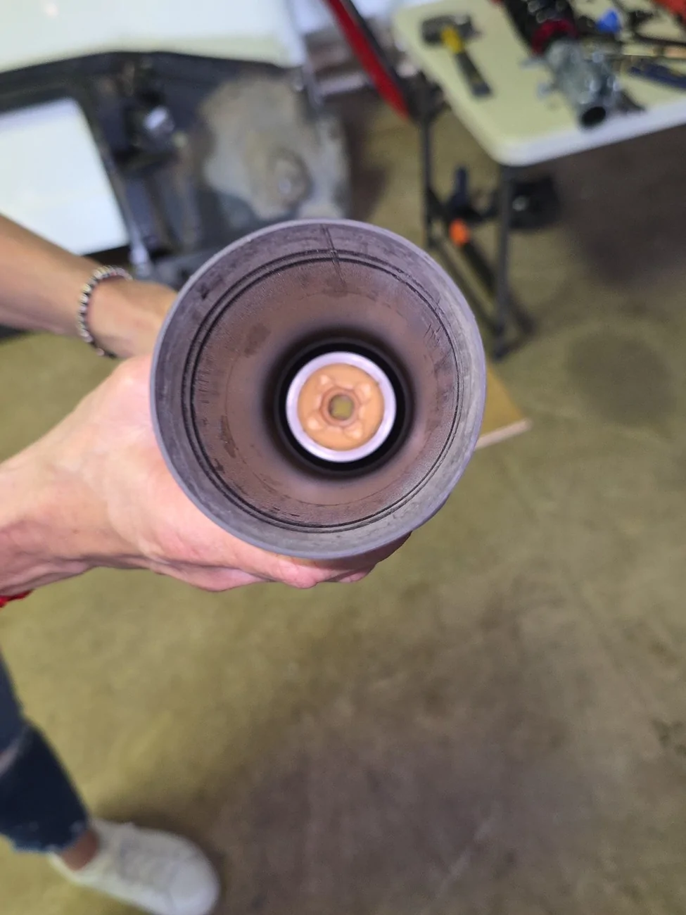

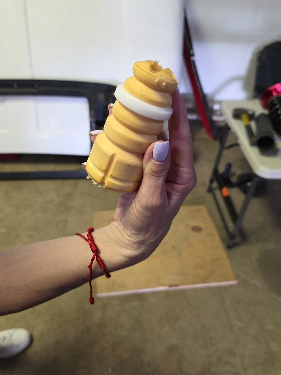

You can always take your shocks off slide the upper sleeve off and trim your factory bumpstops. Make sure it's at the bottom of the bump stop

I have a 25 hybrid xl trim the rears about 2 inches should be plenty
