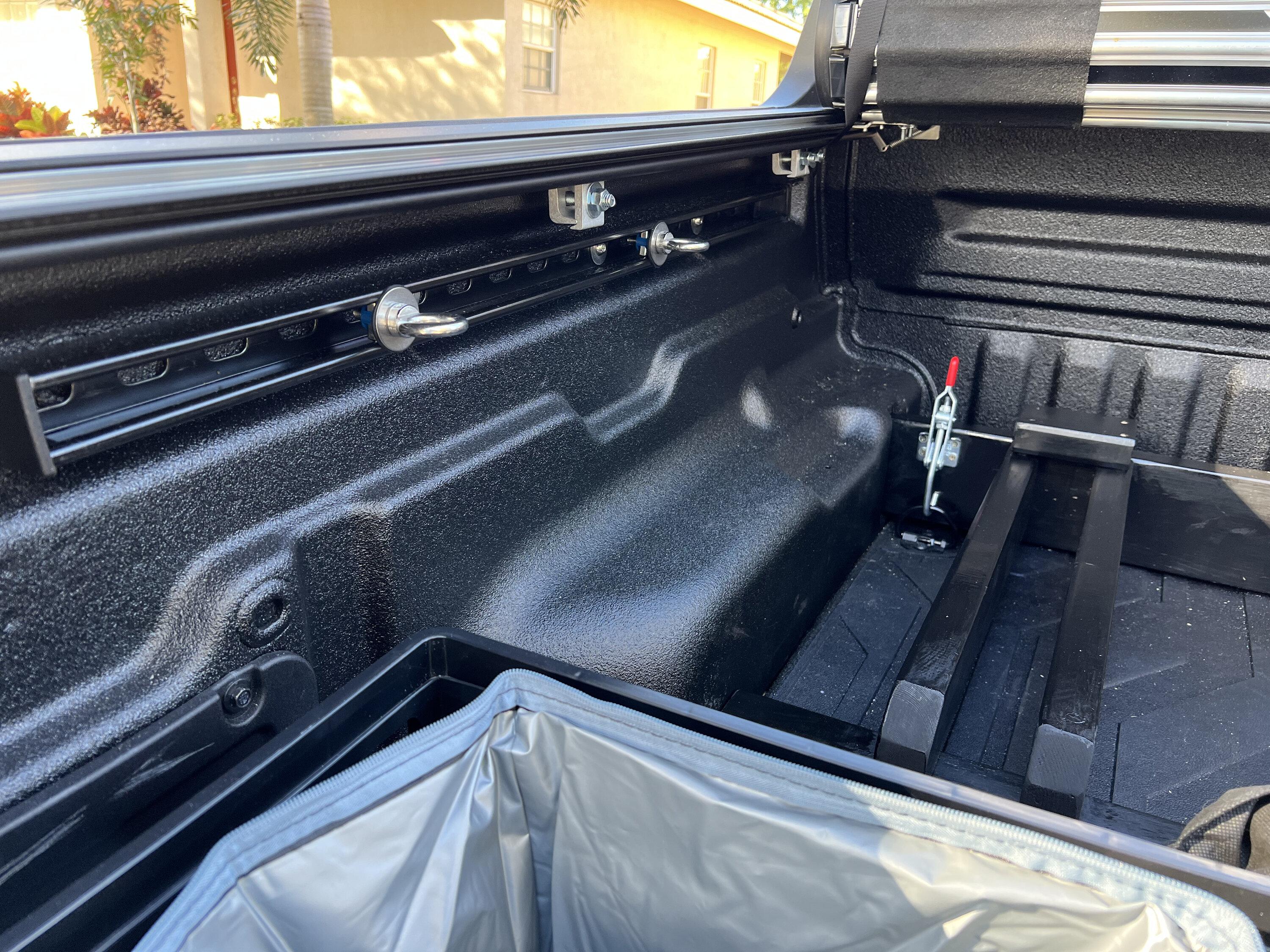

SoFlaMav
Dec 11, 2022
South Florida
2022 Maverick XLT FX4
Hey thanks for this. I didn’t see black, but I found a good price for the Zoro ones in aluminum. I’m wondering if you could share where you got your end caps? Or what ones exactly? I want to make sure the ones I get fit. Thanks!
https://a.co/d/foNxy9h
These are the caps I used... Had to do a little snipping with a diagonal cutter to get them to fit snugly.
SoFlaMav
Dec 11, 2022
South Florida
Hehe... a little too snug. Had to snip the corners of the part that goes into the rail to help them get in there and grip. You'll see when you try it.
