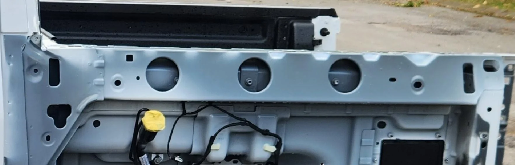

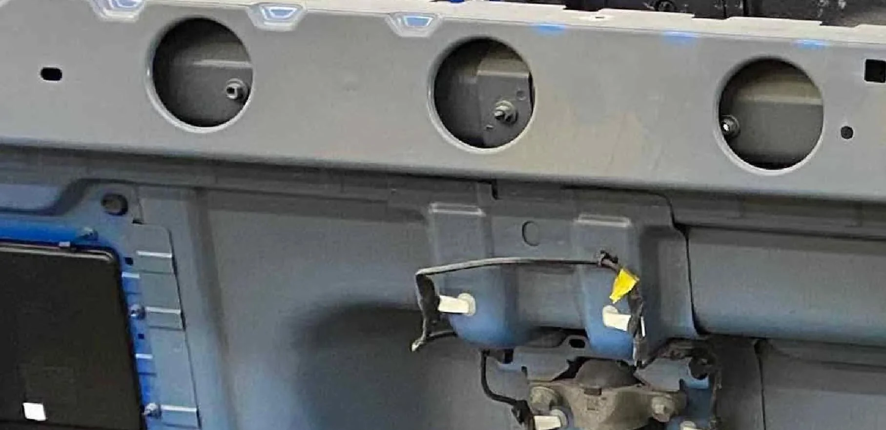

The bedside threaded M6, M8 look like Ford's version of RivNuts.
Probably the backside of them visible in the holes of RedNeck Garage's pict.
Ford's kit has 3 spacer washers they put behind each rail.
Ford Maverick DIY Bed rails question Bed Rail - RivNuts -RedNeckGarag
Ford Maverick DIY Bed rails question Bedside Rail, Cubby - Ford RivNuts
