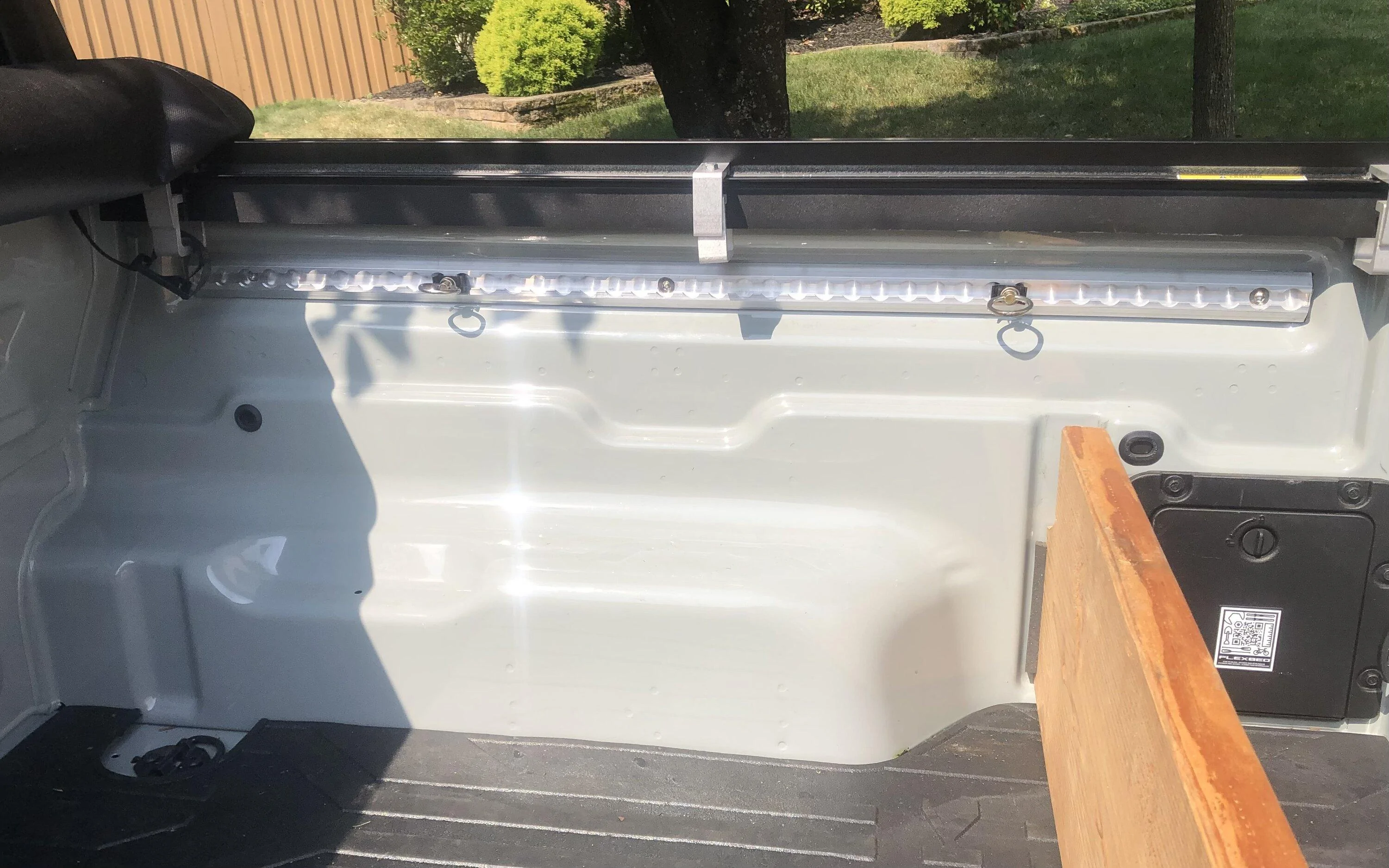

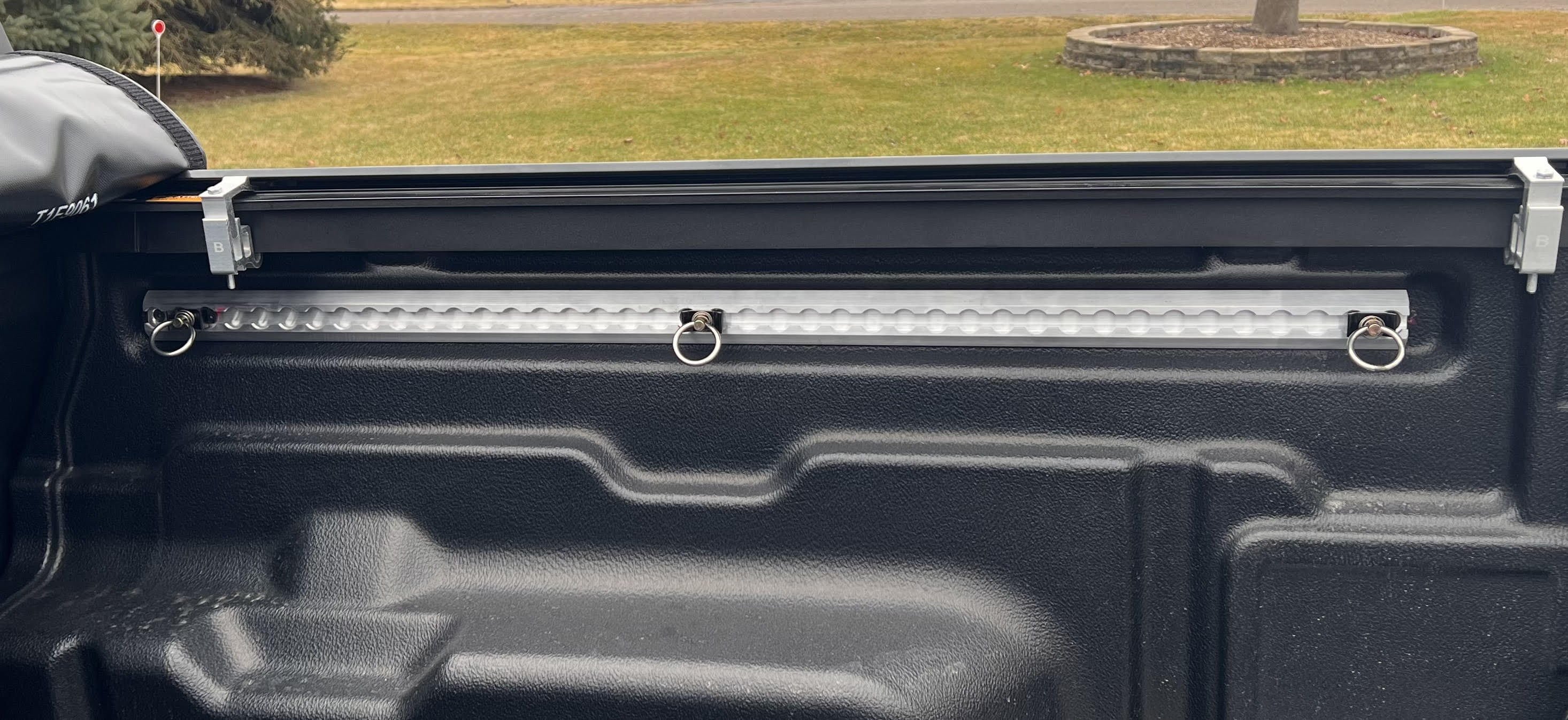

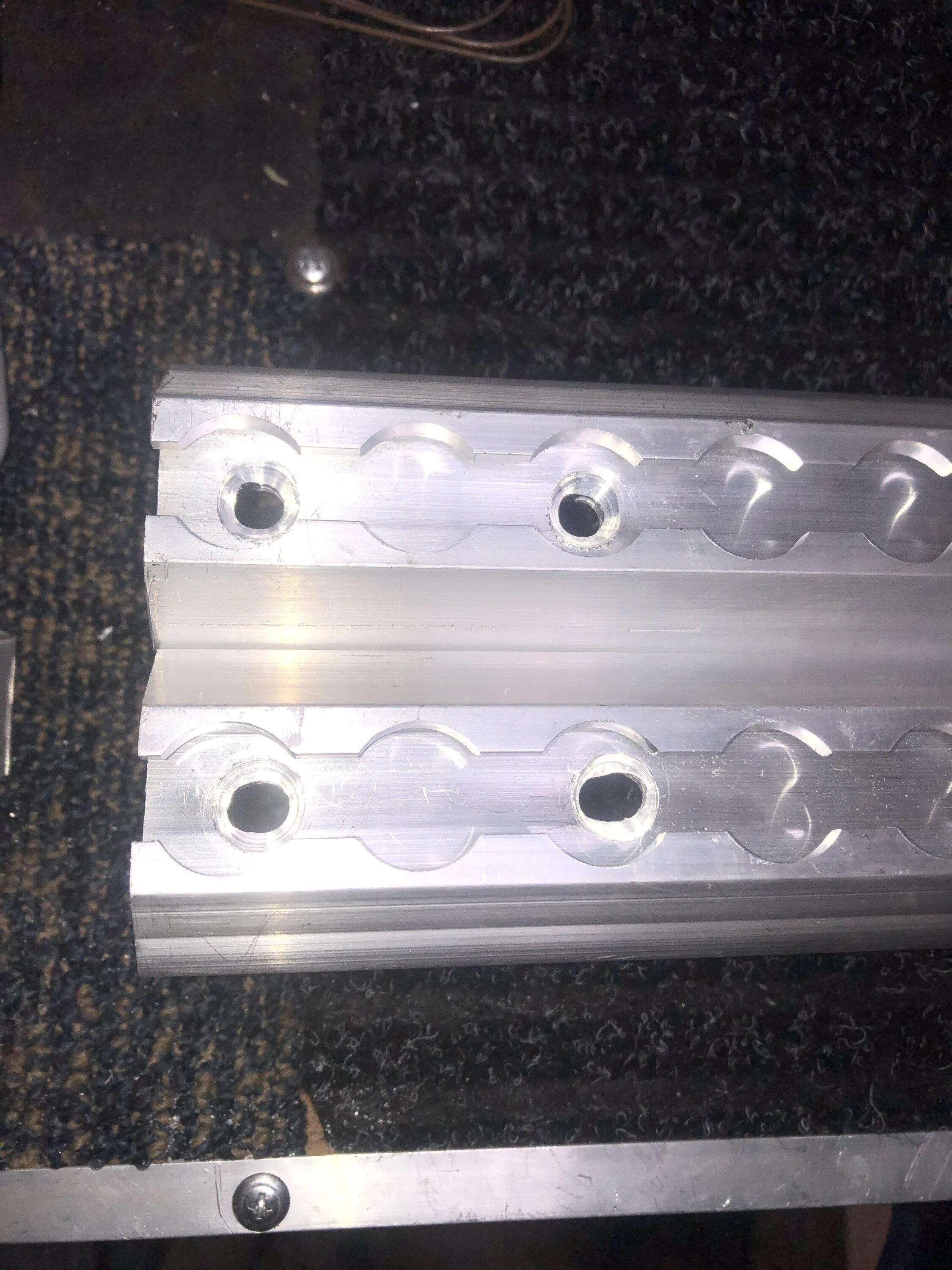

Using information from Barracuda340 , I finally got my rails installed. Using undrilled L-track from https://www.cargoequipmentcorp.com , tie downs from Amazon, and flat head 6mm and 8mm bolts from my local hardware store, I cut the tracks to length and drilled and countersunk the holes for the bolts. It is handy to have a machine shop. Approximately $95 in materials and I feel it looks sleeker than the U channel method.
