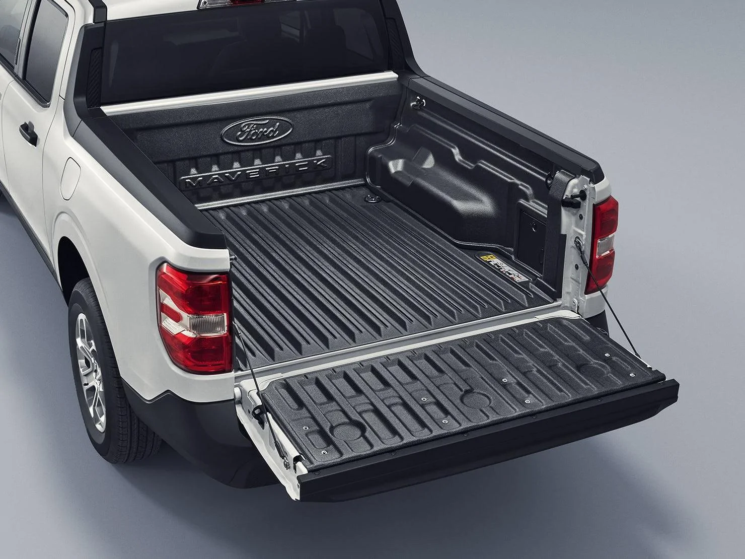

Thanks Gang! After more investigation and now that I have the kit in hand, I have a better idea of what I'm faced with.
Thanks to 1fifty for the tip on the cut off wheel and straight edge.
The video linked by Blue1870 -in fact, I saw it before and that's what led me to ask the question.

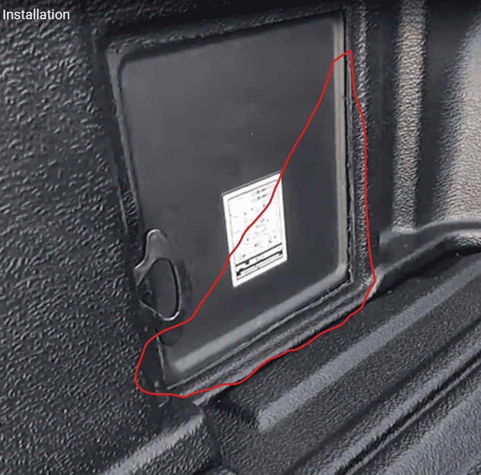

In that great instructional video that Sam Haymart put together, he used a jigsaw for his cutout but his cutout in my opinion came out pretty rough and uneven. It doesn't quite look finished. Sorry.
Ford Maverick Drop-in Bedliner cutouts mount behind access panels? 1678494561755
I have yet to see a factory installed DIBL but if it came to me with rough uneven cuts, I would request the dealer file as a defect and get it redone.
I don't think I can tuck the bedliner behind the access panel frame since they would end up on the raised section of the frame in the liner wall.
So I think I'll attempt a very slow cut with either a cutoff wheel or a finer jigsaw blade though I'm also going to experiment with a large Olfa Utility knife to see if I can cut through the middle of my cutout. A sharp razor blade should leave a pretty clean edge - maybe even possible to score it first and then use a cutoff wheel.
Worse case, I'll get edge trim to cover the cut edge if it doesn't come out clean. I know this is probably way overboard and nobody would notice but I would - everytime I look at the access panels. LOL.. THANKS! Will update when I complete the project.

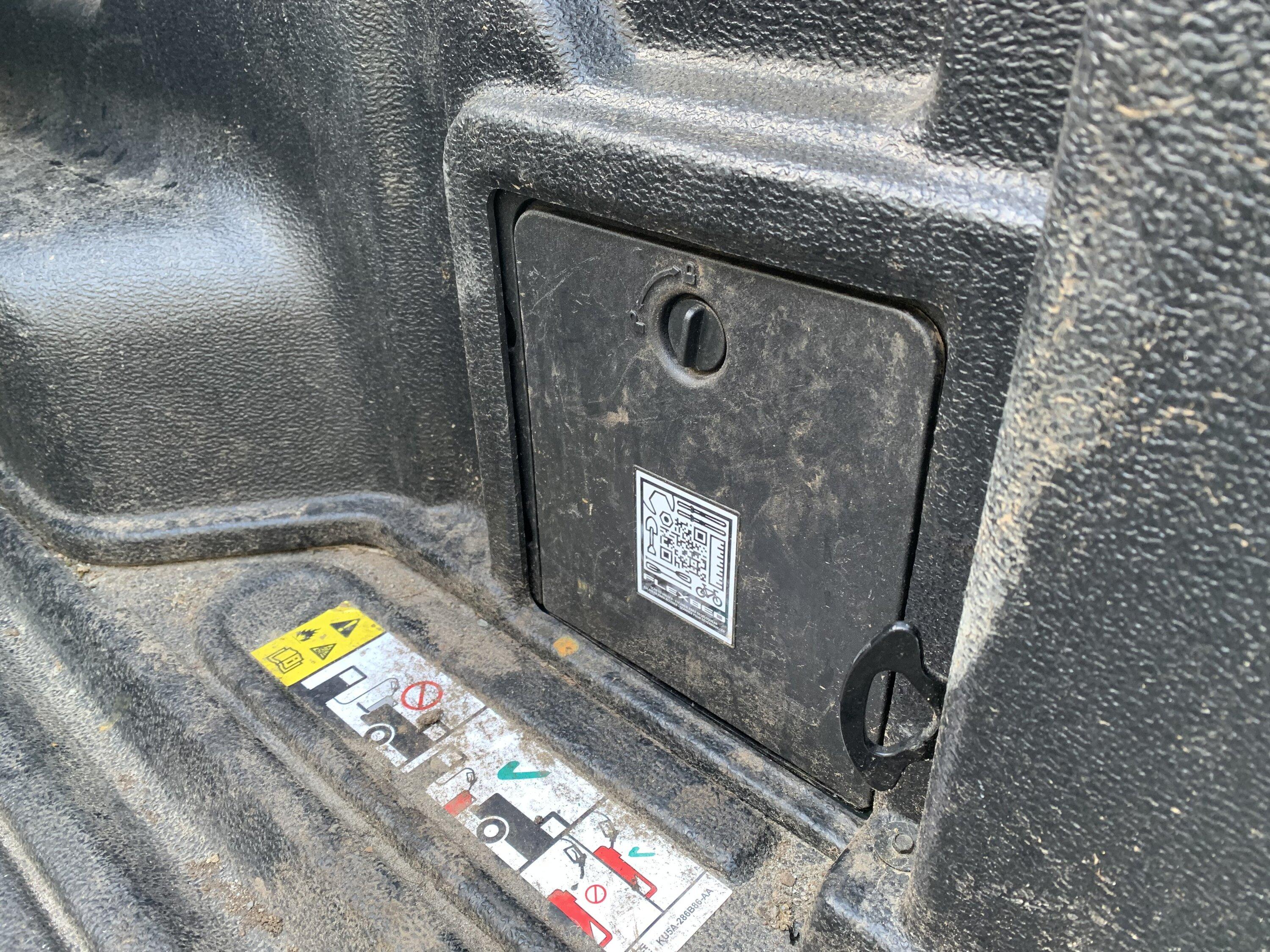

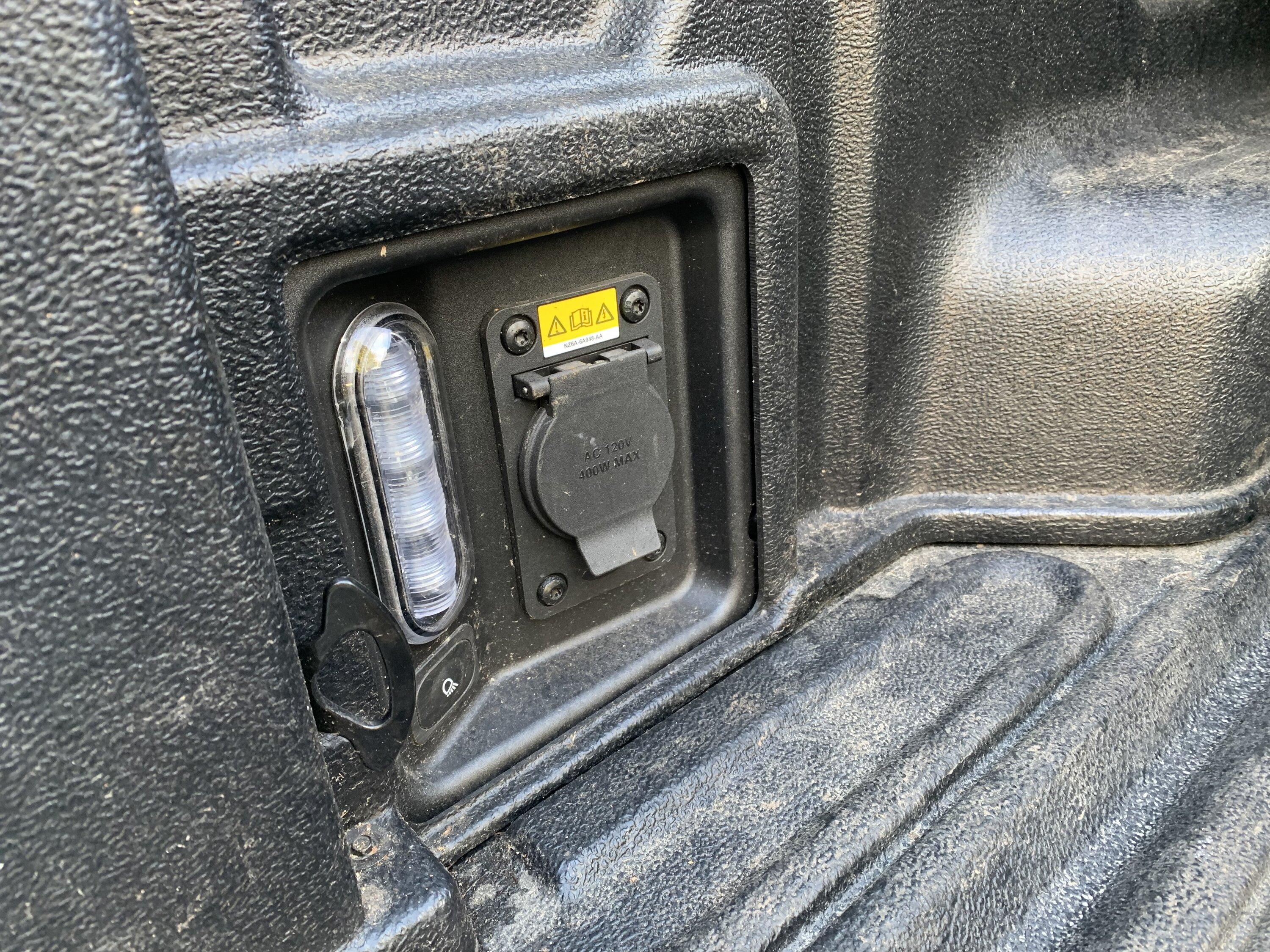

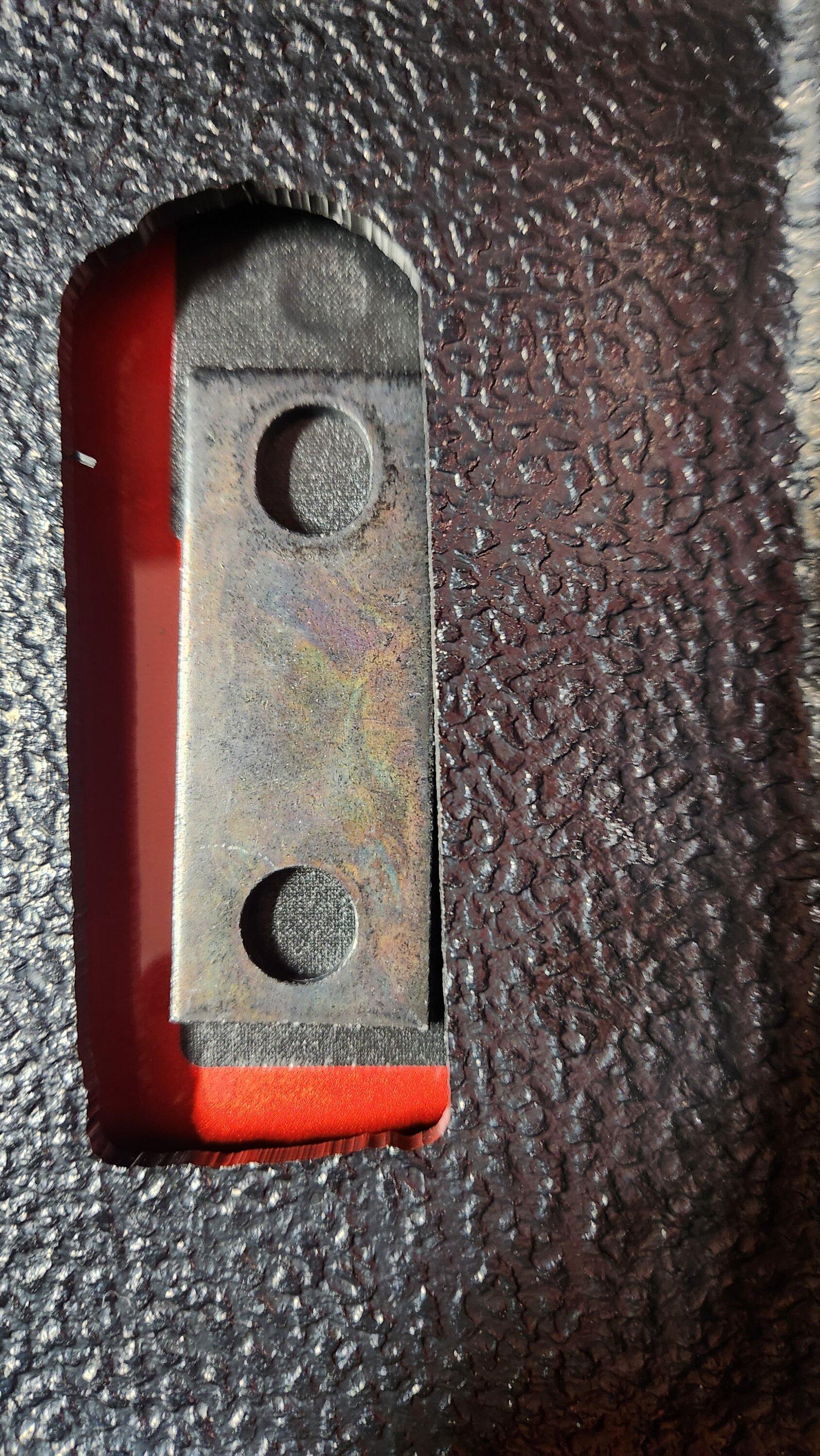

This falls into the WTF category... I am so frustrated w Ford's lack of attention to detail and quality lately. Will spare u the details of a previous Ford accessory order for Mach E GT wheels which came in damaged. Re ordered and they took over 2 months to refund my return.. 12 calls to the group before I finally got my $1,400 refund..
OK. So I definitely received a new kit but I am scratching my head as to why the cutouts for the front floor tie downs are so big and different in shape from my hardware. Followed instructions to a T for the black square stickers, re positioning them to match the instructions. Nowhere near close to lining up with the far too big cutout. Did I get a bad floor liner?
Why didn't they just give us 2 oversized rectangular stickers to properly cover the opening? Probably a cost thing I can only imagine...
So now, after spending $400 on a kit, I guess I will need to buy some black gorilla tape to fix the deficiency?
What did u guys do? Even if I reposition the stickers, I will still have the bed color visible in the middle of the backet since I have to move the stickers further apart.
It sure doesn't look as clean as the stock photo which also shows a rounded tie down. Not rectangular as you would expect from the cutout.

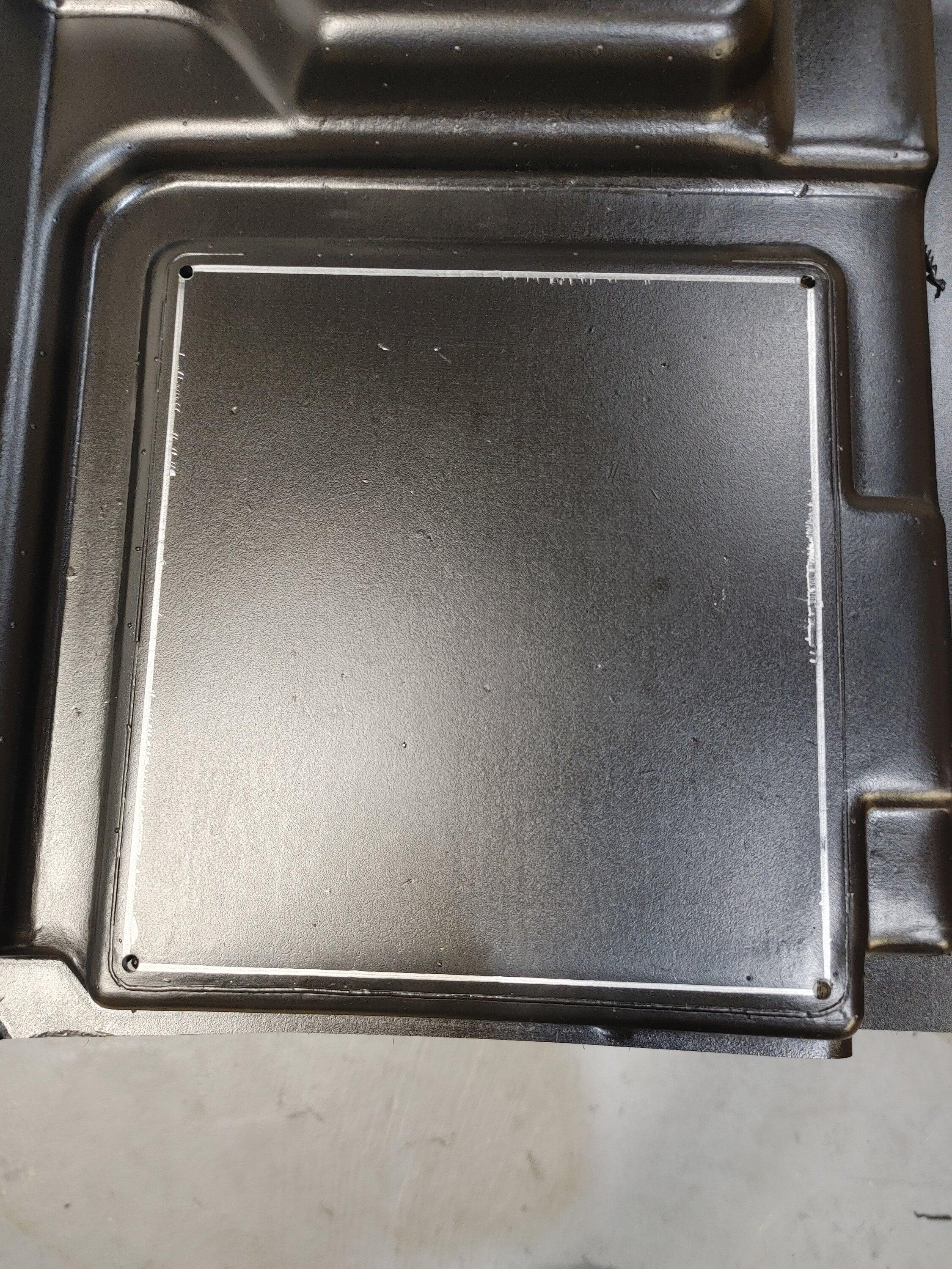

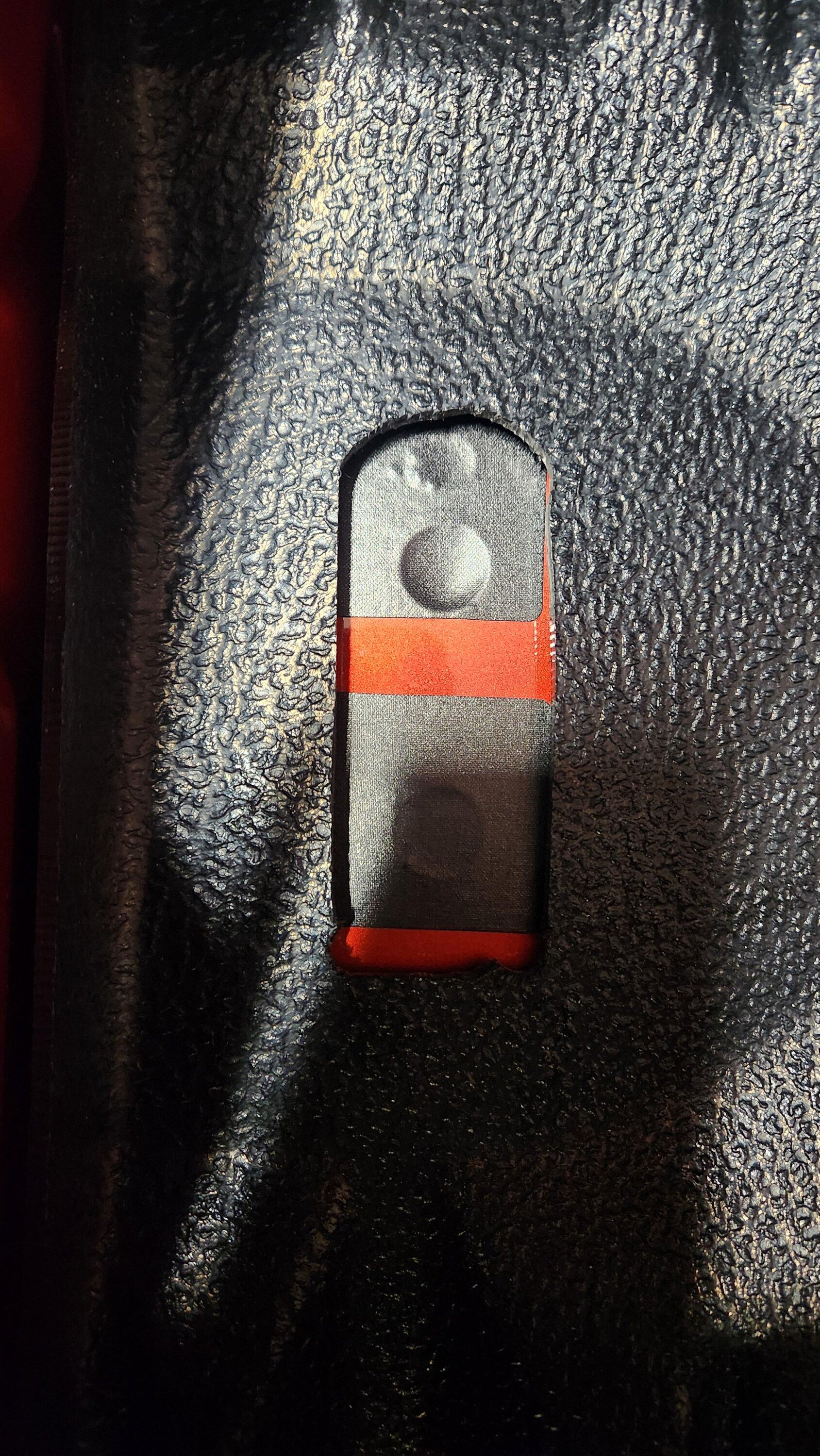

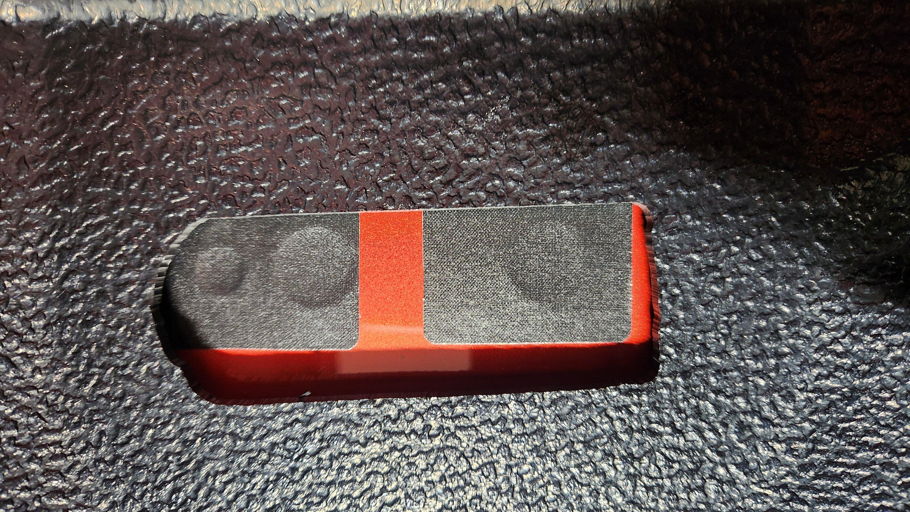

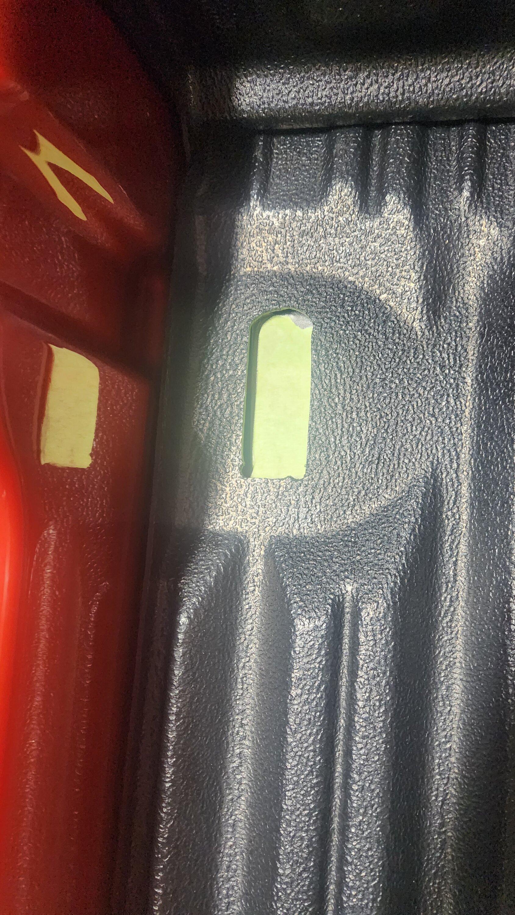

OK - I improvised and made a slight modification to the install which I think - looks much better. I re-purposed 2 stickers to completely cover the gaps left at the floor tie-downs.
Before pulling the floor up, I stuck some masking tape in the hole and traced the outline. This gave me the exact spot to re-position the stickers.
With stickers 3-up and overlayed on one another, it's enough to fill the gap. The intructions called for making a square cutout to the top rear tie downs and then using some plastic spacer washers behind the tie downs. Makes no sense - a cleaner look is to drill holes just large enough for the bolts and flush mount the tie downs to the outside of the bed liner. Saves 4 stickers in total.
Since I have the side tie down rails, I don't have a top mounted tie down in the front, saving another 4 stickers.

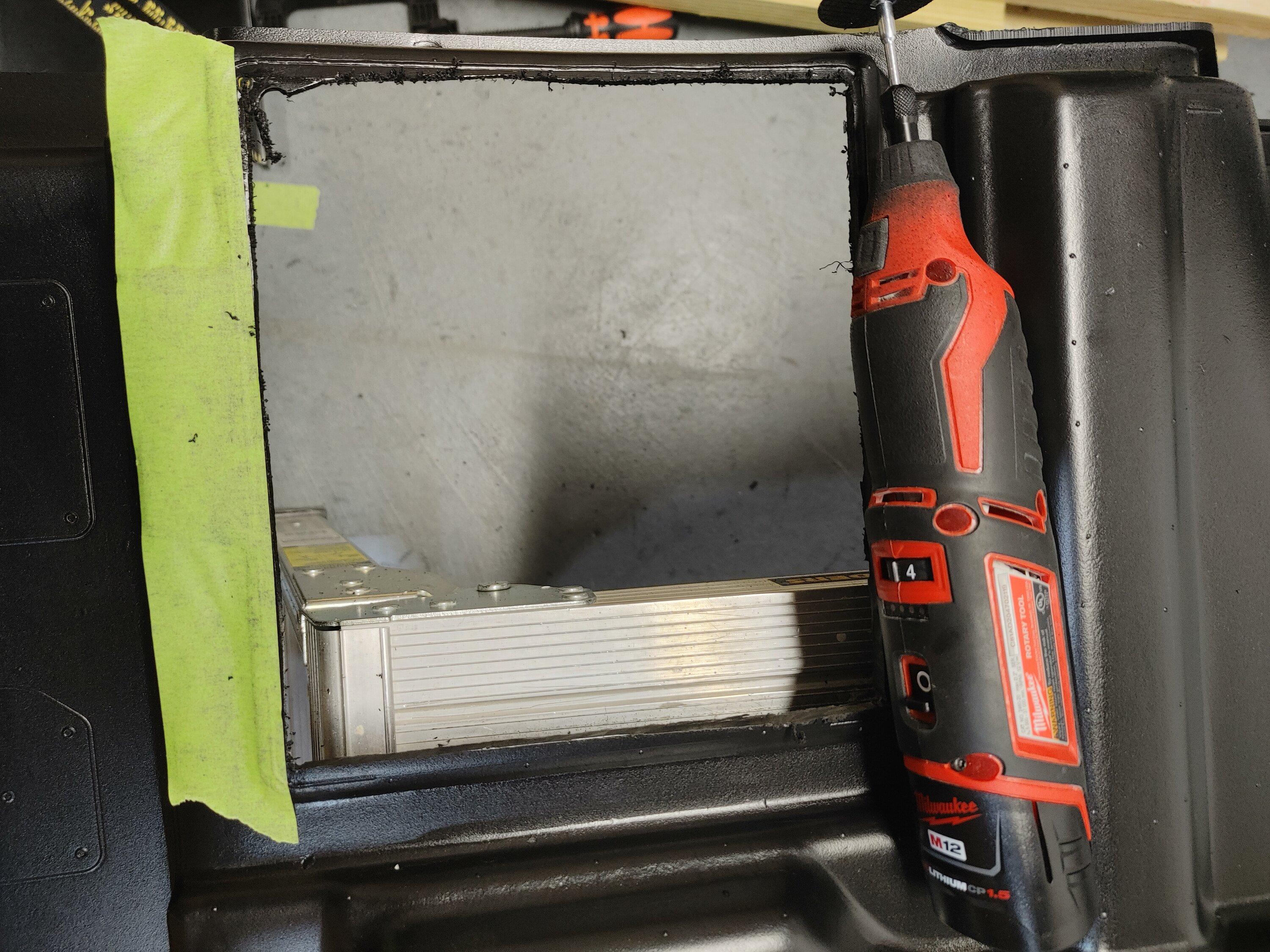

What I found worked well to cutout the passenger side bin and driver side power center on the rear sidewalls is a combination of a dril to start at the corners, a jigsaw with a thin metal (21 tooth count) blade and a rotary tool w a cut off wheel to clean up the cuts and finish where there is not enough space for the jigsaw base to pass.
I used a silver sharpie and ruler to mark the cut lines after I drilled the corners at the marks indicated on the panel.
I have a small Milwaukee M12 Tile saw w 3" blade. I thought it would be ideal as I freehand cut it, but the blade spins pretty fast and wasn't much easier to straight cut. A jigsaw at a slower speed was easier to straight cut -except you can only do 2 of the 4 sides since there is an elevated ridge obstructing the jigsaw base.
Once I did my rough cutout, I ran some green masking tape from one corner to the other which gave me a nice straight line and then cleaned up the rough jigsaw or cut off wheel cut. It's not perfect, but it does provide a smoother edge and if you take your time, it's pretty close to straight.
It wasn't a super complicated project, but you do need a few tools -especially if you have to cutout the side panels and some patience putting it all together. The sticker thing really threw me for a loop early on, but hopefully these details will help the next person out.
I am happy how it all turned out. I also installed a Truxedo Sentry CT cover - pretty impressed with the quality and that was super easy to install - probably 30 minutes.

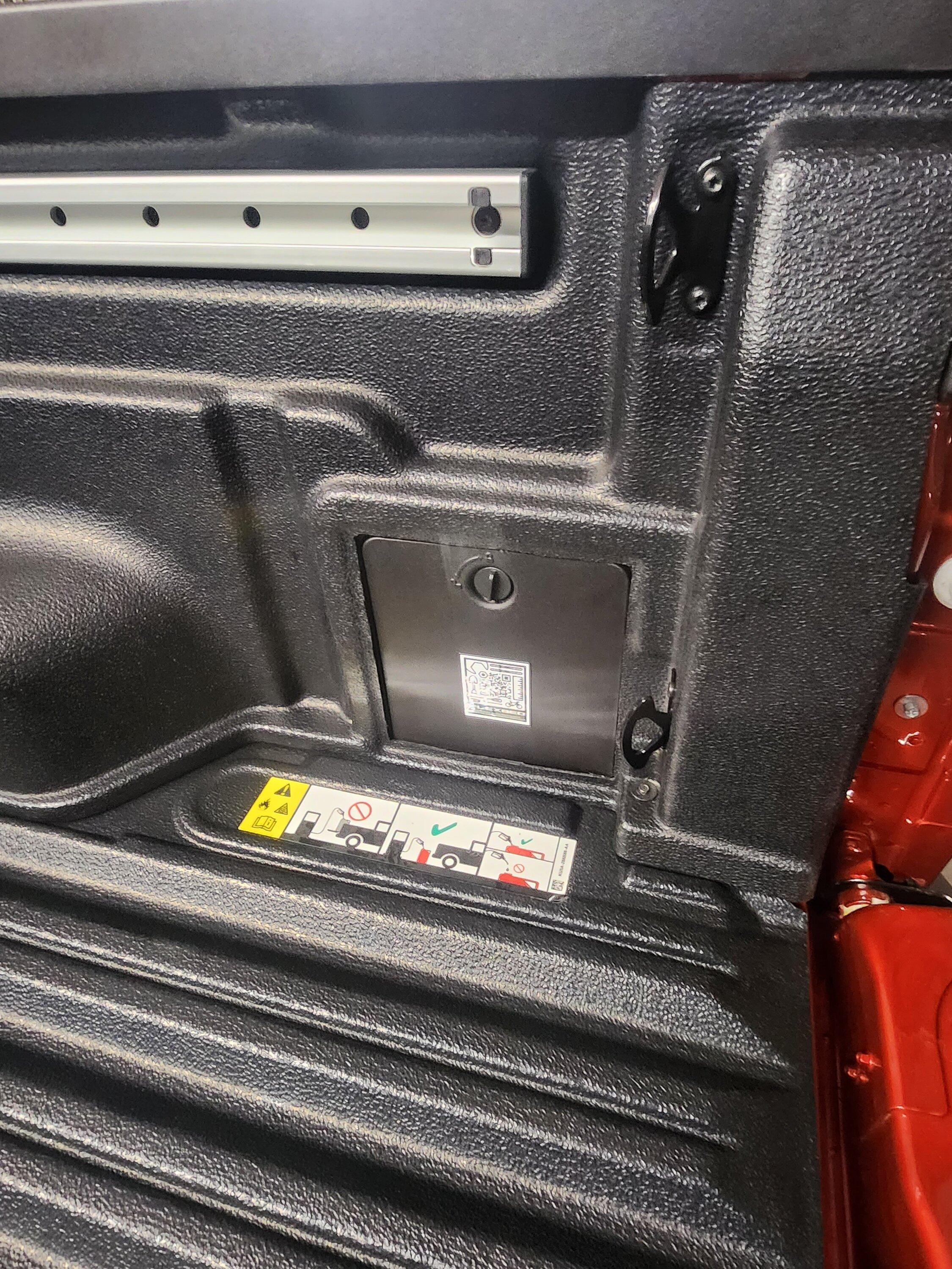

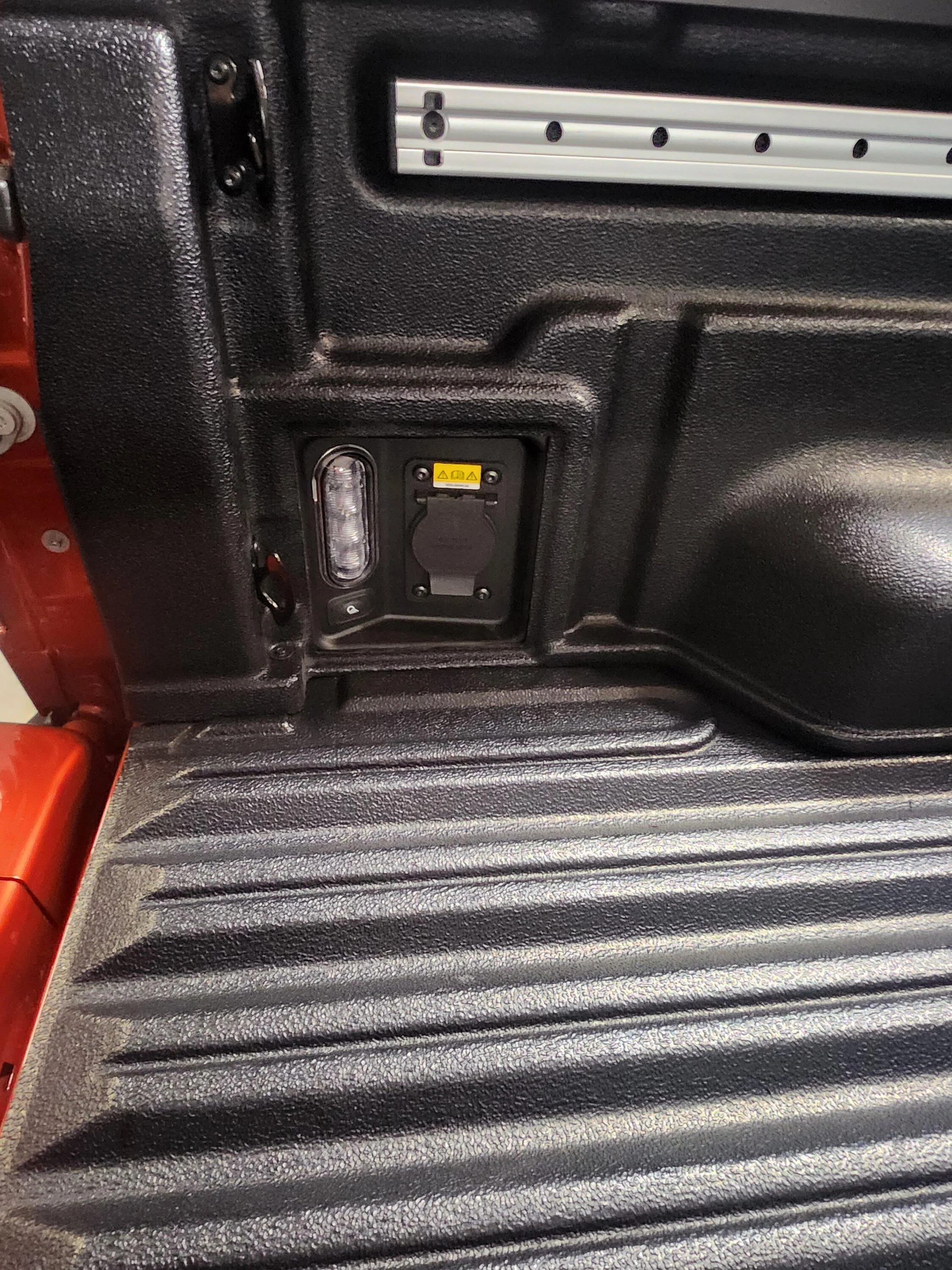

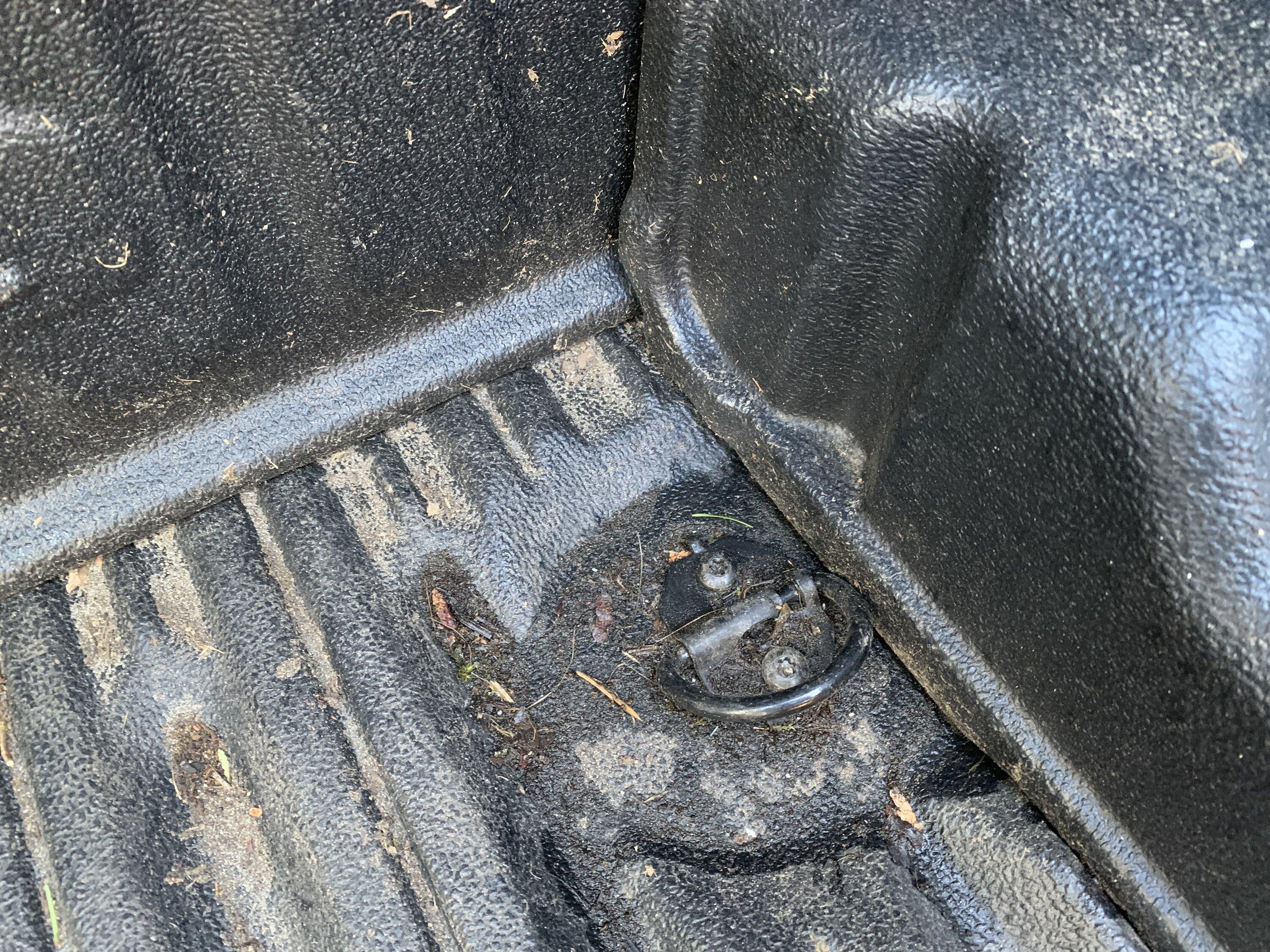

Just for reference, this is what it looks like from the factory.
Outstanding! Thanks for the follow-up icegradner. It's definitely a cleaner job than what can be done at home.
They must either have different stock for the XLT models with the cutouts already in place or maybe a jig +router to cleanly and quickly cut them out. I was looking at my small portable router as an option, but you'd need a bit extension and custom jig w platform to quickly zip those out. That would be the right tool with a jig to follow the cutout contour and get nicely rounded edges.
I see they trimmed right to the edges of the raised frame.
