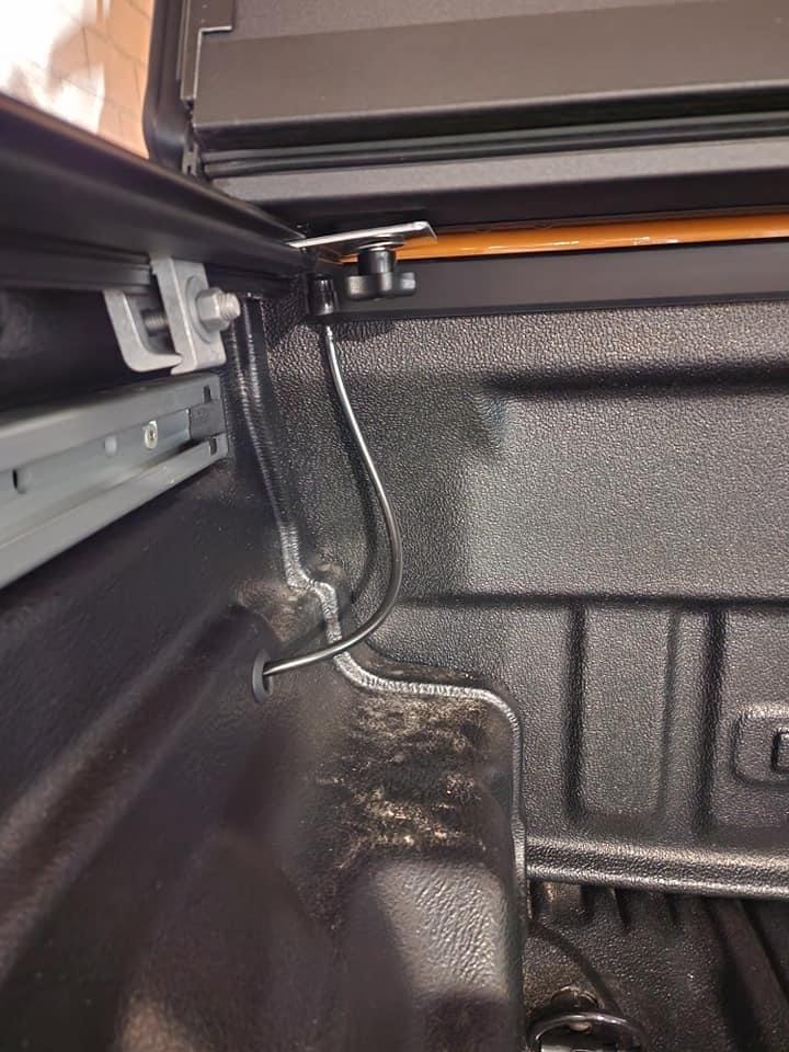

My Maverick came with the drop in Berliner, the drain holes are not cut out , would it be possible for someone to post pics with measurements so I can drill these out also for the pre made wiring ports on the tailgate side as I'm going to add bed lights ( Pic below for reference not my truck ) Thanks

The other option is to take the sides of the liner off and use the spots marked on the backside of the liner. I haven't bothered, hardly anything comes in those drain tubes. More comes in through the front and dip on each side than those drains.

Update the drain holes are covered and they are 7 inches from the wall. The plastic drop in panels come off easy and you can drill out the holes, another tip if you are going to put lights in the bed all the work can be done by removing the tail lights and taping into the existing light and switch or use the provided wiring harness. no need to remove any drop in bed liner parts
