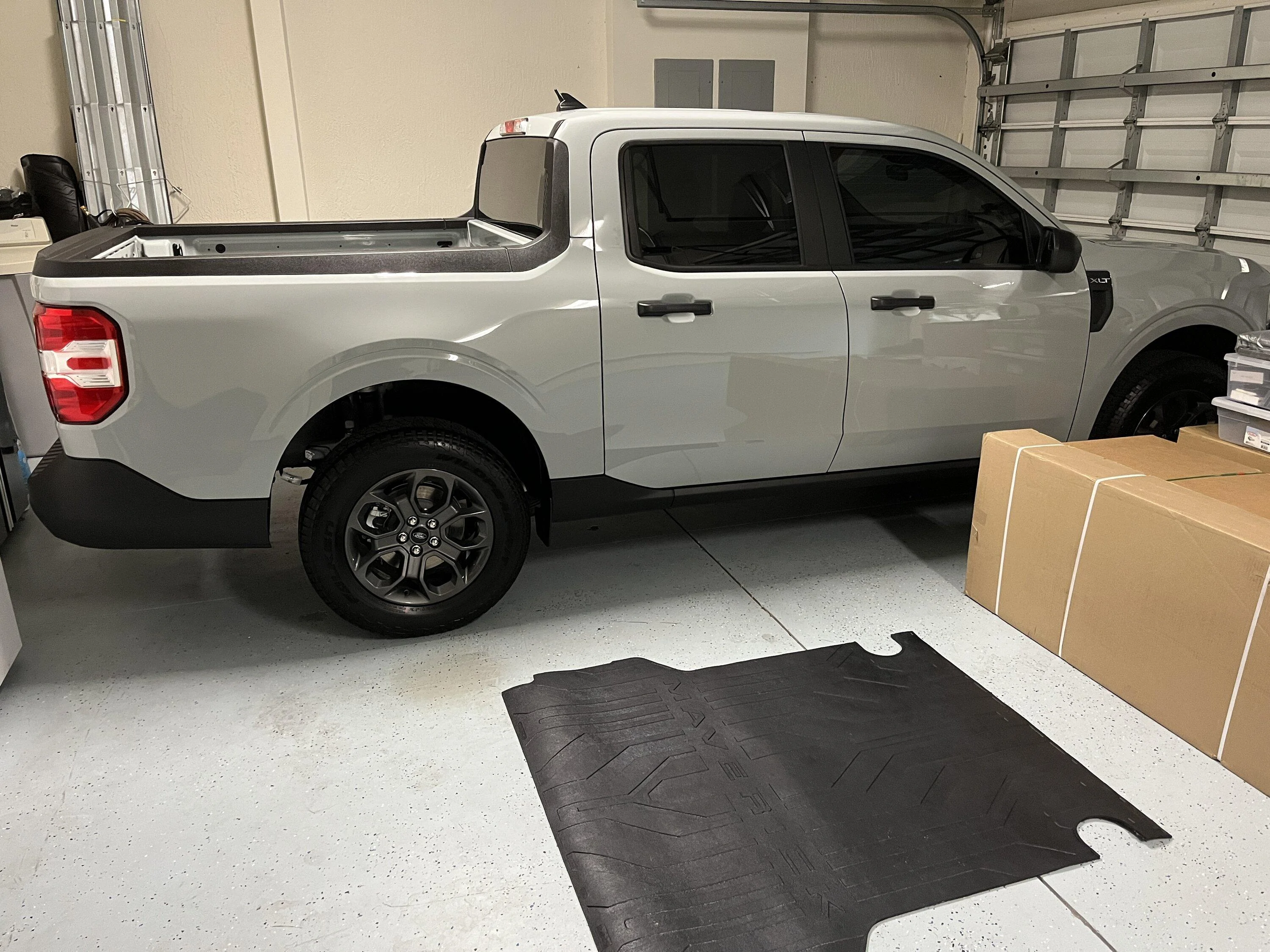

Question for anyone with these… about to throw it in and just want to make sure I cut the tie downs correctly… are they just pilot holes? Does the whole bracket need to be cut out to all ow it to lay flush?
anybody mind taking some clear pictures of the tie downs for me.
Thank you much!!
