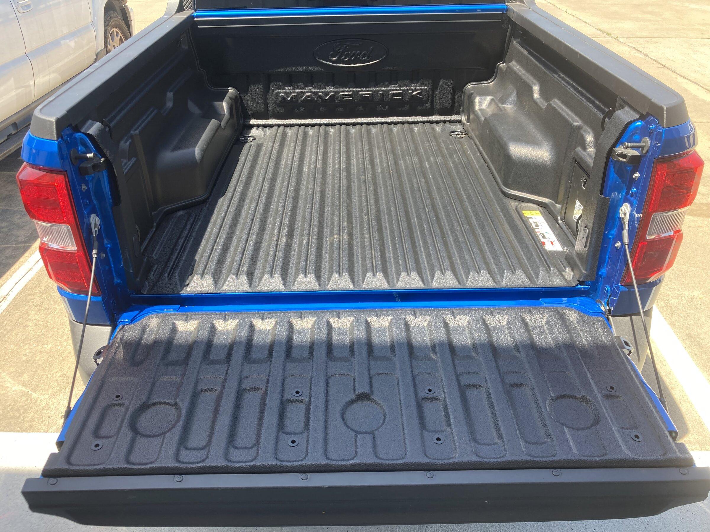

Looks nice! I'm not a fan of them mainly because of the possibility of water getting trapped between the liner and the bed itself. I prefer
Ford Maverick Drop in bed liner installed better than expected! 20220410_124527
spray-on bed liners myself for that reason.

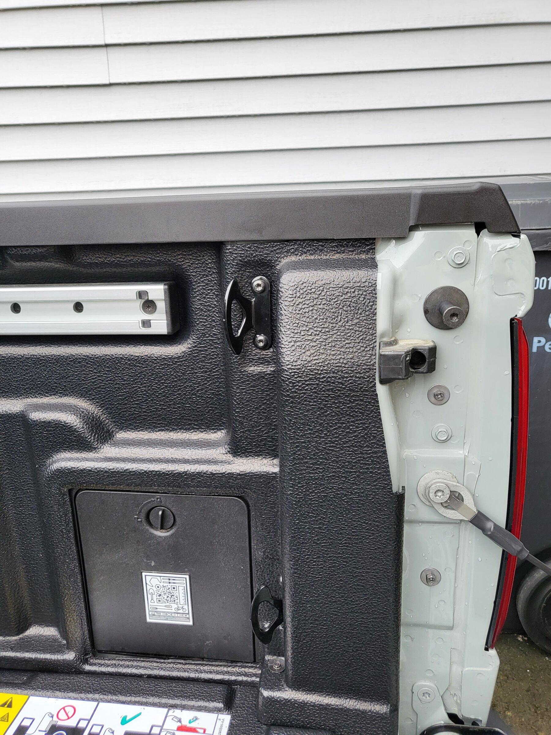

They actually have drainage holes in the bed. On all my previous f150s I would have to make my own but I'm impressed with the drop in liner. Took me 1 hour to install at home.

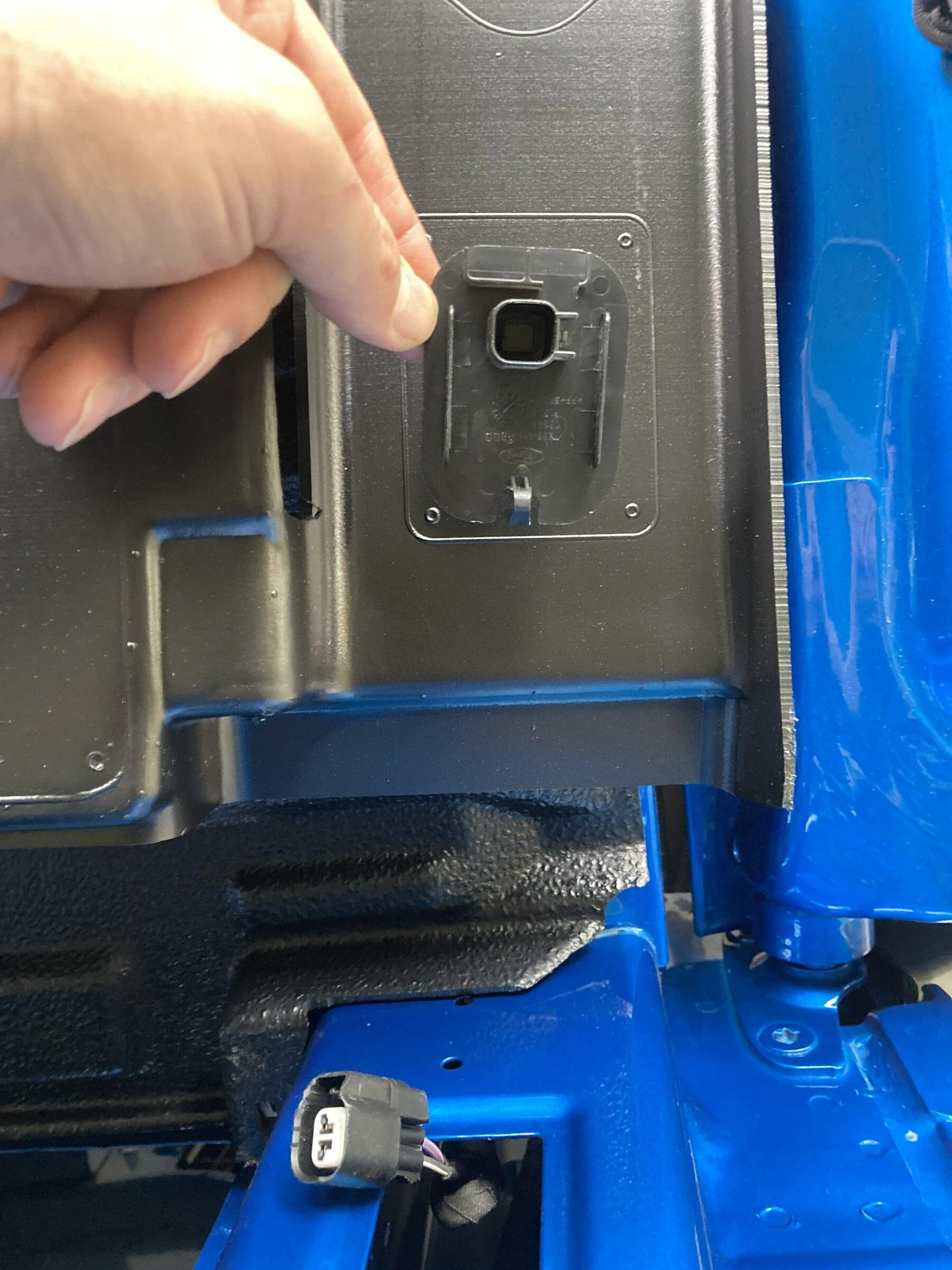

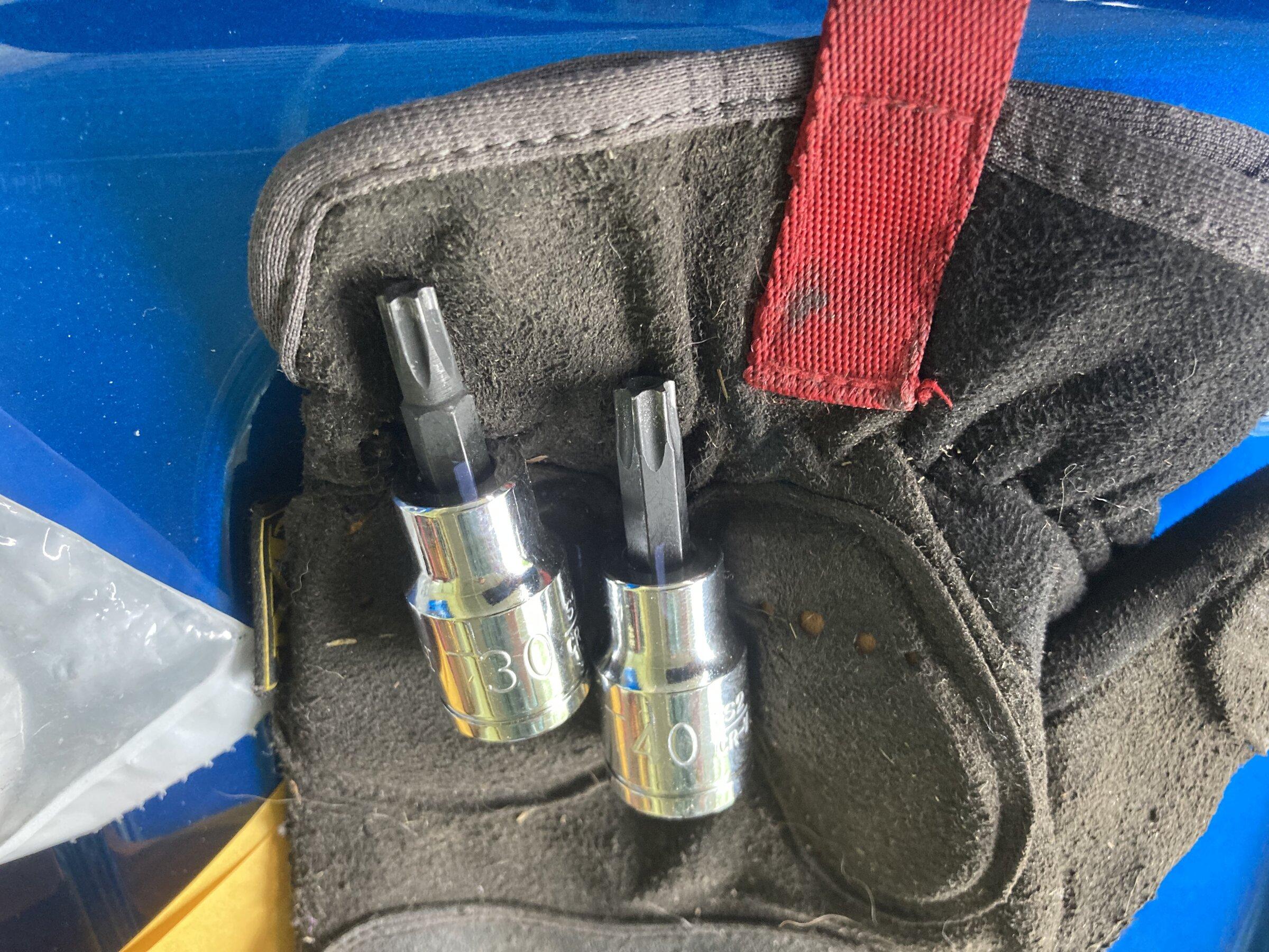

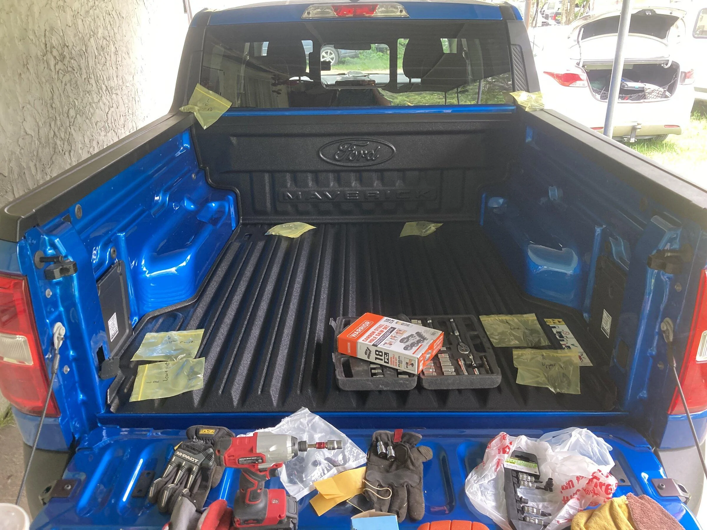

As someone who's installed this, I can now say this does not qualify as a "DROP IN" Bed Liner.
Opportunities for improvement:
1) Include factory dots for bolt hole locations for all fasteners on the exposed side of the installed bed (instead of inside)
2) make the pocket covers installed over the bedliner, not under

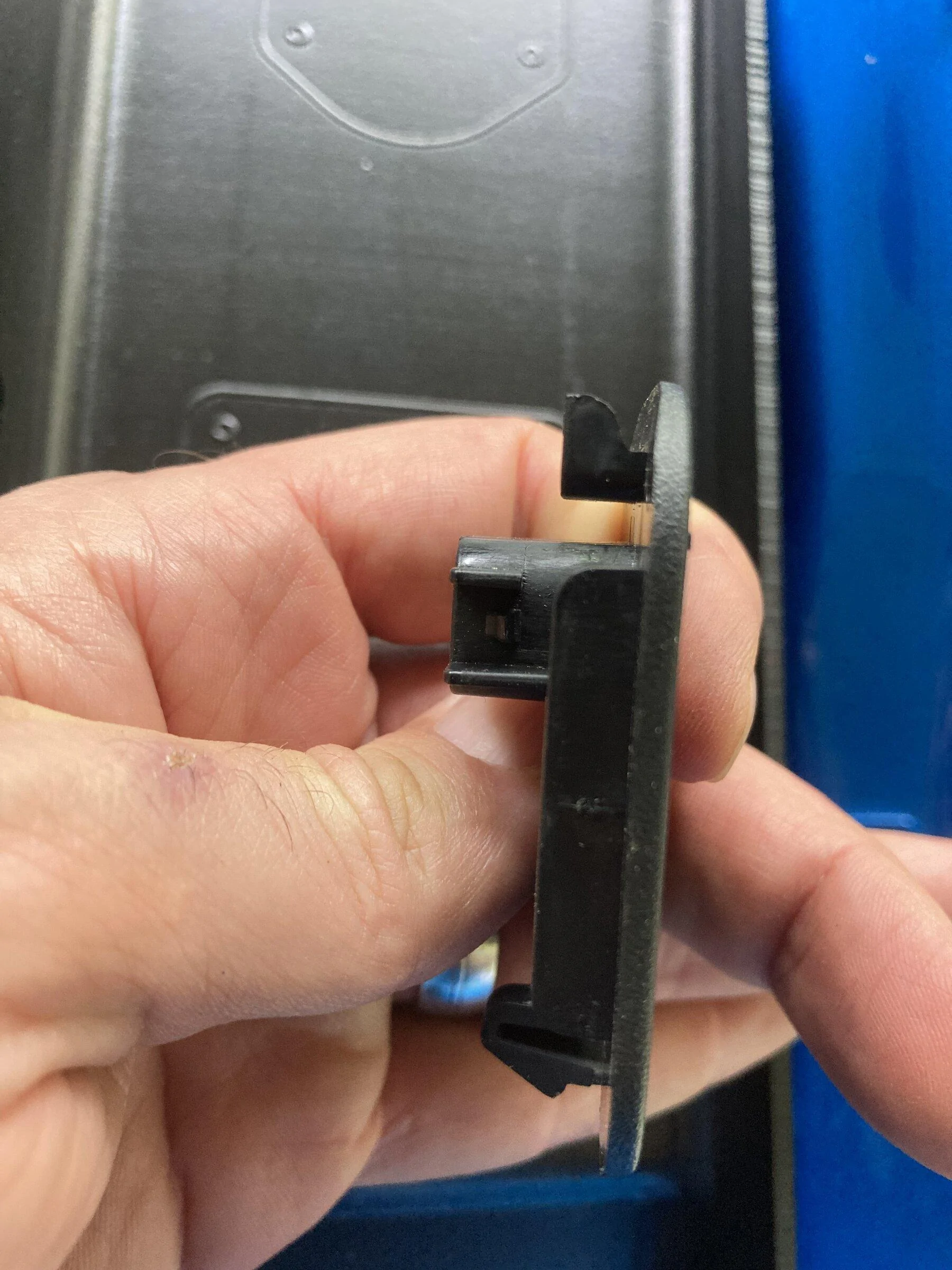

3) precut or pre-mark the holes the 12V cover plate snaps into so the cover snaps onto the bedliner instead of revealing it through an oversized hole in the liner.
Not liking the sides of this DIBL yet. Trying to install and being asked to cut 1-1/4" diam holes to run like 1/4" diam bolts through them. I see them as huge entry points for dust and water. Now that it's all installed there's big gaps at the aft end of the sidewalls. There's some other device that bolts to this surface with three bolts (bed extender I think) that would sandwich the liner against the body here if I had it.
I see debris getting in these holes as the #1 failure point of the coating under the DIBL and #1 cause of future rust.
The directions Ford posted on Youtube include the cargo management system, which I don't have, so the drill out locations along that rail are wrong. They don't include one of my cargo tie downs. Ford was nice enough to mark the location of the holes to be drilled on the liner. Unfortunately, they're on the underside. Meaning, if you want to add the cargo management system LATER (or DIY system using those mounting holes), you have to drill them now before installing the liner; or try to uninstall the bedrails in the future (not sure how hard that is yet).
12V power plate cover, they recommend cutting a hole out of the liner so big the paint will be exposed around it's perimeter (probably so you can grab it and putt it through easily. Instead I'm going to cut a 2"x1-3/8" hole and try to snap the 12V cover into the bedliner, making the penetration dust proof.
All the work they did to make the bed cool, the pocket storage, the 12V power, etc. is all getting covered up and made inaccessible or less accessible and less modifiable thanks to the short comings of the DIBL.
Also, if you were wondering, the side pocket storage insert assembly, can be installed on either side. If you didn't get both sides from the factory like me, you could order a duplicate from Ford, or wait for aftermarket improved versions, or pull from a future wrecked Maverick.

You don’t have to drill the 1.25 holes I just drill a hole big enough to tread in an eye bolt

What became apparent about my undersized holes, was the spacing washer installed under the tie off points. When I tightened down and sandwiched the liner between the body and washers, it's rotomolded plastic properties became apparent. It squished down like foam in a way that probably isn't good for it. But I do feel it's more weather tight.
I was tempted to leave the washers out completely, but they designed the washers so the liner wouldn't get squished. Hope this didn't compromise it somehow.

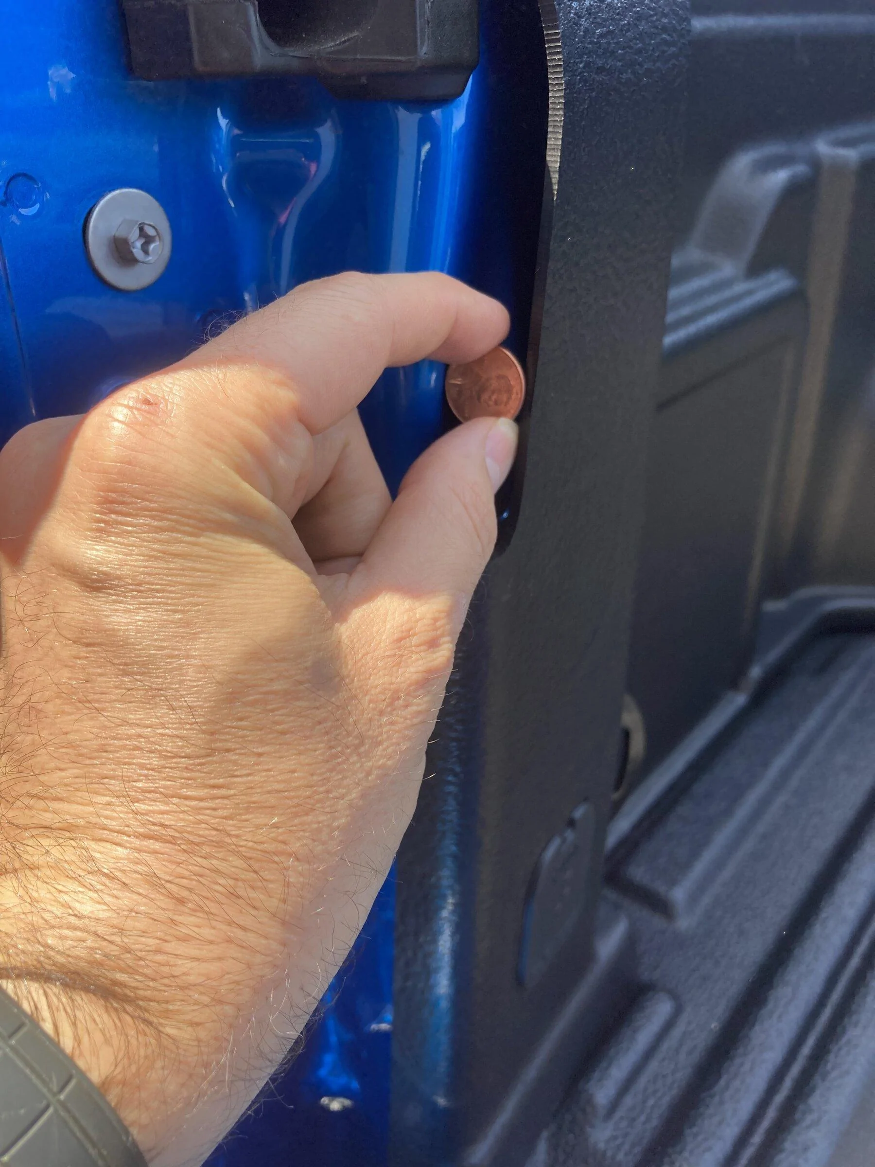

If you look at the pic with the penny you dint get the bed liner under the molding that’s why there’s a gap
