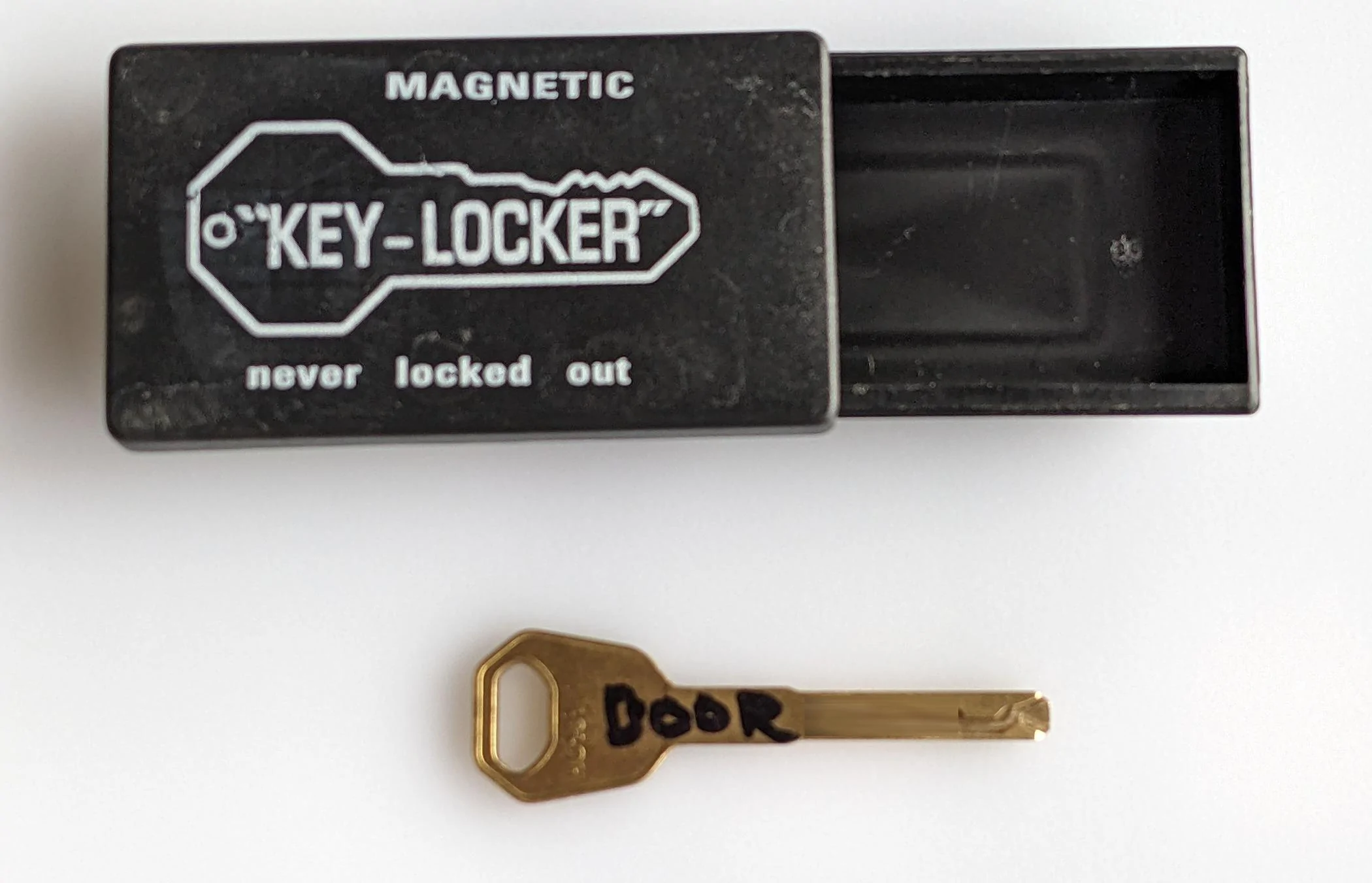

...car thieves who somehow find my door key will just sit there trying to start the truck over and over with the door key, even though it is a "dumb" key and not coded to disable the engine immobilizer. It technically could be coded to my Maverick, but it isn't, so there is no way to identify that it isn't coded other than the fact that it won't start the engine.
I hid a "test" key in a magnetic spare key box. Chip-less Test keys are available from some locksmiths for almost nothing. It will open the door & tailgate, but won't start the truck.
