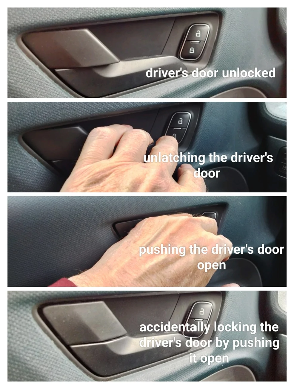

And sometimes when you get out, your index finger hits the little lock button and all the doors lock. After I determined I was the locking problem, I trained myself not to lock the door(s) when exiting. You can teach an old dog a new trick. It only takes one psychatrist to change a light bulb, but the light bulb has to really want to change.
