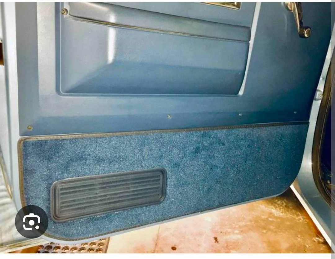

I remember when cars and trucks, had carpet on their door cards.

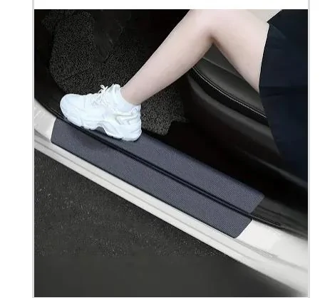

Ford Maverick Door kick panel protection Screenshot_2024-06-17-16-22-49-32_40deb401b9ffe8e1df2f1cc5ba480b12
Seems that the interior sill (right where her foot is) is what gets scuffed up the most.
Good luck

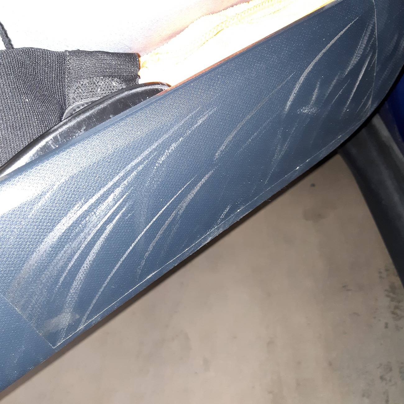

I use a sheet of clear PPF (paint protection film)
If you have a vinyl wrap installer around where you live. You maybe able to get some scrap ppf and cut your own?
Remember to prepare the surface otherwise it will not stick. If you've used any spray vinyl protector on the kick panel the PPF will not stick.
PPF prior to wipe down 👇
Ford Maverick Door kick panel protection 20250414_100918

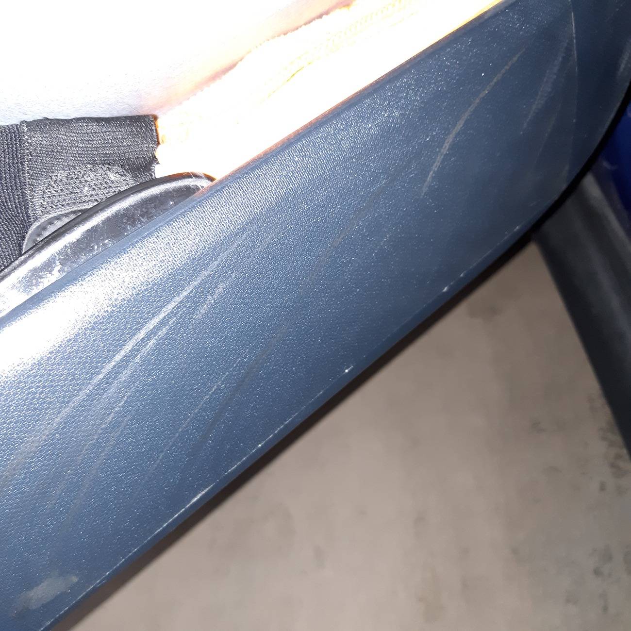

PPF after wipe down 👇
Ford Maverick Door kick panel protection 20250414_100933
One of these days I'll cut a new piece and change it out.
