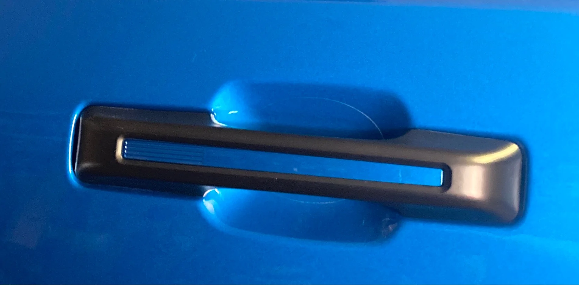

I got over lays on Amazon prepped with plastic adherence first then primed then color followed by 2k gloss.
Umm dumb question but how do you match the color and where do you get the exact color from?
I went to NAPA paint center where they mix the color by the code of your Maverick. Then they put in a spray can for you. I also got the 2K clear.

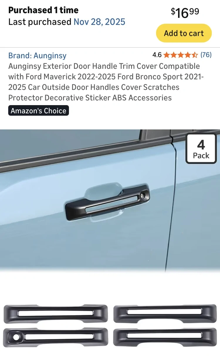

These are the covers fyi….
Ford Maverick My painted door handles IMG_1143

I have been debating on these. I have the Shadow Black, but I don't like the matte black handle. The piano black might look better.
