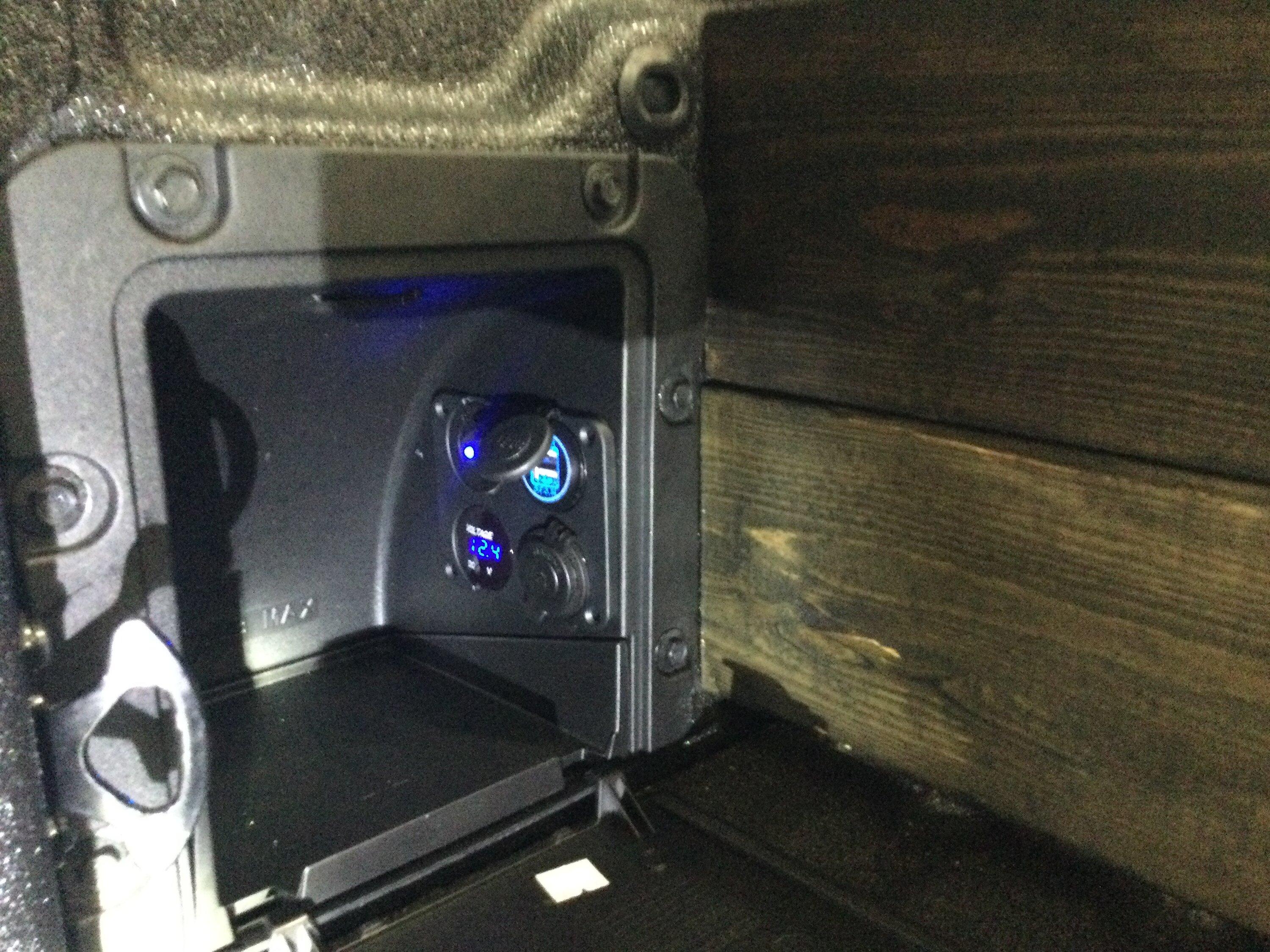

Great minds think alike! I did the same thing and it was a real pain getting those cigarette plugs to slip behind the metal bed, but it’s worth it!
The trick is to get plugs that have screws on the face so you can install it with the cubbie in place.

One thing about the setup is that some forum posts on here reported the flexbed stays on for 90 minutes then shuts off, but it in fact turns off as soon as the truck key is turned off of acc mode.
I have a bunch of dewalt 20v batteries that i'm going to get an adapter for so when im just tooling around in the back and dont mind leaving the keys in its hooked to the flexbed system then for camping and such I can deplete my 20v batteries to run my truck cap lights and have no worries about any car battery depletion.
Also! I thought of this the other day, a perfect housing for an inverter near the back would be in the panel on the tail gate (depending on the size of the inverter).

I have the hybrid. I installed the inverter behind the back seat and connected it directly to the battery. I wired an outlet in the passenger side cubbie. (post #24)

I think I may do an inverter in the end, one that has a low voltage shutoff. I don't plan to use a big inverter or a lot of power but its nice to have peace of mind with the auto shutoff.
What inverter did you go with?
TheWizziard
Jul 14, 2022
1,051
1,117
Texas-RGV
2023 Maverick XLT Oxford White
Renogy 1000w Pure Sine Wave
I liked the hard wire output and the remote control input.
I plan to connect the remote input to a relay operated off an "ACC" on fuse or the "start" circuit if I can find a connection to the start circuit.
By connecting the remote "ON" to the start circuit my inverter should operate until I run out of gasoline.

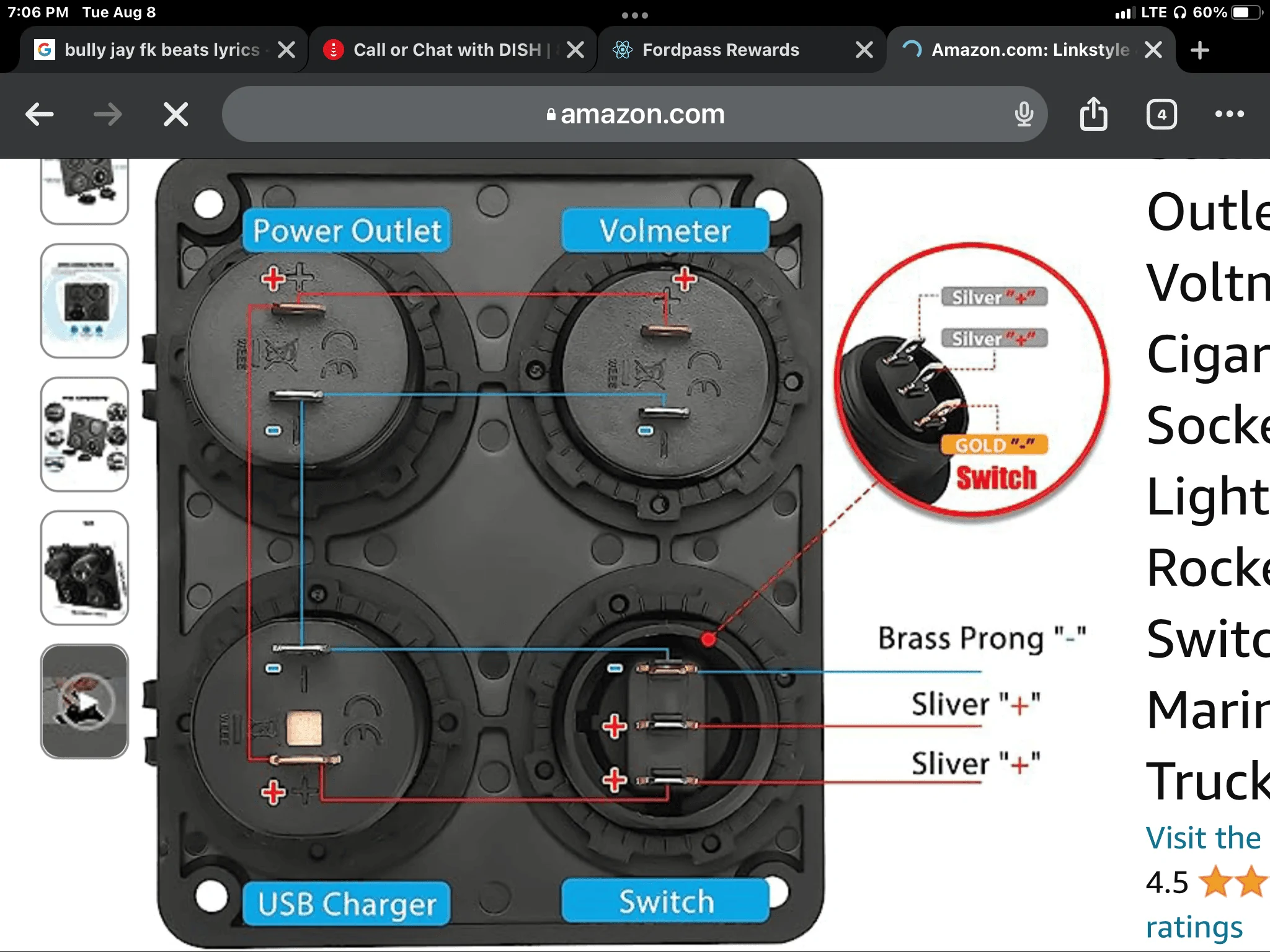

I just mounted mine on the access panel on the driver's side but I haven't wired it yet. Dumb question: which of the wires is pos/neg? Assuming the black is negative but I don't want to assume.
