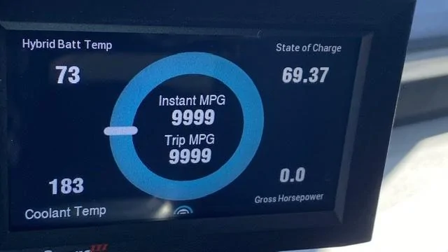

You can buy one that does a hundred things if you are into that, or you can buy a wireless bluetooth OBDII interface to read the information on your phone.
Either case, you need to buy something that plugs into the OBDII port.
Ones with a screen cost more, but you plug it in and it works. Ones where you bring your own phone cost less because you bring your own screen, but you need a bit more technical expertise to get it all connected.
Small company.
Nice people.
Very helpful. Great customer service here:
www.scangauge.com
example in a Maverick:
Ford Maverick Does the hybrid battery hold charge after I shut off the engine? 64E9983D-5ACC-477C-AAA7-D7B573E94013
