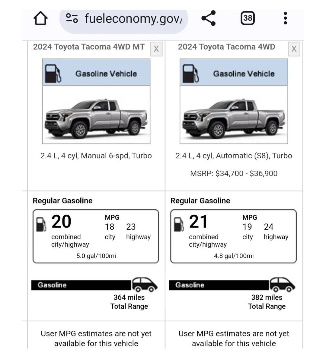

I was surprised to read that Europe a long bastion of manual transmissions. Now sells more automatic transmissions than manuals.
Europe is experiencing a significant increase in the adoption of automatic transmissions, with estimates in 2020 suggesting a market penetration of around 75%. This shift is driven by factors such as consumer demand for comfort and convenience, particularly in urban environments; advancements in automatic transmission technology leading to better efficiency; and the growing popularity of hybrid and electric vehicles, which are often equipped with automatics.
Since Model Year 2016:
The U.S. Environmental Protection Agency (EPA) reported that automatic transmissions began providing better average fuel economy than manual transmissions starting with vehicles from the 2016 model year.
