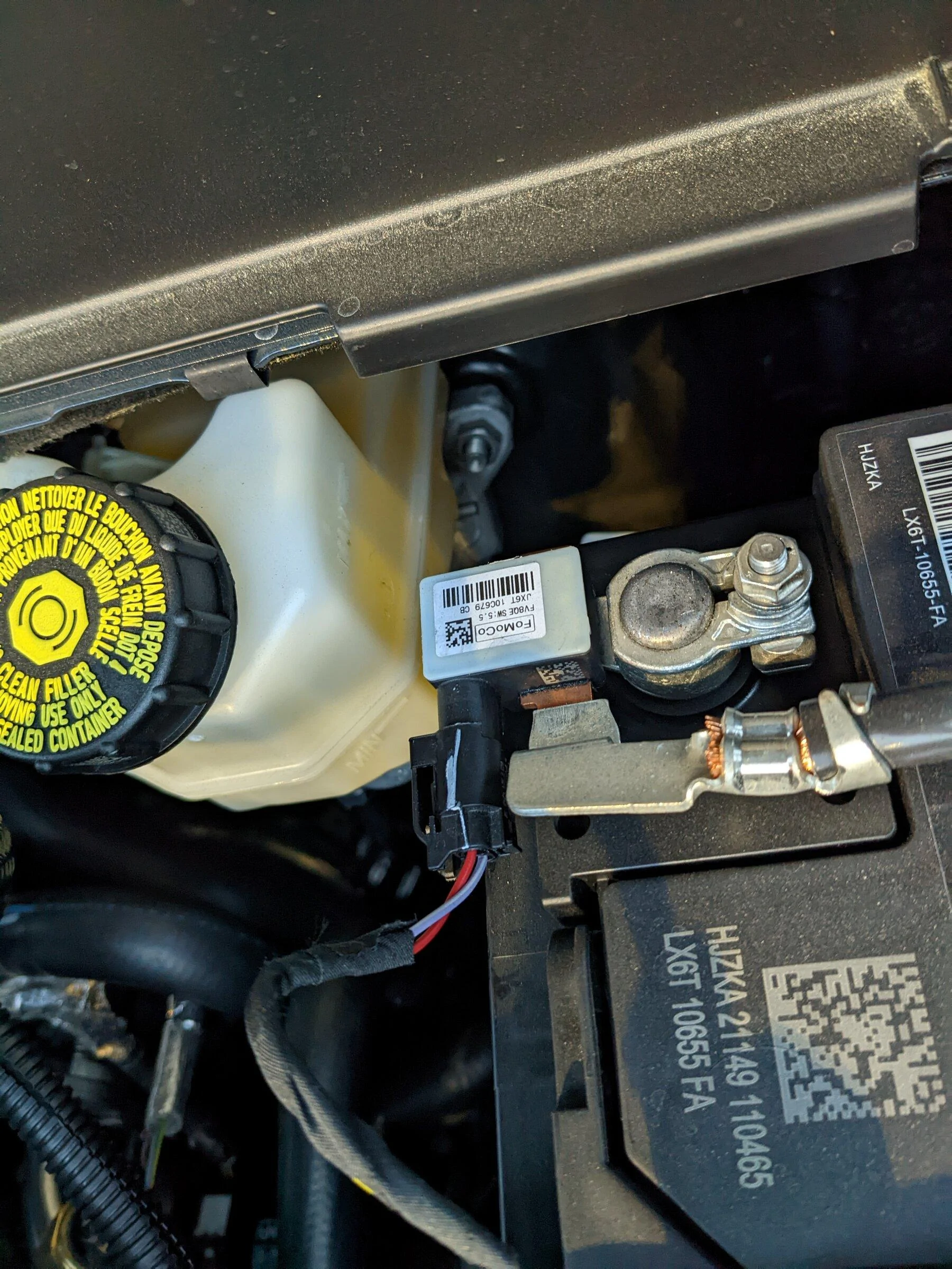

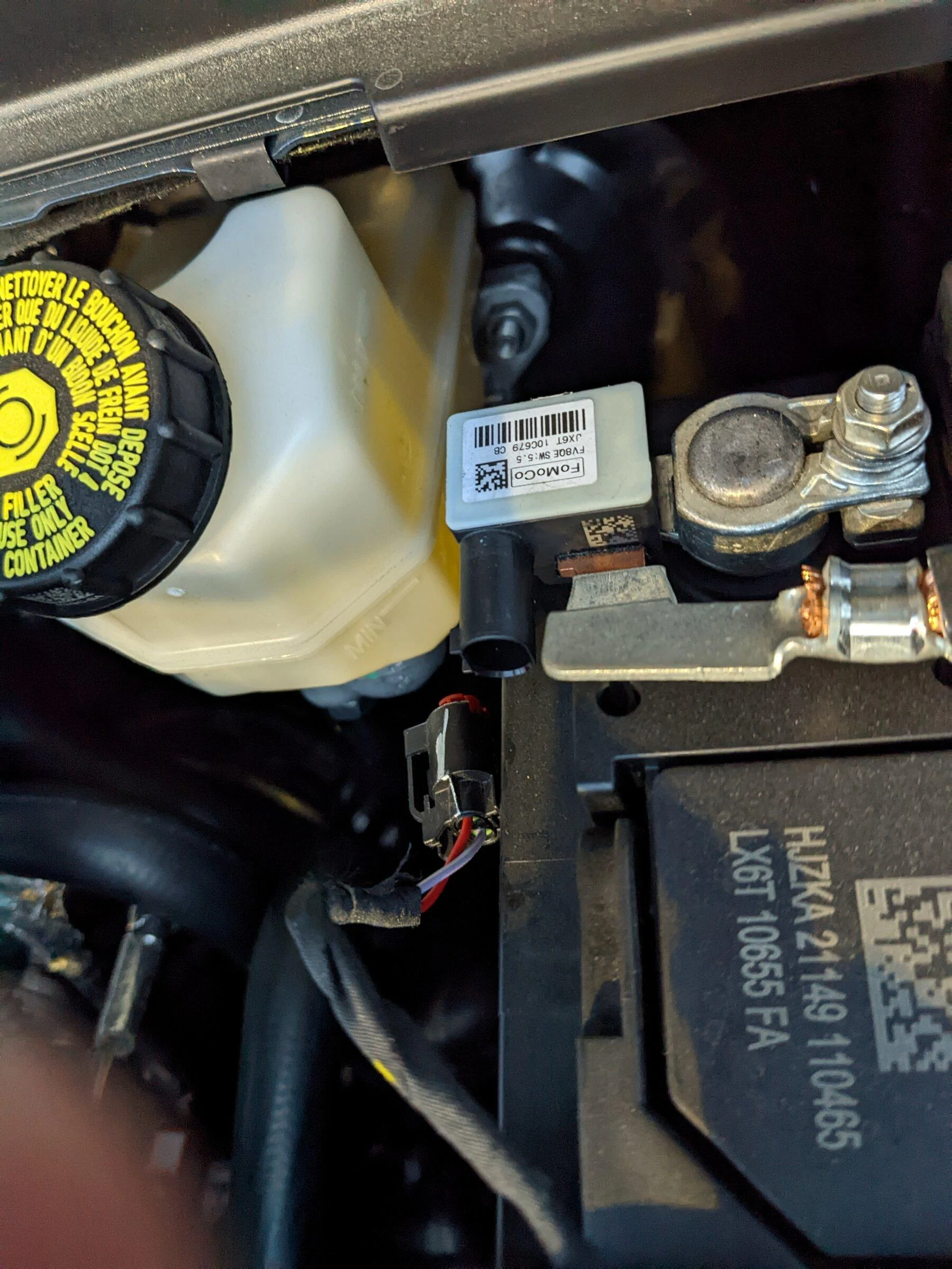

I pulled the plug off of one of the posts on my battery, like the guy does in this video. I get a warning when I start up, but my auto start/stop is deactivated.

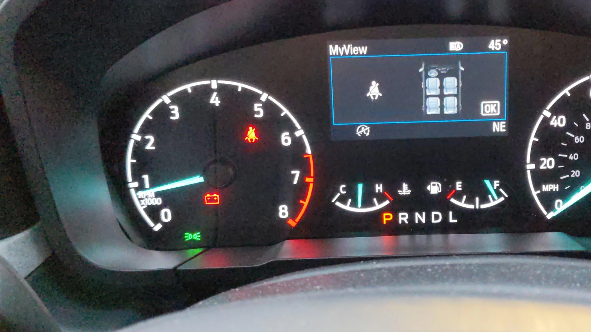

I got the same error.. maybe they changed something in the program. I will probably need to use a scanner to change the code.. or just keep hitting the button. Lol.

Yup. I just press Ok at the error and drive on. No side-effects that I can see, and I'm happier. I have "engine dying PTSD". Way back in the day, the engine dying at a stop light meant I could absolutely not get it started again - unquestionably a disaster, always had to push it to the side of the road. I can't shake it even though it was decades ago. I had some really terrible cars, and they scarred me for life.

Not really if you watch the video the just unhooks the plug and like magic start/stop is disabled! No need to spend 100 bucks from autostop eliminator 🤗

Just watch the posted video shows the pulling a plug off the negative battery side and like magic no more auto start/stop

I got a battery error pop up on the screen when I removed the plug... I plugged it back in and error went away. I am just going to make it a habit of reaching and pressing the button when I get in the car.

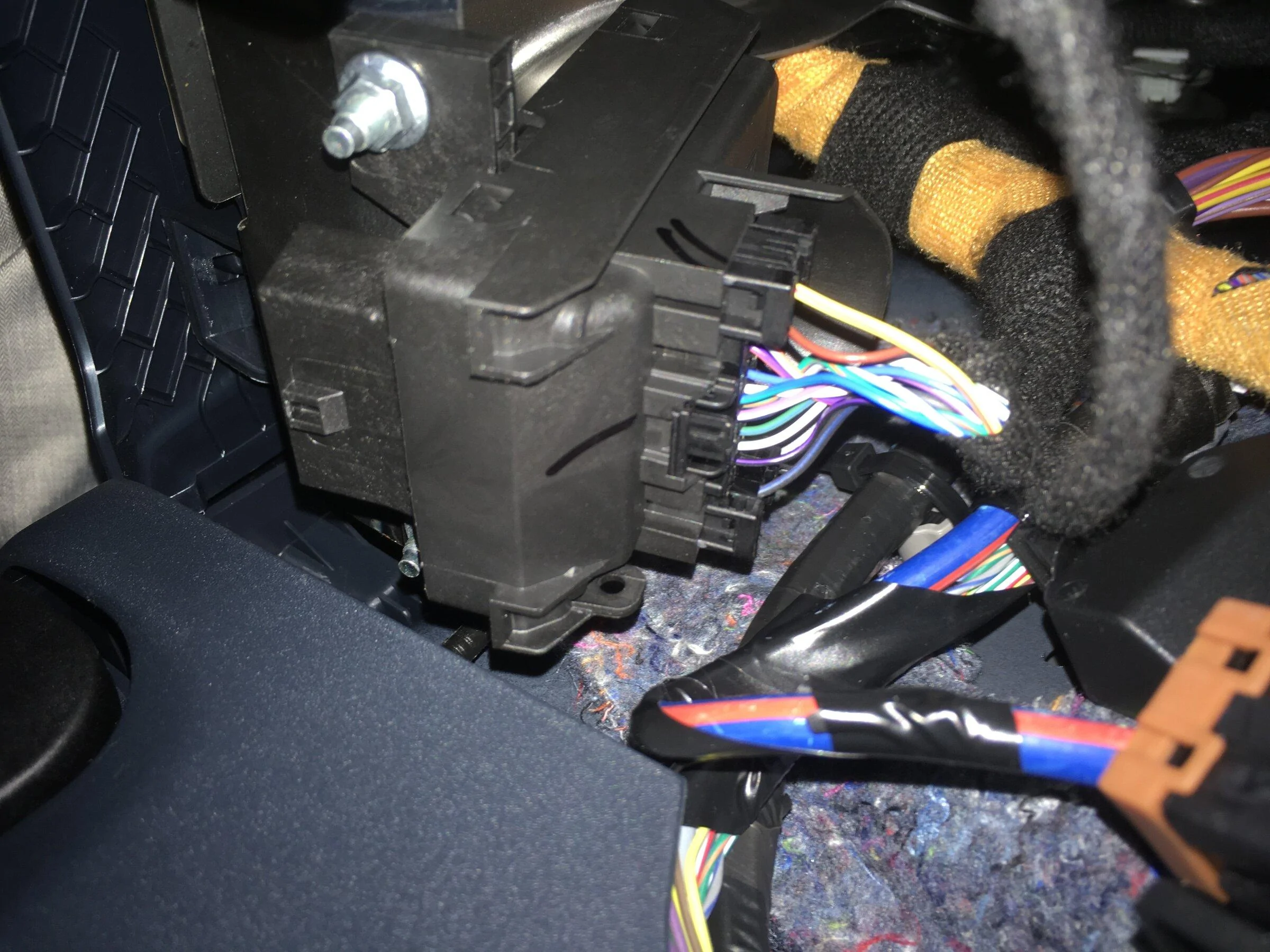

UPDATE - the whole thing unplugs - all the wires you see are connected and it all comes out - see second photo. The release is right in the middle, small little latch you push in to release. Had to wiggle a put to get it to come out and used a small screwdriver head in the two inserts on the edges to get it started.
Now to do my install.
