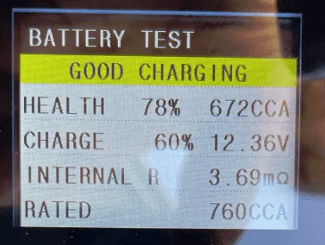

I have this Maverick for nine month now, the age of the battery is not unknown, at least to me. This is the current battery test results:
Ford Maverick Does Maverick have auto start stop? Disable possible? 1698852322719

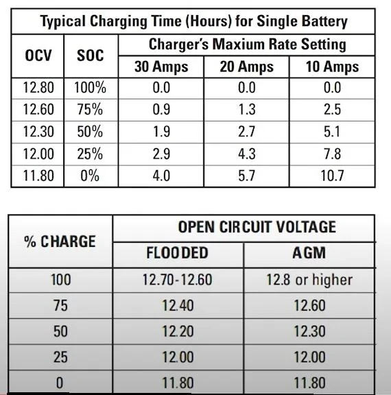

That's not an optimal battery condition, to say the least, with winter around the corner. Especially the charge level of 60%:
Ford Maverick Does Maverick have auto start stop? Disable possible? AGM battery
Yes, I can recharge the battery and already done it once, but how many times will I need to recharge it, especially in the winter? On the plus side, I don't need to worry about disabling auto start/stop, the system does it for me.
In the winter, when the truck isn't used that much, this will be even worse. My Toyota Avalon, that's driven even less, with its flooded battery and 100A alternator does not have this issue. Every 4-5 year I get a new battery and there's no issues.
Something doesn't add up here, maybe it's the battery or the alternator that having issues, The OCV check is a pretty good indication of the battery state, but it cannot pinpoint the source of the issue. I understand that driving for short distances most of the times may contribute to this. (Grudgingly recall my F150 under the same circumstances/driving distances, it never had issues with the battery.)
Anyone has a suggestion for addressing this?
Thx...
