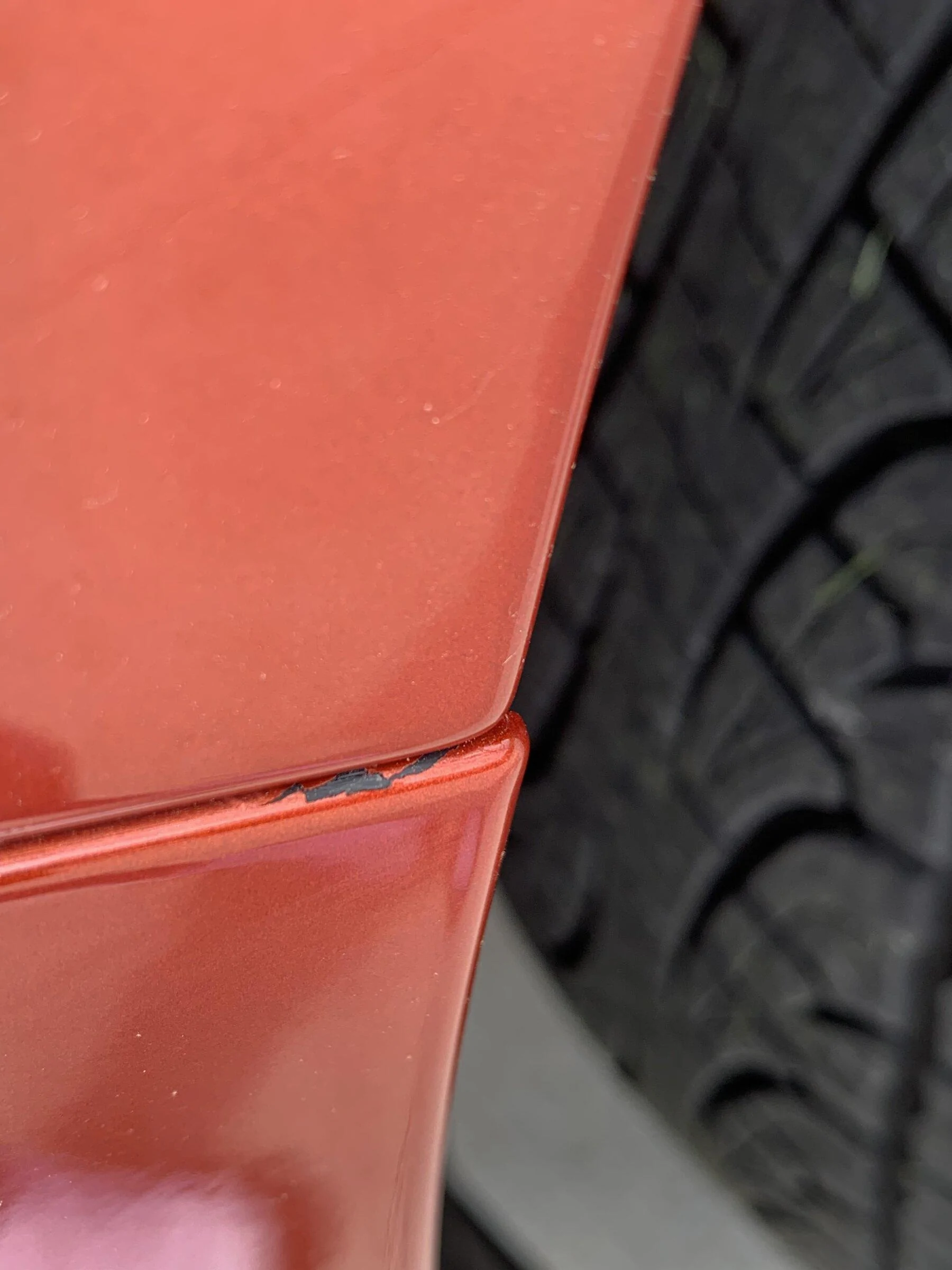

The "weld" under the rear window is not a weld. We've determined it's a bit of excess seam sealer that bled out before paint. The outgassing of the curing sealer can cause the paint to bubble.

Additionally, I have been putting off the pinch welds but went Saturday although they were closed (google said they were open but oh well). Not only are the pinch welds still rusty, I have now found paint coming off on the front bumper. While all car paints are soft and some chips are expected, this is clearly bad paint prep and paint work. It’s bubbling and coming off where the bumper meets the fender, clear away from where anything could hit it and cause this. So I will have this addressed with the welds.
