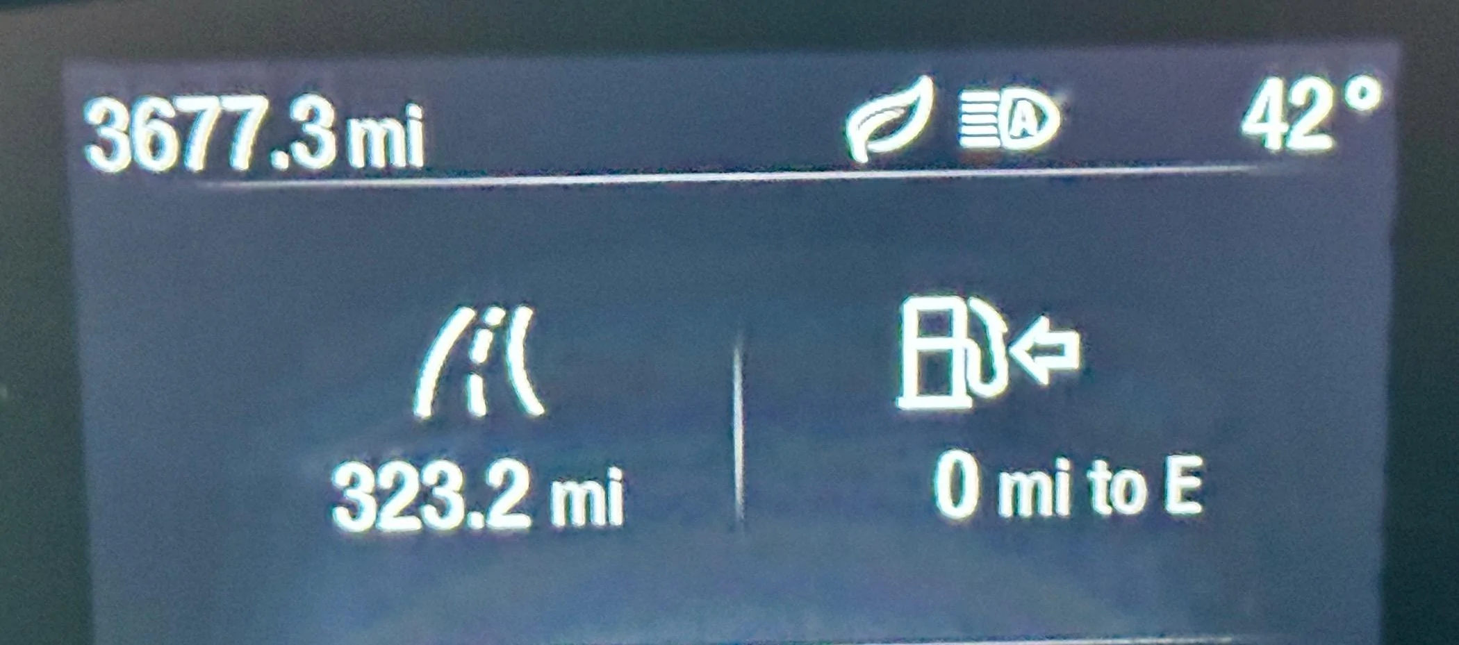

So I saw this thread and decided I’d give it a shot yesterday knowing that my miles to destination were more than what my MTE stated. I posted a couple photos of my guages when the truck indicated 0 miles to empty and again when my car reached home.
I drove 31.6 miles after truck read empty so, assuming approx two gallons of remaining fuel I should’ve had a little more than 1 gallon of gas remaining. I filled up today and the pump stopped at 15.127 gallons. I believe the stated capacity of the tank is 15.9 gallons with usable capacity of 13.9 gallons.
I averaged 38mpg for those last 31 miles. The computer came within a few tenths of being spot on with what I’d expect. Based on all these numbers I wouldn’t have made it much past 50 miles after empty warning. Now if my miles weren’t all highway for the 30 mile drive the way they were, I could easily have gone 60+ miles.
