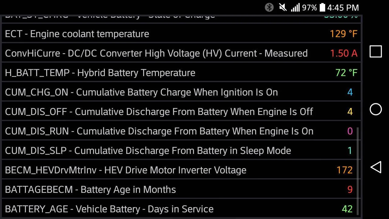

Battery Saver are the lights, possibly passenger side keyless-entry sensor, power ports, ect - shutting off earlier and earlier.
Seems to be strictly low Volts to get it. Usually observable before Deep Sleep notice.
Deep Sleep is the modem being disabled - hence Fordpass app informing you remote features will be unavailable.
Volts <9.5, unstarted for 14 days, battery SOC <50% (though it seems recent BCM update may have changed that one).
So you see why you got yours.
Reset is for when you get a new battery according to manual - it resets the days in use and age of battery, and cumulative charge & discharge logging.
Which the charging scheme, as bad as it it - uses to vary things.
The locked overnight for BMS Relearn as manual says is needed after a charge up (and new battery obviously).
