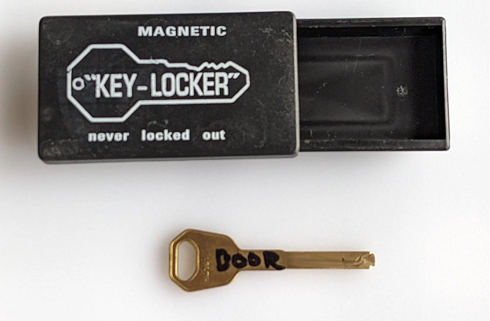

Some locksmiths will cut you a metal "door key." They're also handy, in case you or your truck locks your fob key in the truck.
Good idea.
Remember when using a manual key to unlock the Maverick. You've got 12 seconds before the alarm sounds.
