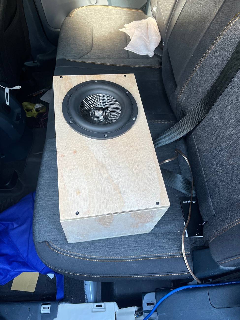

here’s what the sub looks like it’s rough right now the box isn’t totally done just put it in to see if everything would work and it didn’t so once it works I’ll finish the box to my liking lol
