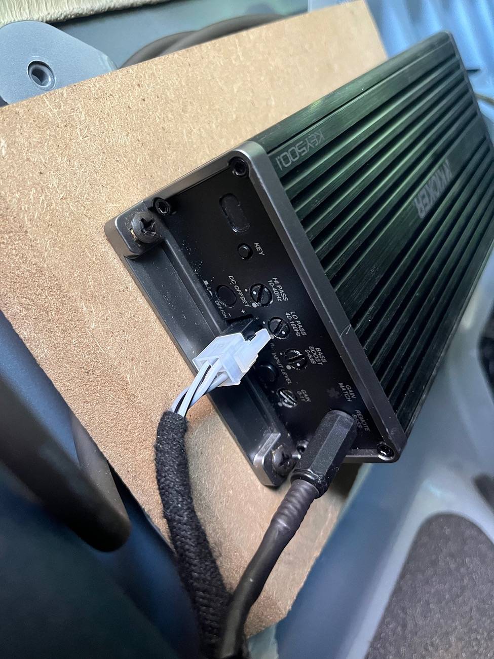

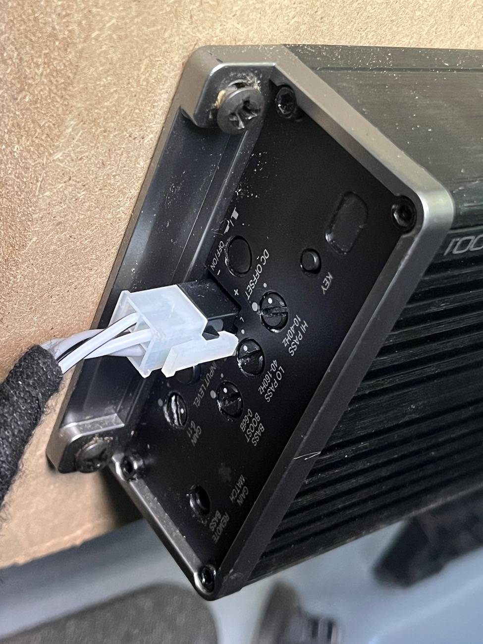

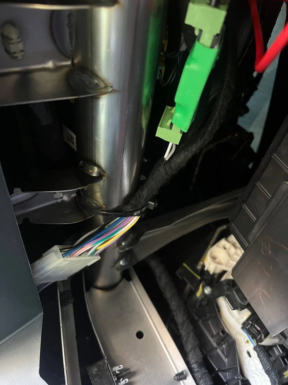

Here’s pics I’m gonna send some more soon. First pic is the settings back to “stock” and second is where it meets to the harness in the front.

I have to max everything out to get any noise-low noise. Shouldn’t I be able to just do the gain match setup and it work it Dosent even wanna do that. Do I have to mess with any of the the other settings before I gain match?

what is that second pic trying to show?
What is everything?
What is your low pass set when you are playing music? What is the gain set at? What is the bass boost set at? Do you have your bass knob plugged in and turned all the way up? Where is your ground? Where is your battery power connected to?

I have to put low pass almost all the way up to get noise. Then I have to max gain out as well. I have put the bass knob in and it Dosent do anything so I took it out but when I did have it in I put it all the way up for the gain match as the instructions say. I also need to have bass boost almost all the way up. I don’t think it should have to put everything up.
btw this is the harness I bought if that helps

so, now looking at pic #2 again, I believe you have spliced your power wire for the 500.1 into the harness. it cannot provide the necessary power to do that, in fact I'm rather surprised you haven't been blowing fuses trying.
look at the manual for the 500.1, it definitely shows a dedicated power wire straight to the battery and a minimum fuse or circuit breaker size.
use a distribution block and run the power wire into that, then unwind or cut the kicker power wire leads and go into the distribution block. (the 500.1 power wire is considerably larger gauge than the 200.4. I have installed both amps, I know.)

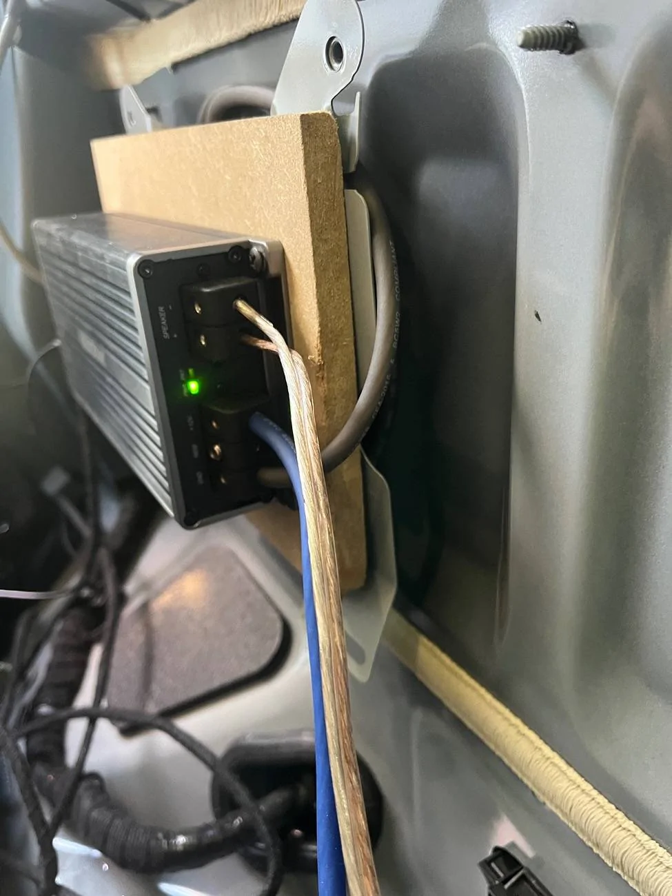

Here is my settings now with still super low bass
Ford Maverick Kicker Key 500.1 Not working IMG_7161
Remote knob is all the way up as well
Ford Maverick Kicker Key 500.1 Not working IMG_7162

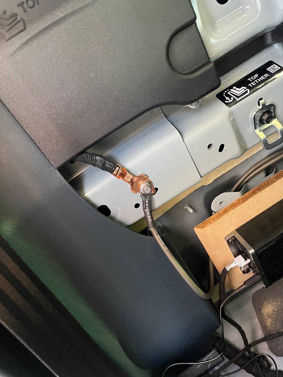

here is the ground
Ford Maverick Kicker Key 500.1 Not working IMG_7163
Here is my power wire coming from the battery it says I’m getting 14v and the speaker wire going to the amp. FYI I’m a noob to this audio stuff sorry if I sound slow lol

I have it powered to the battery with 8 ga wire from a kicker kit. Maybe the ground I put it to is messed up but I had checked it with a meter and it was fine maybe I will do the sheet metal screw tho. Check my new post for the pictures.

that's a pretty big factory ground. I'm not sure what it is, but people have used it (I didn't). the symptom of that ground being looped or noisy would be distortion, not low output. so I think your ground is fine.
so the 500.1 has a battery direct power cable and the 200.4 is getting power from the T harness, correct?
