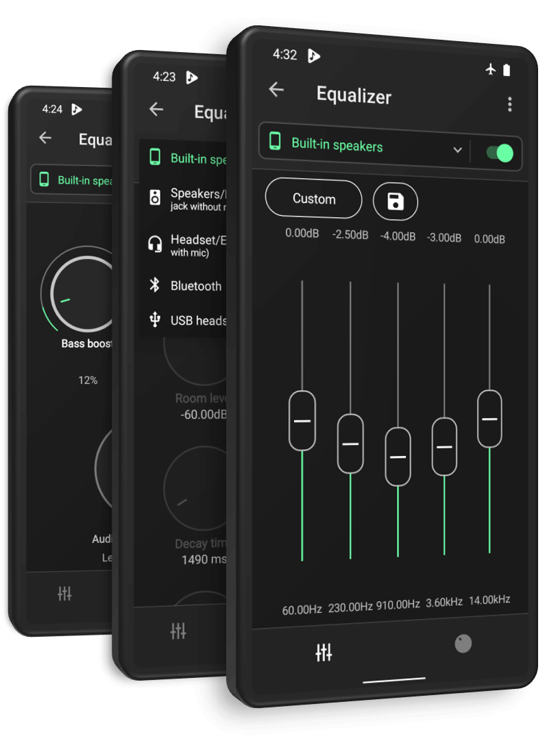

If you are using Android Auto you can have your music app (I use Musicolet) equalize the signal before it gets sent to the head unit. You can increase the number of band the equalizer will adjust in the app, you aren't limited to what you see below.
Ford Maverick Definitive EQ fix in the lariat with a B&O system? ss3.bak

I’m using CarPlay. I’m starting to wish I used Android Auto because I’ve had others suggest this fix and it would be nice to have. Thanks.
