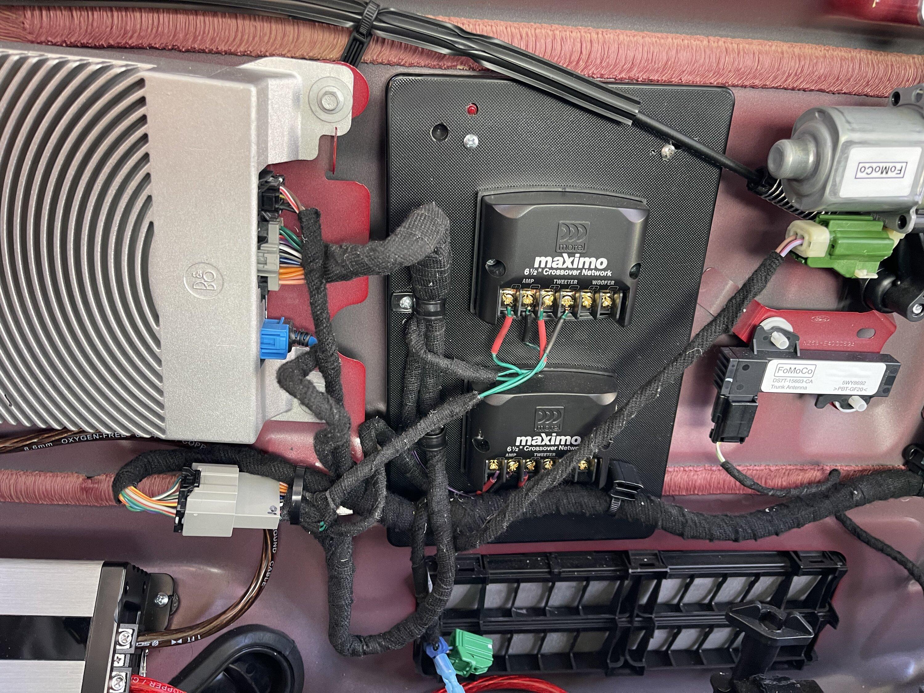

Actually rethought the install and have taken some more intense steps to get the tweeters in the factory dash spots by remoting the crossovers by the B&O amp. Unlike a lot of people I actually like the soundstage the windshield gives. I am planning on dealing with the imbalance of the center speaker a couple ways. I have the Morel Maximo 6 components. Their 4 ohm tweeters may be more efficient than the B&O tweeters and that would help balance them to the center and if that doesn’t work I‘ve have some high power resistors that I can put on the center and that will bring the volume down for sure. Now the issue is the Morel tweeters are a little too big to go down into the factory spot. I don’t really want to hack those spots. I also have a spare pair of Polk Audio tweeters from some DB6502’S that do fit and they are more efficient than the Morels. So when I get around to it I’ll be trying to shoe horn the Morels in there first. If not I’ll change to the Polks and swap out the crossovers. I’m actually pretty impressed with the volume I’m getting with just the B&O amp along with a 8” sub and separate sub amp. Here is a picture of the Morel crossovers mounted by the amp.
