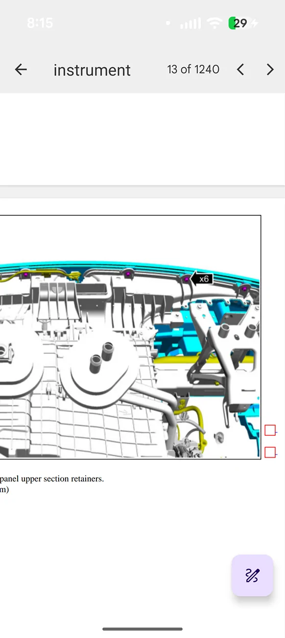

You're right. The issue you have is different, and I likely also have the same one. Pegs fixed the tapping. Now I have deeper knocking. It's related to the black windshield defroster vent on the driver side.
My guess is it's one of the bolts that hold the vent to the blue plastic on top.
