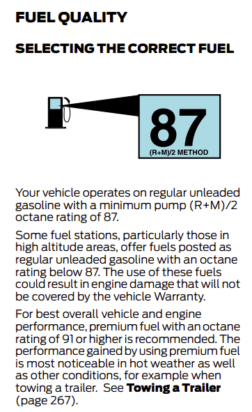

Yes, the dealer is correct, as long as the regular unleaded is at least 87 octane.
The manual on p172 states that as well:
Ford Maverick Daily short driving distances, Blackstone engine oil analysis... 1705443889603
I use super/premium unleaded gas from the second time the gas tank had been filled, first time the dealer filled it up. That's just my personal preference and each of its own.
