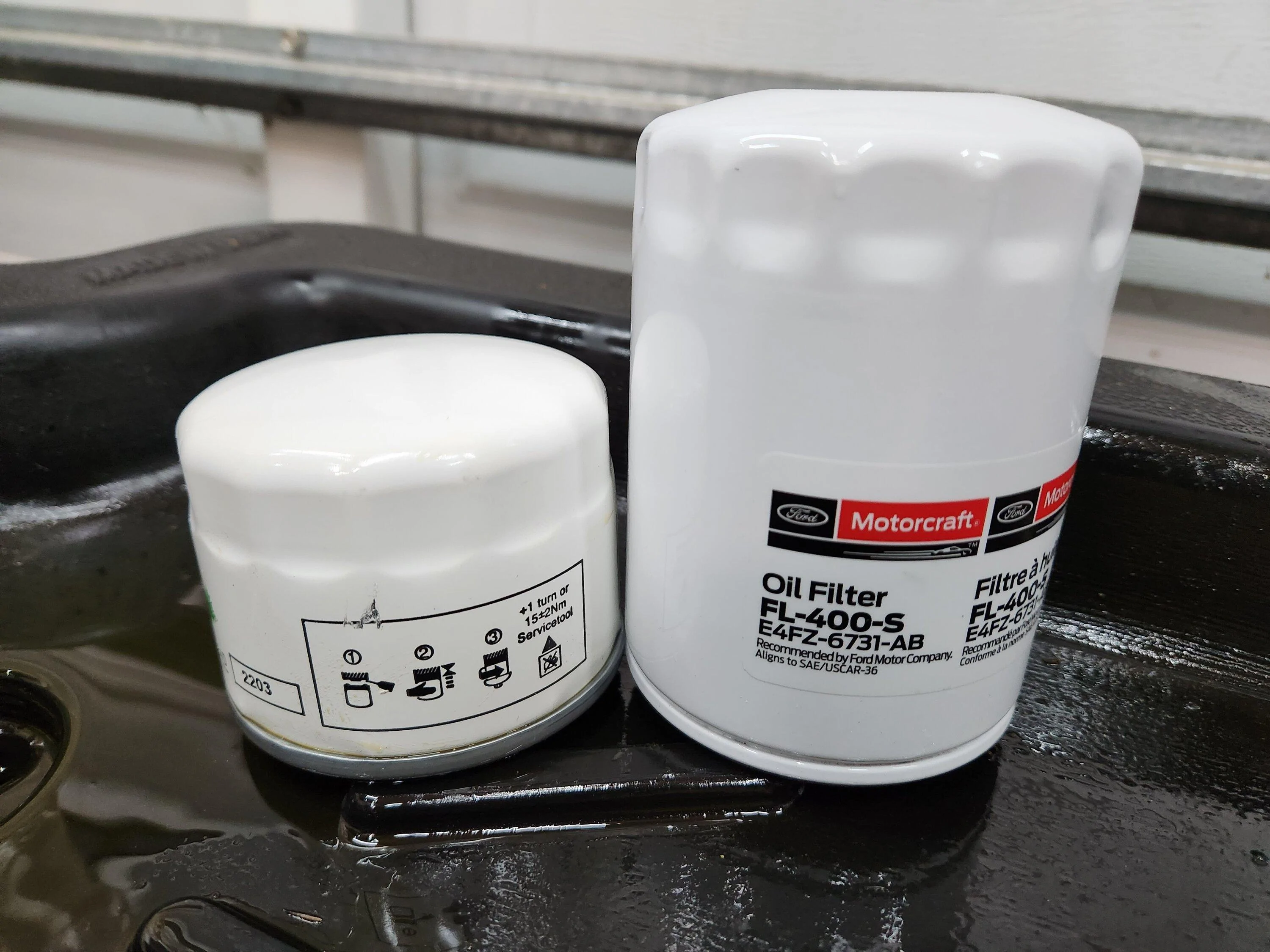

The FL400 has a 21psi bypass valve while the FL910S has a 14psi bypass valve meaning that while you may get "fewer" bypass events, if your oil is super cold it's not flowing enough through the media and the bypass isn't kicking in at 14psi like it should be to flow oil to your engine. Ford specd the FL910S for a reason, especially on the 2.0 Ecoboost but in really really cold conditions you're probably seeing oil pressure in the 70-80 psi range anyway which means you're in bypass no matter what filter you run.

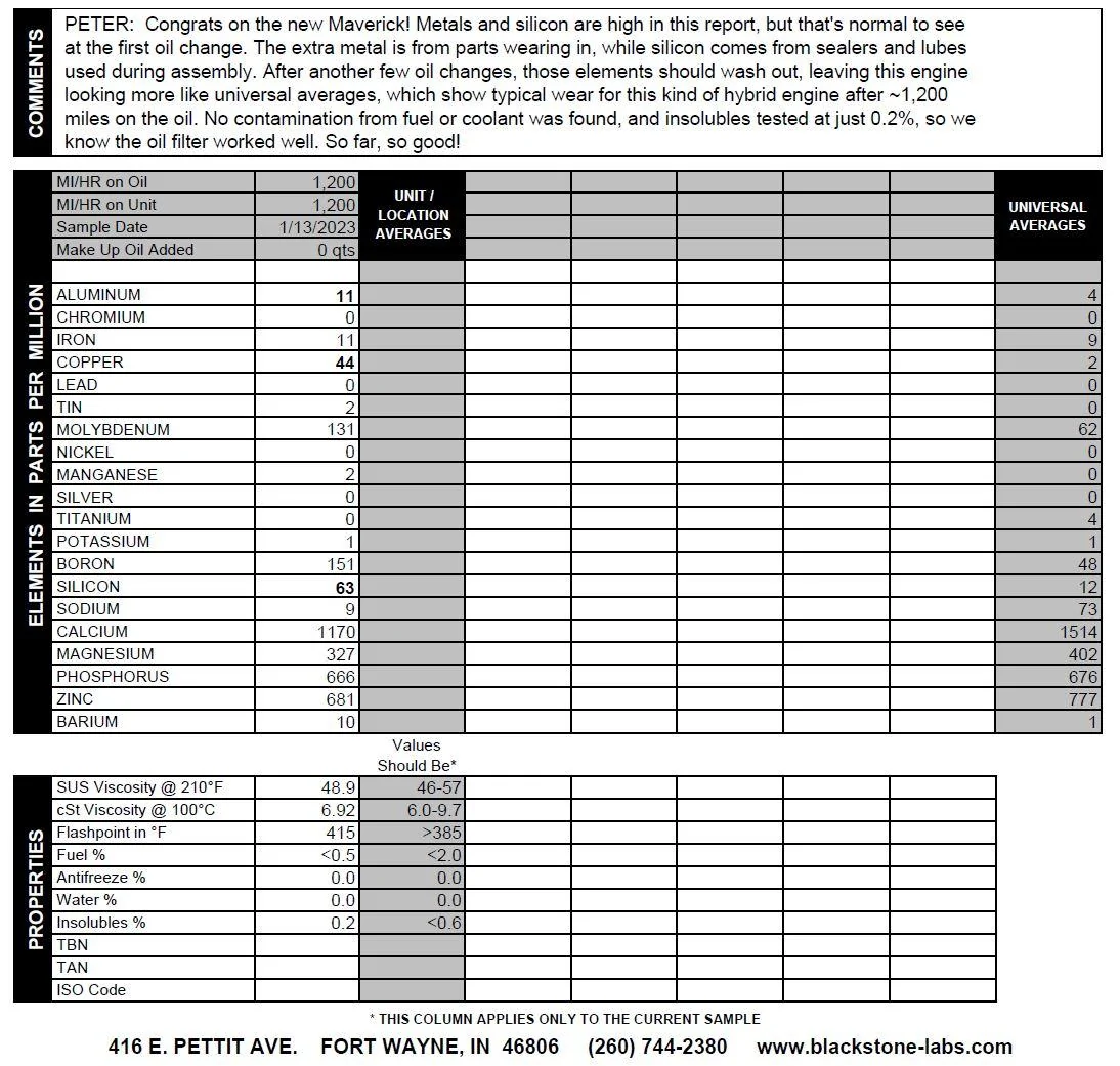

I've gotten into the habit of doing oil analysis on my track car and I find reading the results and building a trend interesting. I decided to do the same for my Hybrid Maverick, since it's the first new car I've owned I figured it might be cool to watch the engine break in. Plus it may be valuable data for someone else down the road, and there are some basic comparisons we can do between oil and maybe even filter types. Obviously, there are many variables to engine wear, so keep that in mind.
My first oil change was done at 1,200mi. Much earlier than Ford's recommendation and earlier than most will do it. I do my own maintenance so it's a cheap way to get the factory oil, early break-in wear metals, and lubricants out of the motor. Plus, I don't like the factory-installed filter, look how tiny this thing is! I decided to go with an FL-400S, it's quite a bit larger, has better filtration, and I have a bunch lying around from other vehicles anyway. My Maverick sees a lot of freeway use, probably 80-90%, so the engine is running most of the time. I do also tend to cruise at 75-85mph when the freeway is clear.
For the new oil, I went with Mobil 1 0W-20. I don't want to start an oil debate, I used Mobil 1 because I have run it in my track car for thousands of abusive track miles with great results. It'll be interesting to see the difference in the additive packages between it and Motorcraft. Won't be able to really judge wear differences or viscosity much between the Motorcraft and Mobil 1 in my truck, though, since it's still breaking in and I don't plan to run Motorcraft for a full interval. Oh well.
Enjoy the data point!

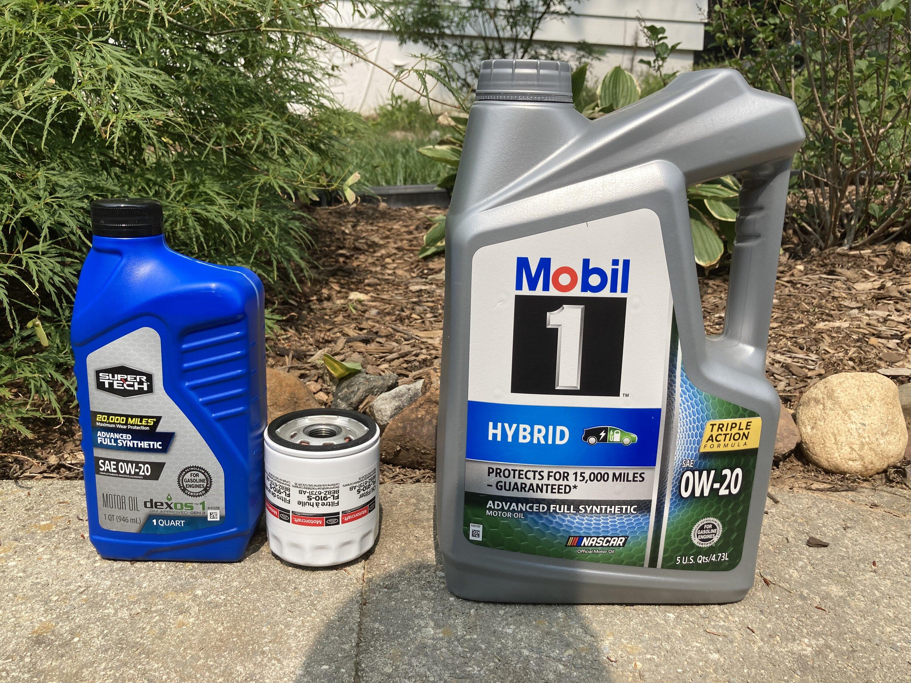

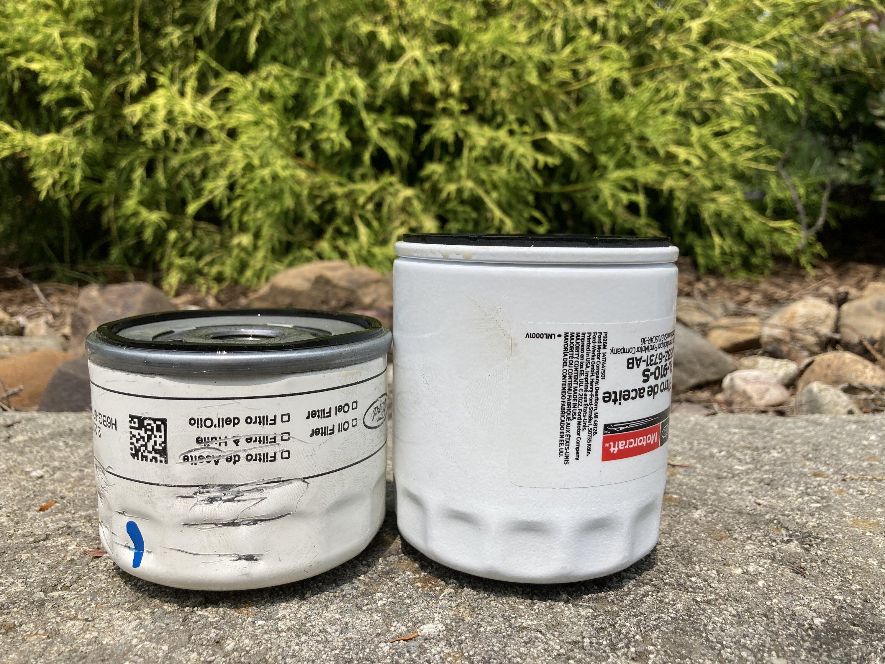

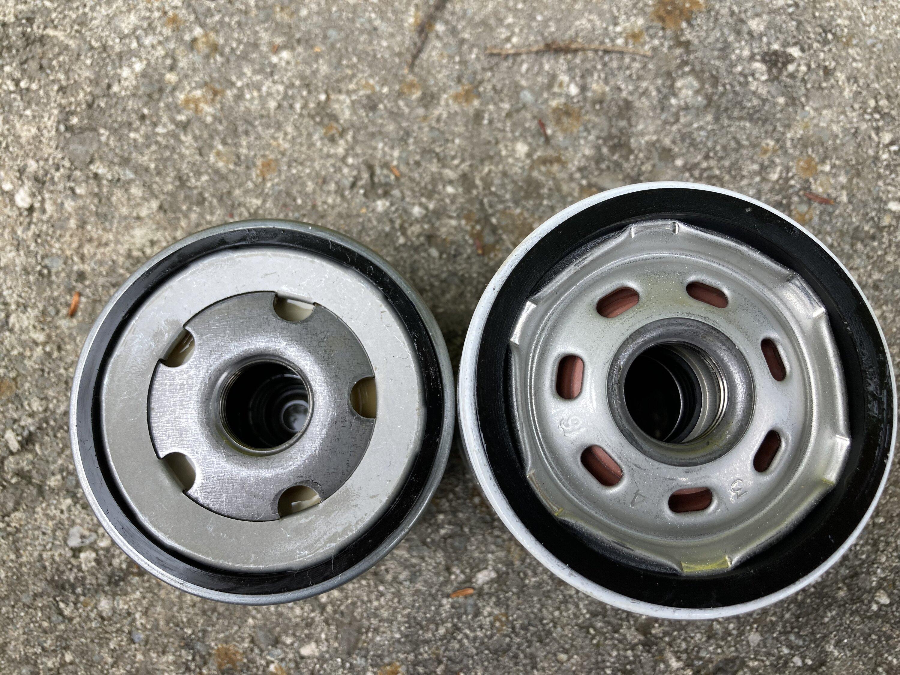

Just changed my oil at 1,500 miles. Found some solids in the oil after emptying the oil pan. Also used Mobil 1 hybrid 0w 20 had to use Walmart Super tech 0w 20 as the only brand in one quart size left on the shelves. Good to know FL 400s works with the hybrid engine. I used the ford recommended FL 910s, but have FL 400s filters in my garage for my riding lawnmower. The smaller factory filter is heavier than the larger replacement filter. Thanks for doing an analysis on your oil, good information.

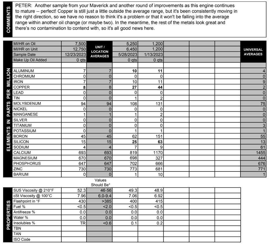

Where is all that copper coming from? Dry bearings?
Also not sure why the silicon is so high...
Make sure you're reading the column to the left. The one on the right is the oldest/first change. Silicon is down right in line with universal averages now.
Copper has been trending way down through the 3 changes and is getting closer to universal averages. It's more about the trend than any one reading. If on the next change copper suddenly started increasing rather than continuing to trend down and flatten out then that's when to potentially be concerned. Right now it just looks like an engine breaking in to me.
