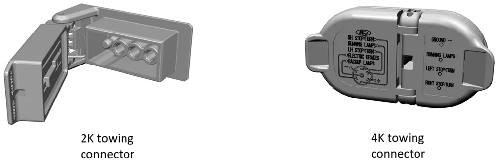

As established you have factory 2k (trailer wiring connector as is on the left):
Ford Maverick Continuous Trailer Charging Question 2kvs4kconnectors
