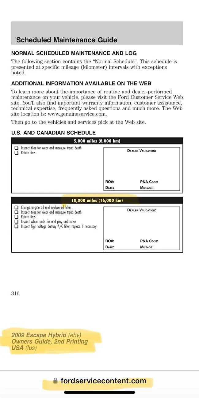

A bit more info on why I don't trust the manufacturers 10k miles oil intervals. The Maverick Hybrid has the Duratec 25 engine in it, it is the same engine as in the Escape. The manual for the 2009 Escape estates an oil interval of 7,500 miles. The EPA regulations and marketing are the reason for this change.
YOU POSTED A DOCUMENT FOR A GAS ONLY VEHICLE - NOT A HYBRID! 😜
The Ford Recommended Oil Change intervals for HYBRIDS has ALWAYS been 10,000 miles, dating back to the 2005 model year.
20 years of data. Millions of HYBRIDS with no widespread engine trouble with 10k OCI.
If a 20 year "test" with ~2 Million engines is not a fair test; what is???
