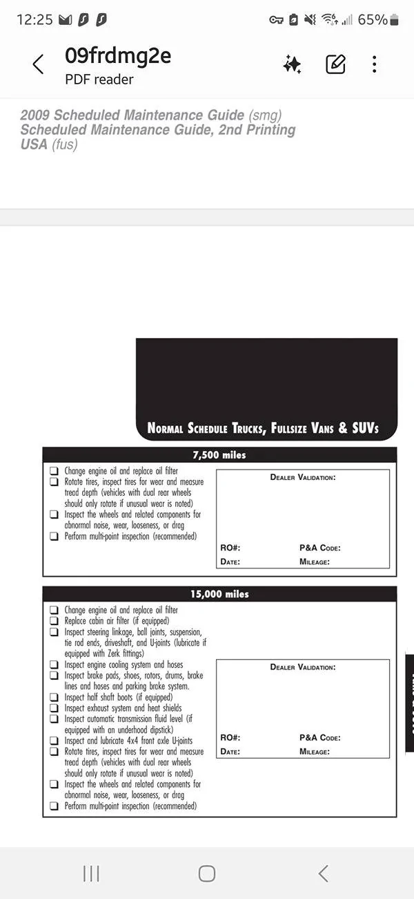

A bit more info on why I don't trust the manufacturers 10k miles oil intervals. The Maverick Hybrid has the Duratec 25 engine in it, it is the same engine as in the Escape. The manual for the 2009 Escape estates an oil interval of 7,500 miles. The EPA regulations and marketing are the reason for this change.

I agree totally! I have an Ecoboost Maverick with 10,914 on it. It is a 23 that I have had since I order in September of 2022. I change oil every 5k for sure. Especially since it is a Turbo & Direct Injected engine. Ford will do whatever looks better for them on paper.
On an Ecoboost, 5,000 is the most I'd change it at. Better every 4K. You have direct injection which dilutes the oil. And your engine is always running. Hybrids have port injection and run far less, especially those driven mostly in town. The port injection does not dilute the oil like DI. 8,000 miles is fine on a city driven hybrid. If l was driving a hybrid on the highway constantly or towing a small trailer weekly I'd do 5,000 or so. The variables matter.

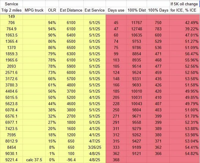

Yes - the 10K inspection of many systems and tire rotation on your HYBRID (emphasis for others) may not match the 1 yr max for oil change. Max miles with no extreme use could easily hit the 10K too of course.
Multi-point and other inspection items could happen before 10K, and be done with oil change of course.
OLM is based on engine run time, even idle time, and towing time, and temps - so there is no miles per %, it'll be different for others, shoot it'll be different rate even for you possibly during the time.
Here's mine with non-extreme driving style.
Yellow what the OLM reported in Fordpass app.
Red what the estimated miles and days would be based on current miles/days and % given.
At 50%, it switched to 1 year out oil change but then reverted, before/after that it had 13 months, and whatever distance it estimated would happen.
That column for % ICE usage, matches the trip records really close - so it really appears to be going for 5K engine usage for an oil change. Other posters have showed towing shortens it, and extreme idling thru winter did too.
