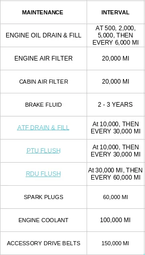

Here is my current maintenance plan. I primarily based it on the Ford 2023 severe service schedule, FordTechMakuloco (Ford master technician) on YouTube, and The Motor Oil Geek (Professional Lubrication Specialist) on YouTube.
Ford Maverick Maintenance schedules Screenshot from 2024-03-02 22-53-15

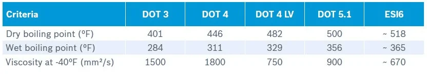

Brake fluid: 30-40k. 50k max.
ATF: 30-40k. 50k max. same time I do brake fluids. Given the Maverick has an internal filter, I'll likely flush every 30k.
I read up on that Motorcraft DOT4 LV and it is better than standard Dot4 and Super DOT4 and probably required to prevent braking issues. Some Audi and BMW owners that used DOT4 instead of DOT4LV experienced some ABS and brake issues. I used the ATF make in the past but stopped once they could not longer use the blue fluid color which made it a nice way to see when then fluid was completely flushed switching between gold and blue.
Now I only use Bosch ESI6 in all my cars ....
Ford Maverick Maintenance schedules 1710830737004-9m
since it exceeds all DOT4 LV specs and has a much longer lifetime between changes as long as your system is really sealed.
