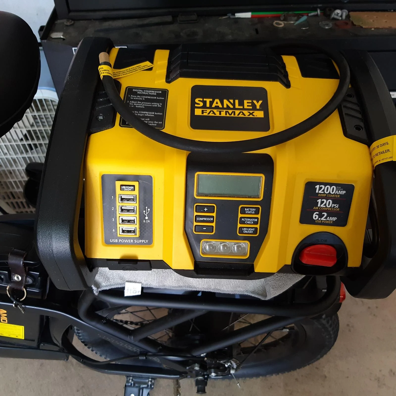

I keep a Stanley FatMax compressor/jumpbox in the bed.
At Christmas time Sam's had these on sale for $70.
So far I've only used the compressor.
Set the pressure you want, it automatically turns off.
