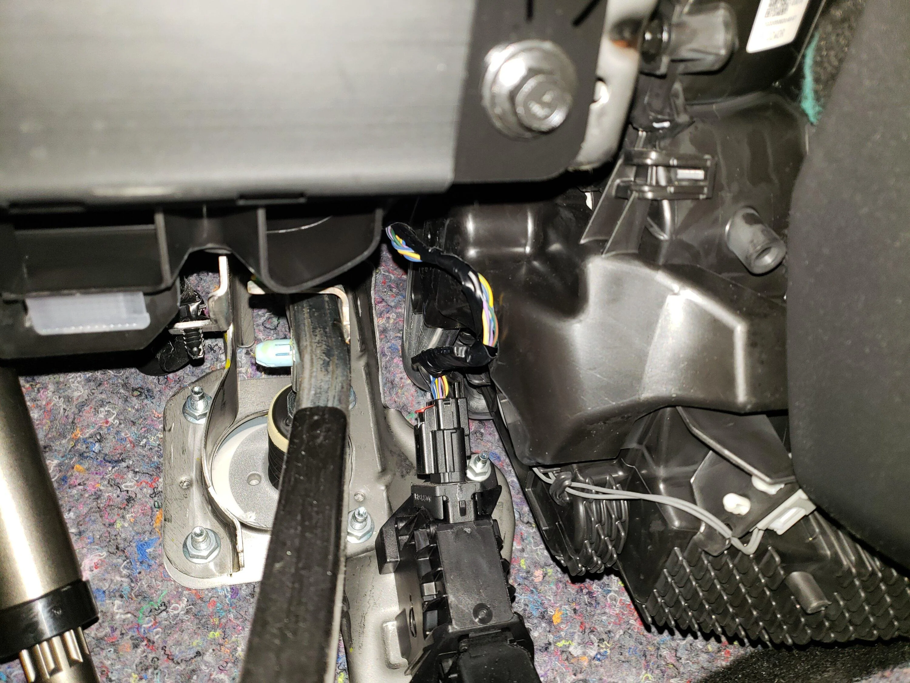

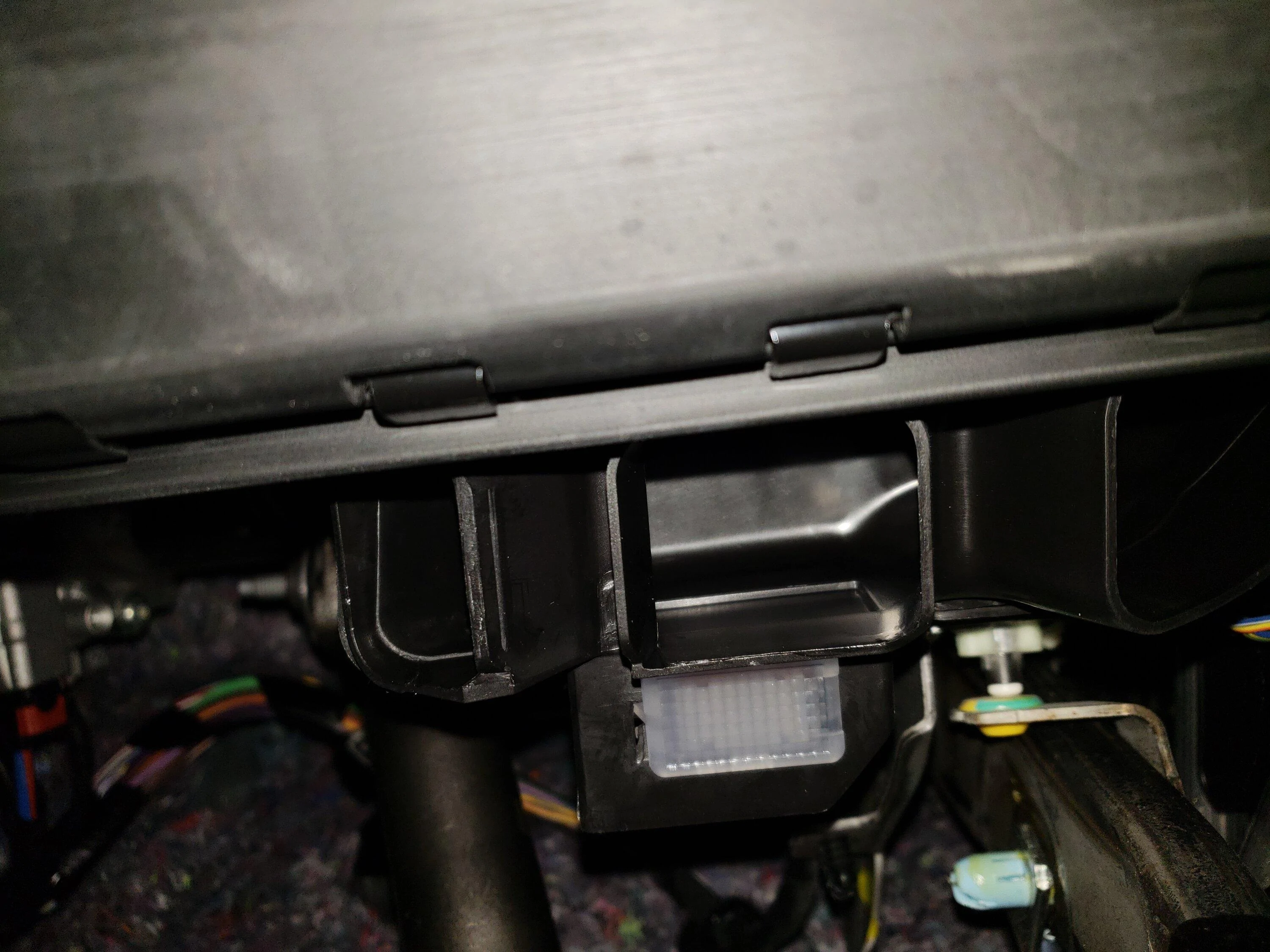

I noticed my feet getting cold last winter and it seemed like not much air blowing down there compared to the other vents even when set for only the floor. There are three little vents down there. They are very small and point more twords your ankles than your toes.
Wow. I never noticed how poorly angled these are. Most vechiles I've had in the past have vents that came out the side of the center console, which would mean one foot would be on fire while another was cold lol. Just can't win, can we?
On a side note for a potential fix. I bet you could just cover up those 3 vents and cut out a hole in the bottom of that tube just behind them that faces downward and get more coverage on your actual feet and not your shins/knees. I'm going to get up under there eventually and look after seeing this post.
Full disclaimer, I have not had an issue with them as I usually wear boots but this first winter with the Maverick has also been very mild.
