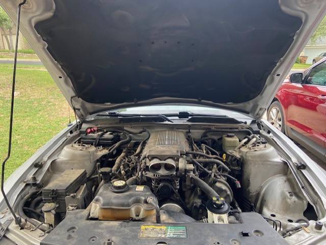

Just did a major surgery on my sons neglected 2006 Mustang GT. I didn't want to dig into a filthy engine bay, so I used degreaser and a brush on heavily soiled areas and rinsed with my power washer as described above. I then used foaming engine bright and a brush on the rest and rinsed with the power washer. I just let it dry as I wasn't really going for show quality. I had the intake off so I covered the throttle body and battery. I'd cover the filter if it wasn't removed.
The surgery was a success. I plan to use this technique going forward on cars I work on.
