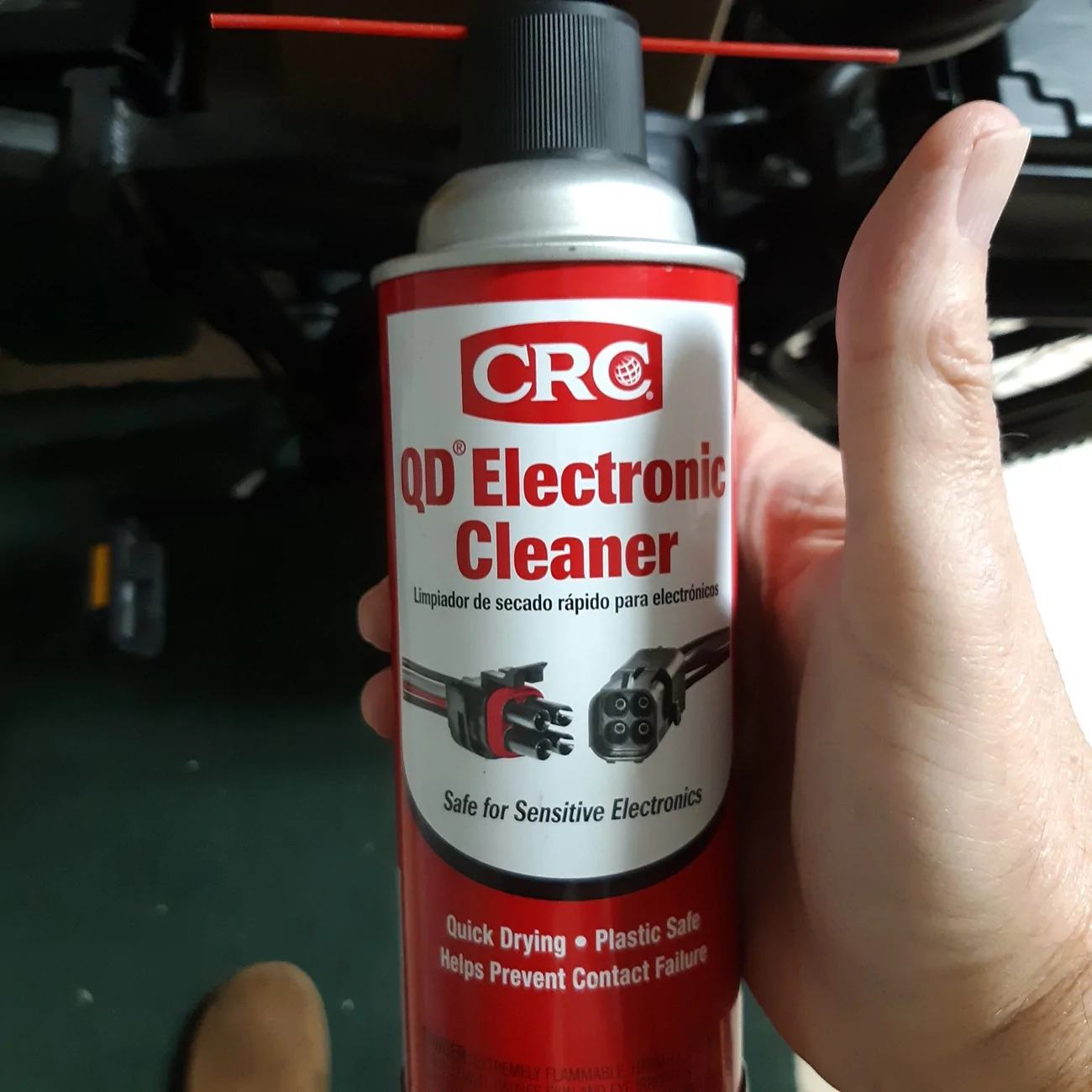

First this.
Then this.
Yup, I have the exact same stuff. Ran a small part time computer repair shop out of my home for about 20 plus years. There are many different brands , but they all clean about the same and do a good job, especially on keyboards!
