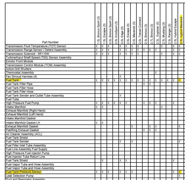

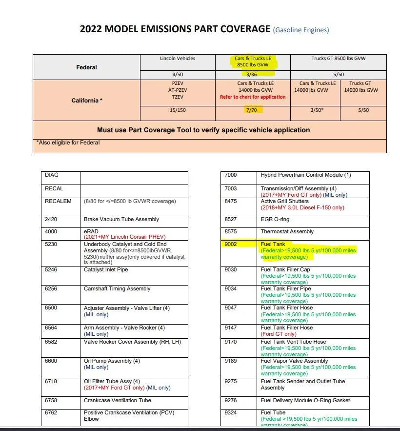

As I told you in the DM, I did run Ford's "part coverage too" on 9002 (the fuel tank) for your VIN & miles. I just doubled checked that I used your state, not mine. That shows no coverage. That is what the dealership will be using to determine coverage.
This part would be covered in NY & other states covered by California emissions standards.
I'll attach a chart from the part coverage directory. For 22 MY, 9002 is covered 3/36 in Federal Emissions states for cars and trucks w/ gross vehicle weight less than or equal to 8500 lb.
The coverage is 7/70 in CA emissions states (for vehicles w/ gvw less than 14,000 lbs).
There is 5/100 coverage under federal emissions, but only for vehicles greater than 19,500 lbs.
That other chart posted is also from Ford's parts coverage directory, and gives more detail about the 7/70 CA emissions coverage.
For 22MY:
California Emissions warranty applies to: o Passenger Car & Light-duty Trucks (through 8,500 pounds GVWR) – California (CA), Colorado (CO) Connecticut (CT), Delaware (DE), Maine (ME),
Maryland (MD), Massachusetts (MA), New Jersey (NJ), New York (NY), Oregon (OR), Pennsylvania (PA), Rhode Island (RI), Vermont (VT) and Washington (WA).
I see some news articles from 2023 talking about NM adopting CA emissions.... but I don't see that indicated in anything from Ford. Perhaps it hasn't taken effect yet?
Or if you think that it may gave been in effect in 2022....then maybe your dealership can contact Ford for clarification?
Ford Maverick Check Engine Light Fuel Tank Assembly 22 my 9002 emissions coverag

NM is not listed as having CA emissions coverage in the parts coverage directory for 22 MY. The last time NM is mentioned as being eligible for CA coverage is 2011 MY.
For 22MY:
https://ww2.arb.ca.gov/our-work/pro...-have-adopted-californias-vehicle-regulations
It looks like coverage won't be applicable in MY until 26 or 27 MY.
