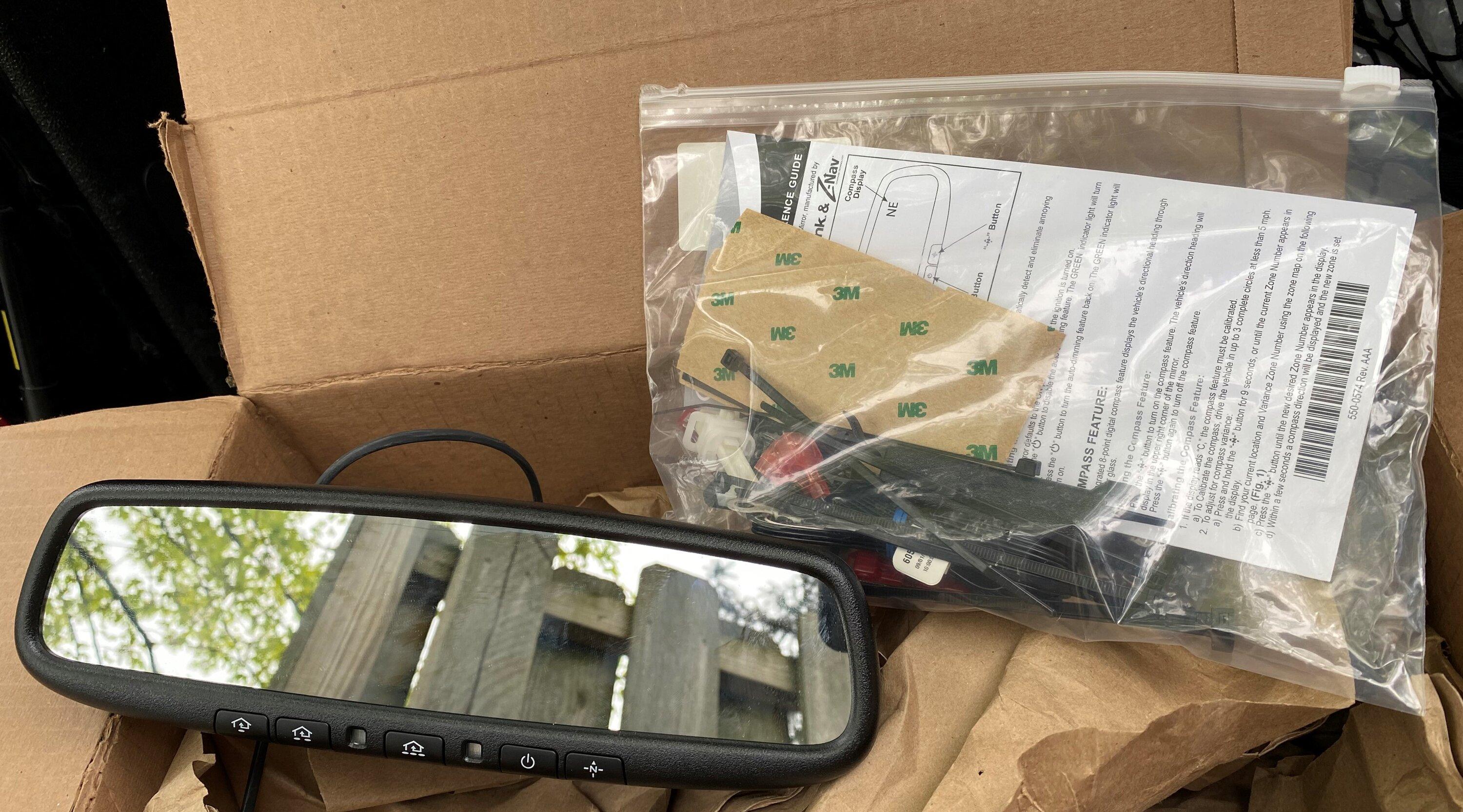

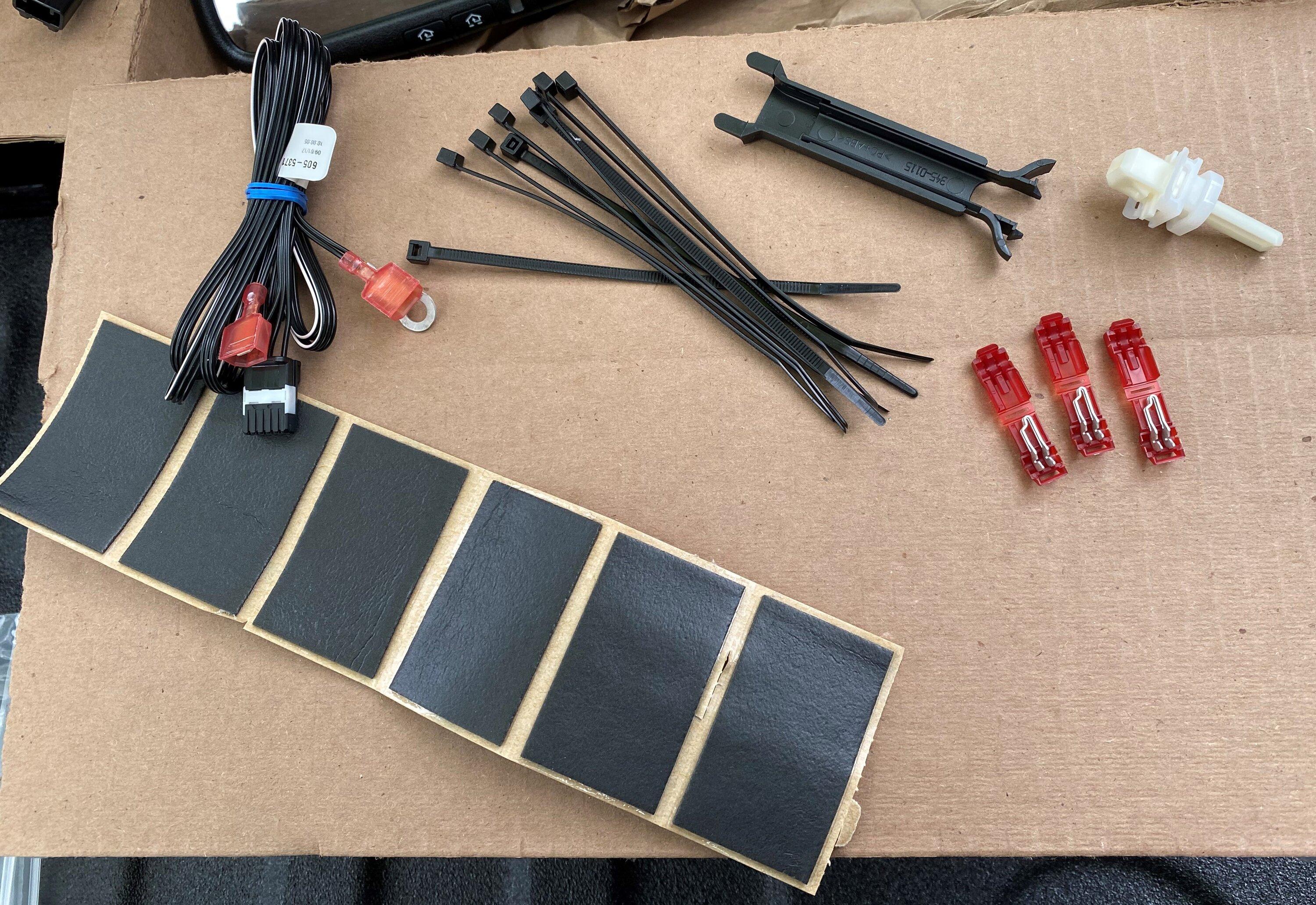

Following up on my recent post, I ran down to the location pretty close to me in Medina OH (shown in the previous table) and picked up a A7062-ADUP1 model for $13.49. This shipping would have been $13 (by the way, I did setup an incomplete order on the website and got an email indicating 5% would be taken off the by using the code "TAKE5". Since I picked up the item directly, could not use that, but maybe someone could.)
Here is what was in the box:
Heading out of town, but will get to this upgrade when I return. Hope to video the process using some of the techniques shown in this thread.
