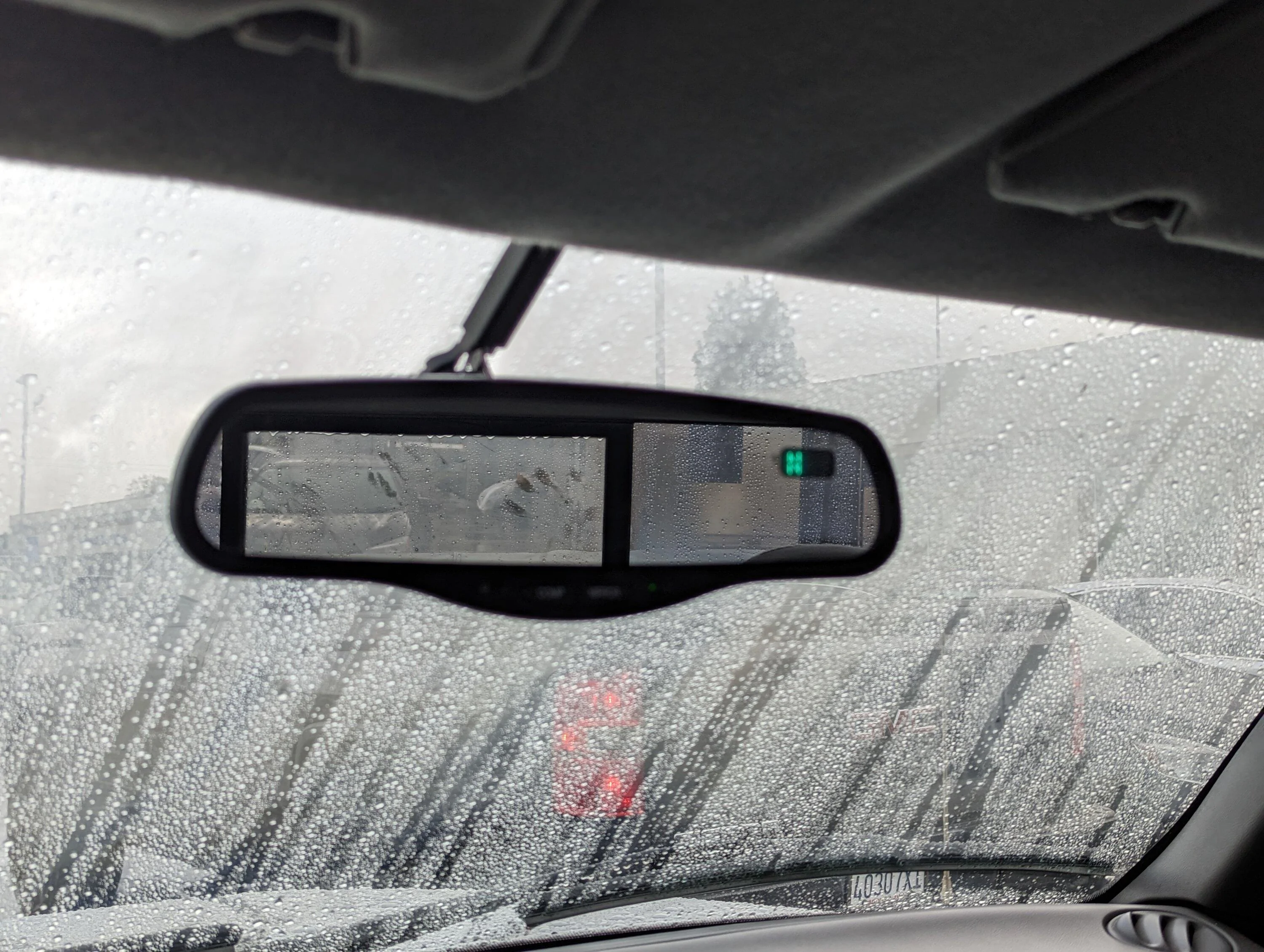

About goddamntime someone posted a picture of this mirror installed! Good grief 🤦. After reading through almost every thread (over 50), I was starting to believe this was a bigger hoax than the Chupacabra.
Anyways, I just went ahead and placed my order. Hope I'm able to install it without any major issues. I installed one in my 2003 Mazda B3000 (picture attached) over a decade ago, and it worked/works as intended. I'm only interested in the dimming functionality and compass. Hope my order doesn't get cancelled as some have experienced...🙏

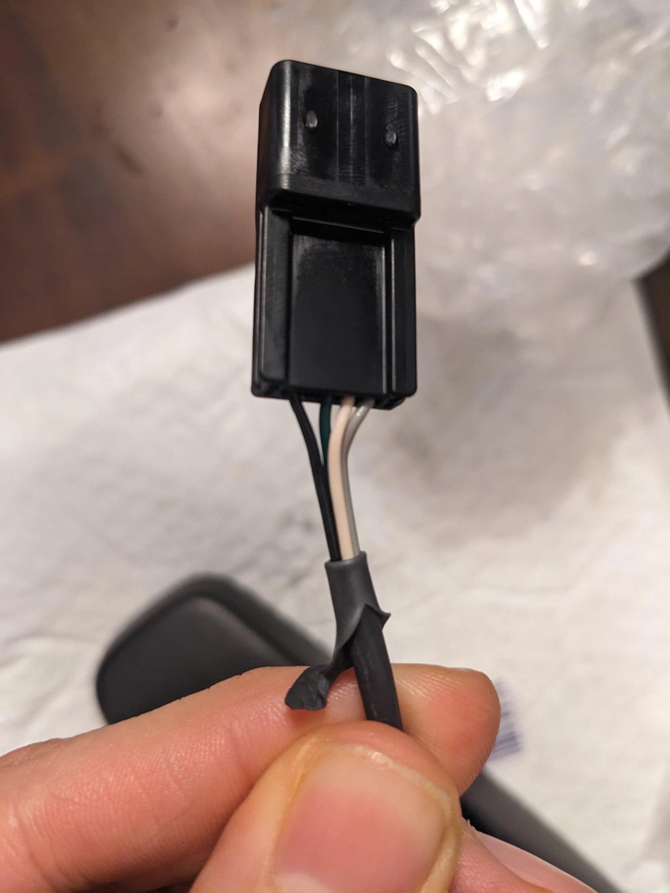

I just got my mirror in, but I have four wires - how do I hook this thing up?
Ford Maverick Cheap auto-dimming, homelink mirror PXL_20230303_230545839
MustardTiger
Aug 5, 2021
Milwaukee
2022 Maverick, 2001 AWD Swapped Jetta
After playing around with the Auto/Start stop light, I have discovered that the “12v” for it is a PWM signal, not a constant voltage. I am thinking that is probably what is going on with the purple wire at the overhead console light.
Yes you are correct that wire is a PWM signal and should not be used to power anything. I found this out the hard way doing almost the exact same thing on my last car.
Using a PWM to power the mirror may look like it's working without issues, but what you are doing is constantly turning the mirror electronics on and off repeatedly millions possibly billions of times over the course of it's life. Eventually this will cause something to break, probably starting by scrambling the memory in the homelink or the compass or causing other random intermittent issues. It's not going to cause your truck to catch on fire but it's not ideal.
Surfah
Mar 26, 2023
NoVa
'22 Ford Maverick XLT Hybrid

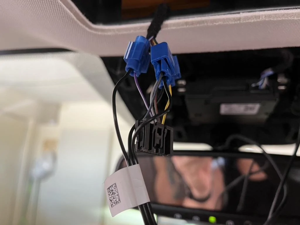

Not sure if you figured it out but thought I'd share since I just got this same mirror.
This is how I wired everything and it is working great:
Black wire in the mirror harness is Ground. Splice it to black wire in the overhead light harness.
Green wire in the mirror harness is your constant 12v (Homelink). Splice it to the yellow wire in the overhead light harness.
White wire on the mirror harness is the intermittent 12v or when keyed on (Compass/Auto Dimming). Splice it to the purple wire in the overhead light harness.
This is what I did and it works as I want it to. The garage buttons work always. The compass comes on when I turn the key to the on position. I know some prefer to have the garage buttons to work only when keyed for safety. But I kept a garage door opener in the truck previously anyway so what is the difference? It's much more convenient to just always be available. But if you wanted to only have the garage door opener work when the truck is keyed on splice the Green and White wires from the mirror harness to the purple wire. I love this mod. About $21 shipped and works perfectly. Took about 15 minutes to complete.
I will add that I have a Sommer Direct Drive garage door opener. The Homelink instructions included with the mirror to program it don't work. It was very frustrating to be following the steps and not get it to work. I found a PDF of the Direct Drive instruction manual online which had different instructions that worked perfectly:
Hold down all three garage door buttons until the lights turn off. Takes approximately 30 seconds. You can verify the garage buttons are in learn mode by pressing them. They should rapidly flash for 2 seconds and then turn solid. Now that Homelink is in learn mode press the learn button on the garage door opener and then go back to your mirror and press and hold the garage door button you wish to pair for approximately 3 seconds. It will rapidly flash and then turn solid. Now press the garage door button you just programmed and it should work. All other methods online got Homelink did not work except for this one. You do not need to program the Homelink buttons to the garage door opener transmitter remotes, just the opener itself.
