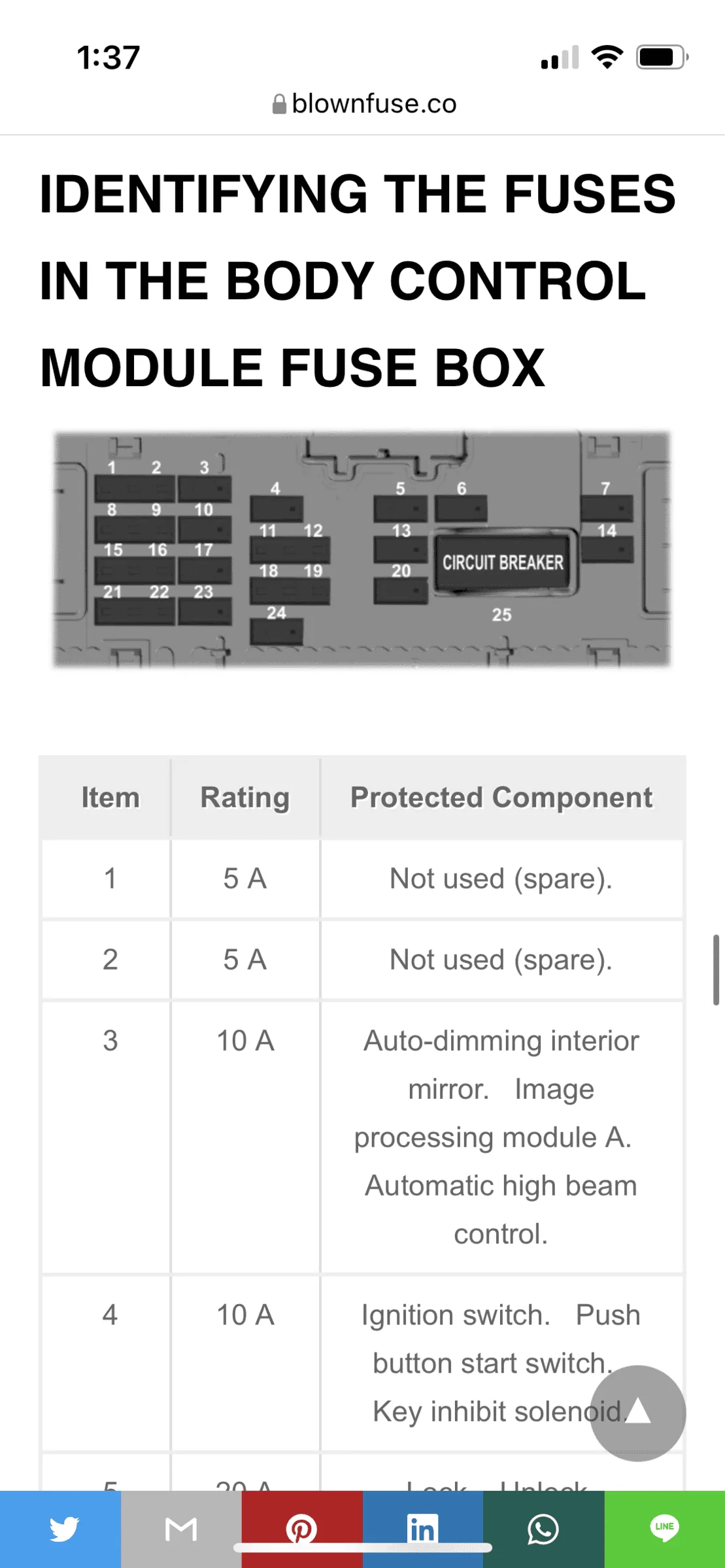

Will have to pull power from fuse panel.
Yes all features will work when powered.
Since the camera for the Auto Headlights are located in front of the mirror, there has to be power there. Something to check.
