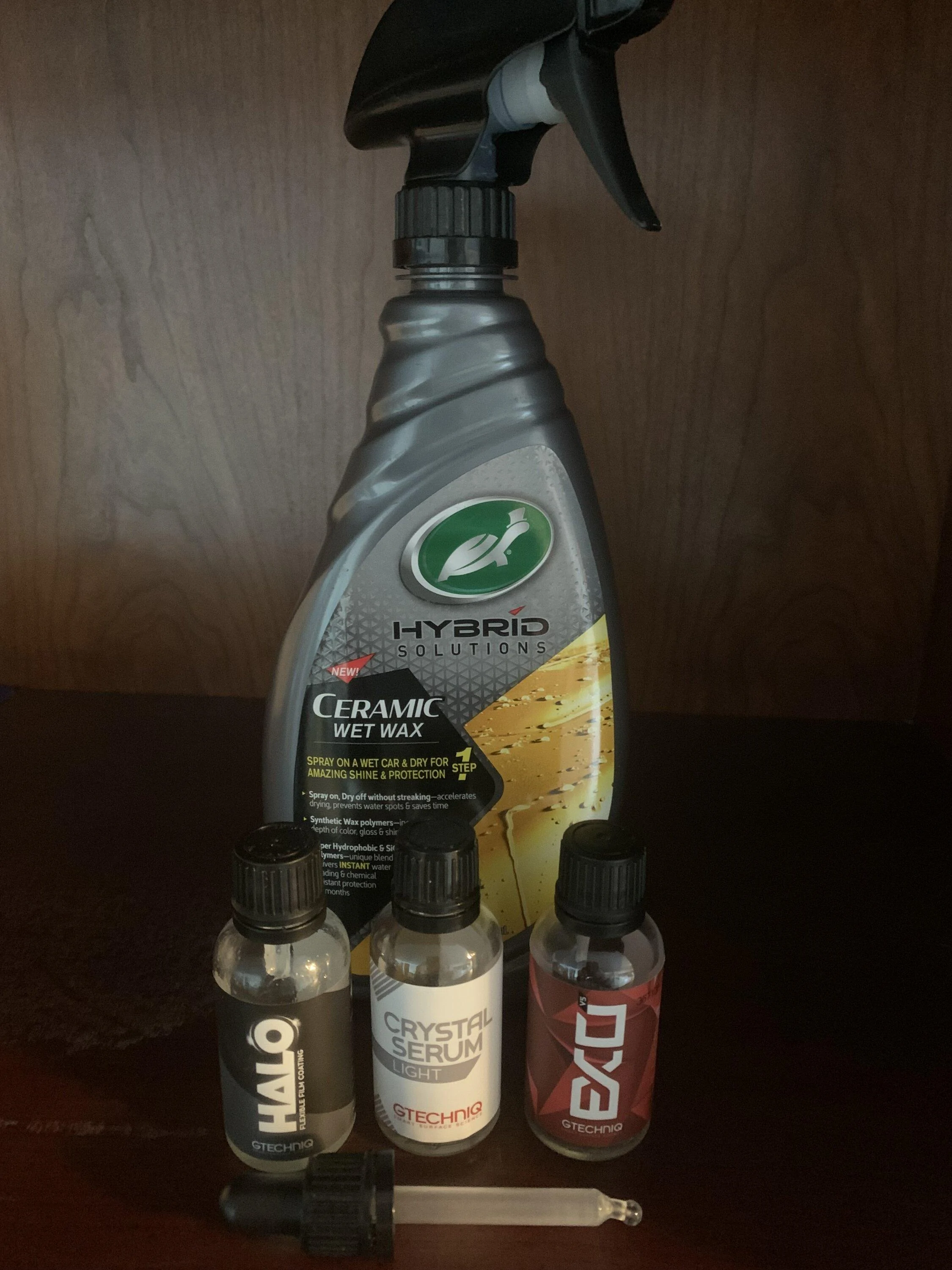

A true ceramic coating is NOTHING like wax. The best analogy I have seen is that it’s like putting on super glue. It’s very very thin, goes on absolutely clear and at a thickness of 1 atom/molecule, dries (flashes) very fast, and can result in cloudiness or dark spots if not properly leveled. A $15 bottle of ceramic wax at Walmart is NOT a ceramic coating. It’s at best a hybrid. And I’m by no means knocking it, because I have some and use that too (I have a few Turtlewax varieties). And with Ceramic, the prep is everything. Yes, you can skip the prep, and you end up locking in and highlighting existing defects (scratches, swirl marks, embedded grit/iron fallout).
I chose full ceramic because of the fantastic results I saw on this very forum, that blew anything I’ve ever seen (e.g. traditional waxes) out of the water. And I put a lot of effort in to my own truck to try to get similar results. I think I did, but it was a lot of work too. Work that I knew I was getting into after much research, and happy/eager to do it. I’ve never owned anything brand new and wanted to go nutz on it! For what it’s worth, I used Gtechniq products.
EDIT: A photo to show the scale of a typical spray wax bottle vs. the tiny bottles of full ceramic I used. These little bottles are 100ml each, and more than enough to do a full vehicle. You are literally applying drops per small section you work on at a time (typically 2x2 feet). Yes, that’s an eye dropper. It comes with the ceramic in order to apply the right amount to your application pad, which is also much smaller than a typical wax applicator.
There are 3 bottles of ceramic in my photo, each with their own specific purpose: HALO for the paint protection film, Crystal Serum Light as the main ceramic for the rest of the truck, and EXO v5 that is a super hydrophobic coating recommended as a “topper” for the CSL. I even have a 4th bottle of ceramic (not pictured) designed for glass. It was a mere 15ml, which is about the size of a sip of water for a hamster, but enough to do the windshield and door mirrors.

Wow. This makes me curious about the maintenance. Seems like a ton to keep up with.

My intent is to be quite the opposite. The more leg work I do now, the less I have to do later, including through brutal Minnesota winters.
It’s basically a glass-like coating on top the paint. Very thin, but very hard and durable. There are plenty of youtube videos showing how these hold up after x-months, x-years, etc. It’s impressive watching how water just beads and rolls right off, like nothing I’ve ever seen. It will make washing/drying that much easier too. “Most” of the dirt will blast right off with the initial power wash pre-spay, with little left to gave to go after with a wash mit and soap. I now use a basic electric power washer, soap “foam” cannon” that came with the power washer, and one 5-gallon bucket with a sediment trap. Plenty of videos on youtube about how to properly wash a vehicle too, including avoiding swirl marks, scratches, etc… while making the wash process faster than old way.
I’ll try to get a picture of it, but 3 weeks of an (UNusually mild) Minnesota winter even has the existing dirt beading, streaking, and wicking off. Never seen wax do this. Wax is soft and tends to trap contamination in it. Ceramic is hard like glass and hydrophobic (repels water). Wax “beads” water, but this stuff is a whole different level.
My other main intent to use ceramics is to limit how often I even need to “wash and wax,” and reduce how often I even need to do it. In part, because our winters can be VERY harsh and 5 months of the year might be pointless or even impossible to keep a vehicle so clean. Thus, any “self cleaning” properties I can factor in, the better!

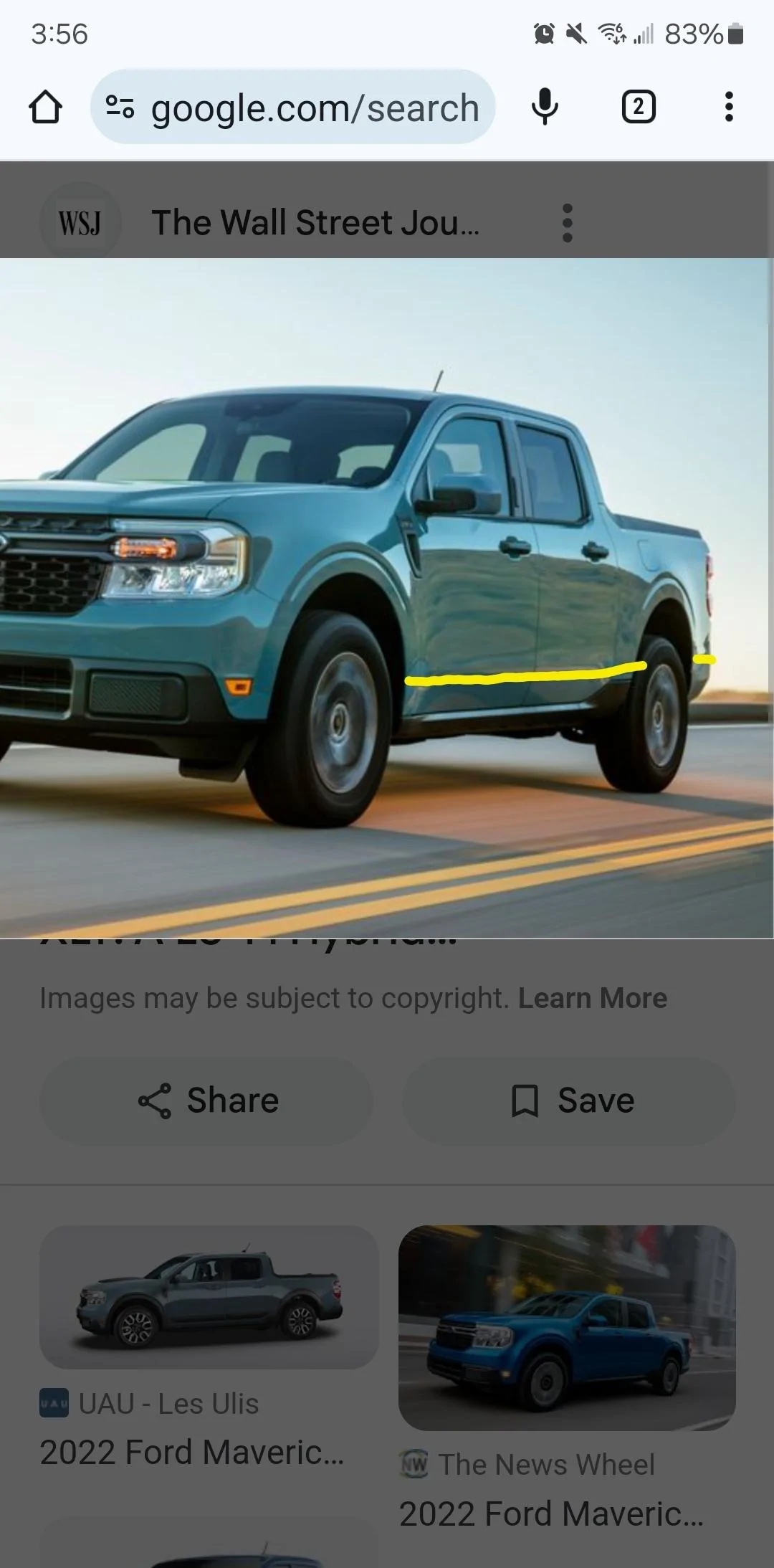

I paid for PPF on my XL(not a dealer install)The full hood,front and fenders. Handle cup areas and ecah door edge. On my next maverick I will do the same and also a strip down low front to back from line down. I only go to a touchless carwash 1 mile from my house then drive home and wipe down. I use 3M bead it up on exterior everything minus windows. Takes a hour to wipe down.
