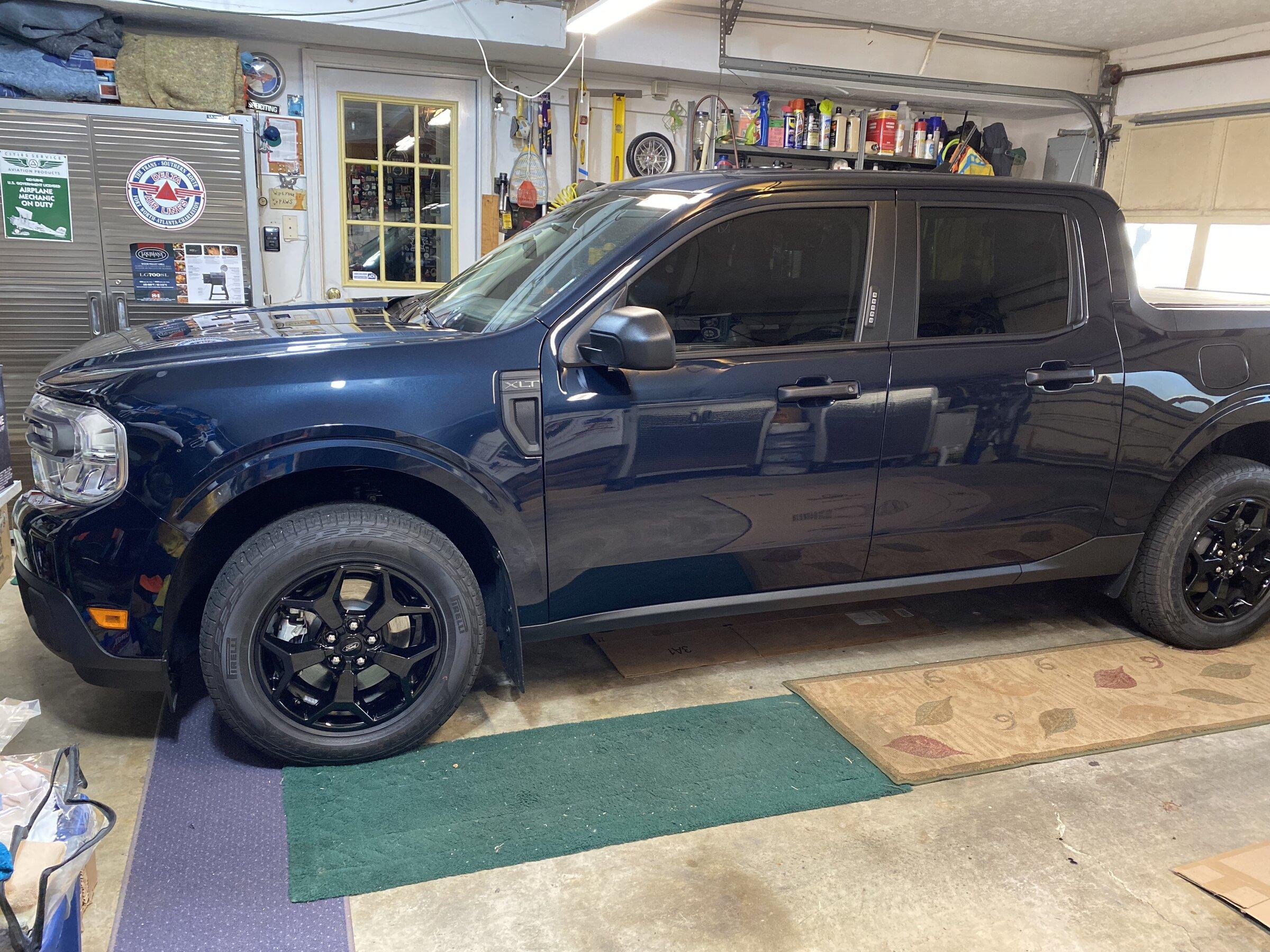

So happy with how it came out! Still have to VRT the trim and apply the ceramic boost tomorrow after the coat cures but I think it turned out wonderfully! Sure there were areas I could have improved but I am happy with my results 🙂
Process used:
1) wash with Adam’s car shampoo
2) claybar with clay lube (chemical guys)
3) Adam’s ceramic coating kit (not the quick spray stuff) step one, basically isopropyl alcohol on one body panel at a time.
4) Adam’s ceramic coating kit step two in 2’x2’ sections as it describes on the body panel prepped in step 3.
5) buff off when rainbow effect appears (15s-30s).
6) Adam’s graphene detail spray on wheels
7) Adam’s tire dressing
8) Adam’s detail spray on windows and trim (though I think I could have done better here but I was exhausted at this point!)
I think it turned out great 🙂 pics:
I must have gotten the same kit as you, looks great btw, I also did mine yesterday. Where did it say when to put the ceramic boost on? I did not see that in the instructions.
I really love the kit! It was easy to put on and had everything you needed except the paint correction stuff.

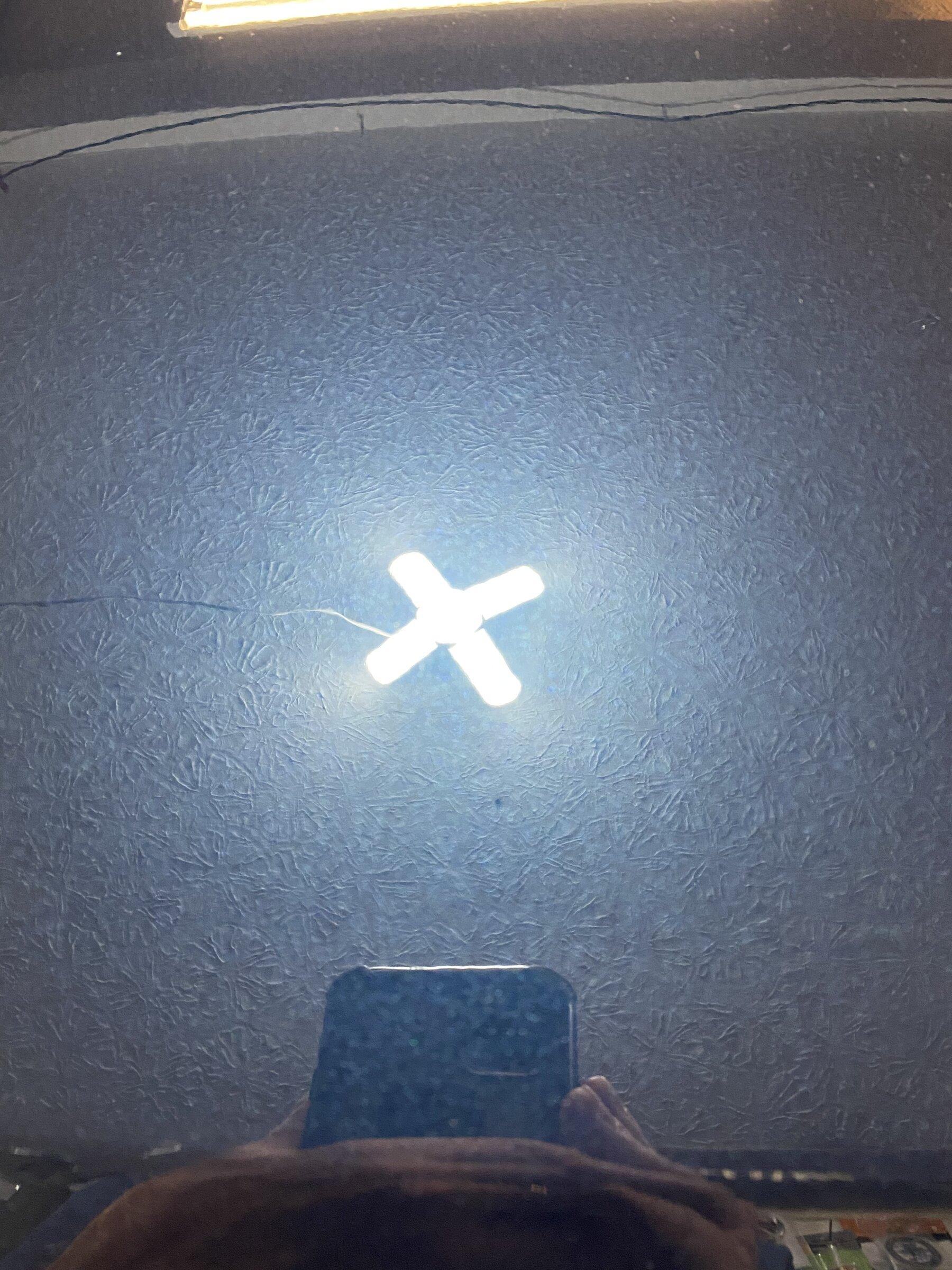

The second photo is looking at the hood, showing how reflective it is after the ceramic was added.
Looks awesome, great job! Mine said you can apply the boost after 12-24 hours of curing.

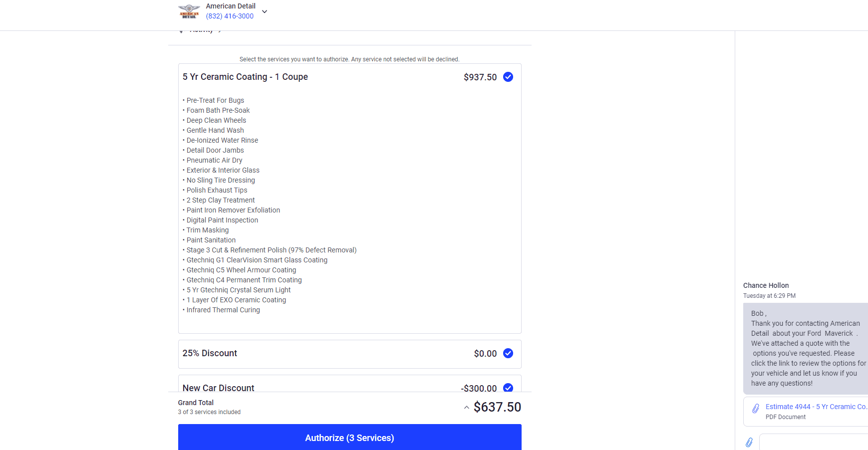

That looks really nice. I'm thinking of getting my Maverick done, but done by professionals as I have zero confidence in my ability to be that meticulous, plus time consuming. I got a bid of $625 with 5 year warranty. I will probably get the SIBL first. How long did it take you?
Might want to ask the company that gave you that quote what steps they take in the prep process before thy apply the ceramic coating. That is where the cost is.
This is what they sent. I know nothing about this. So does this tell you or not tell you anything? Any advice is appreciated
That looks pretty good except if this was in order of their process they are missing IPA before the coating process to insure they have cleaned any contaminants from the polishing..

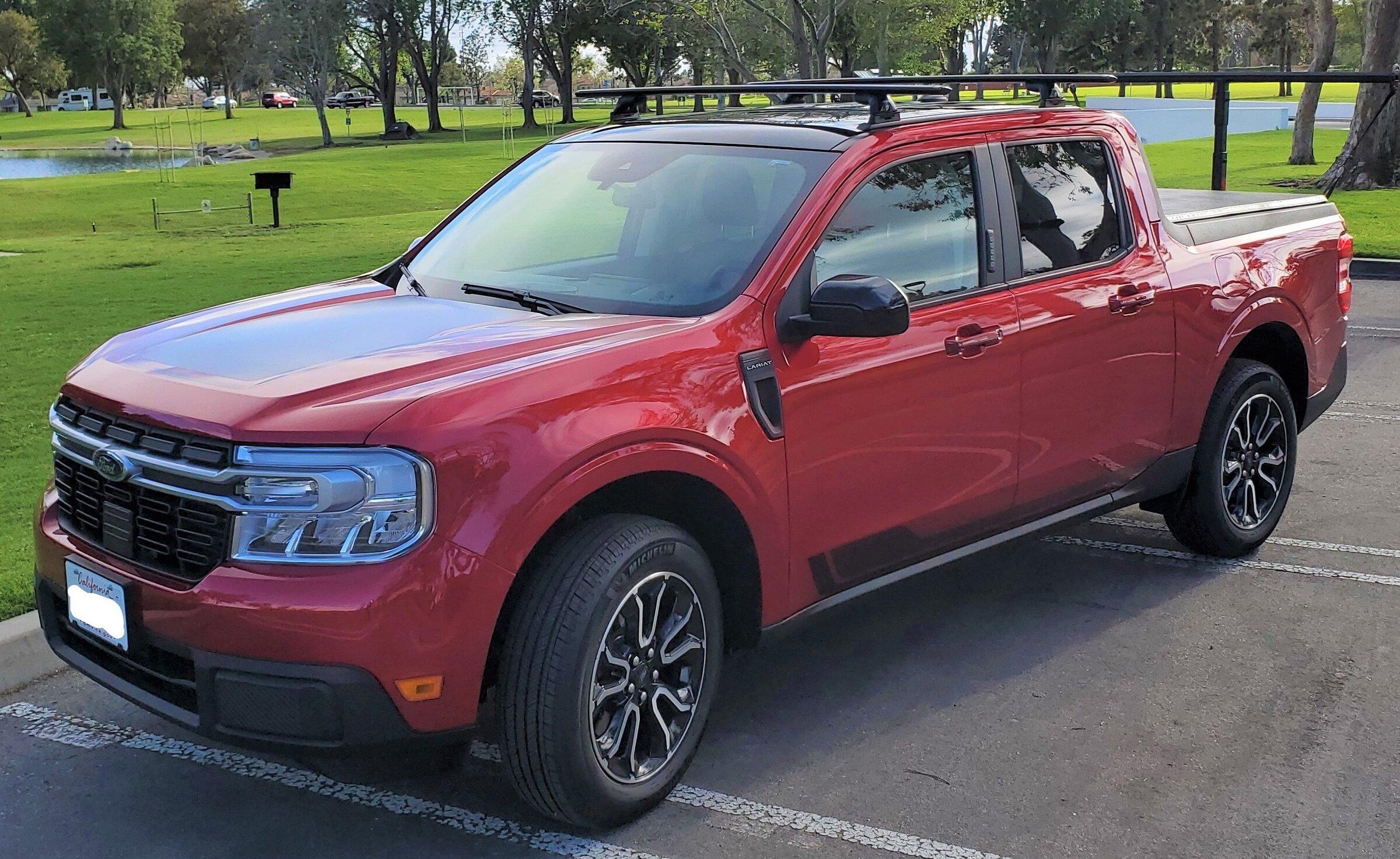

I also applied Adam's "UV Graphene Ceramic Coating" 7 year protection almost 3 weeks ago and have washed it a couple of times since. Personally, I found polishing (Adam's white pad) prior to coating a real added benefit and it definitely improved both clarity and luster of the paint. Understand I really liked the original paint job to begin with, so I was surprised how much of a difference it made. I agree that the truck looks / stays cleaner longer and the hydrophobic properties is very obvious! As far as the product I really did appreciate the UV implementation during application and it is NOT a marketing gimmick, it absolutely helped me (being a 1st timer at this). I used the UV flashlight while I was applying to ensure a complete and even application, it was very easy!
1st (2) pictures are Post-Ceramic and the 3rd is Pre-Ceramic. Although lighting is different I know I can tell the difference!

Gorgeous, you did a wonderful job with it! I love the red :) Yours likely turned out much better than mine since you were able to visually identify any inconsistencies on the spot with the UV light. I hope it lasts you a long time!
