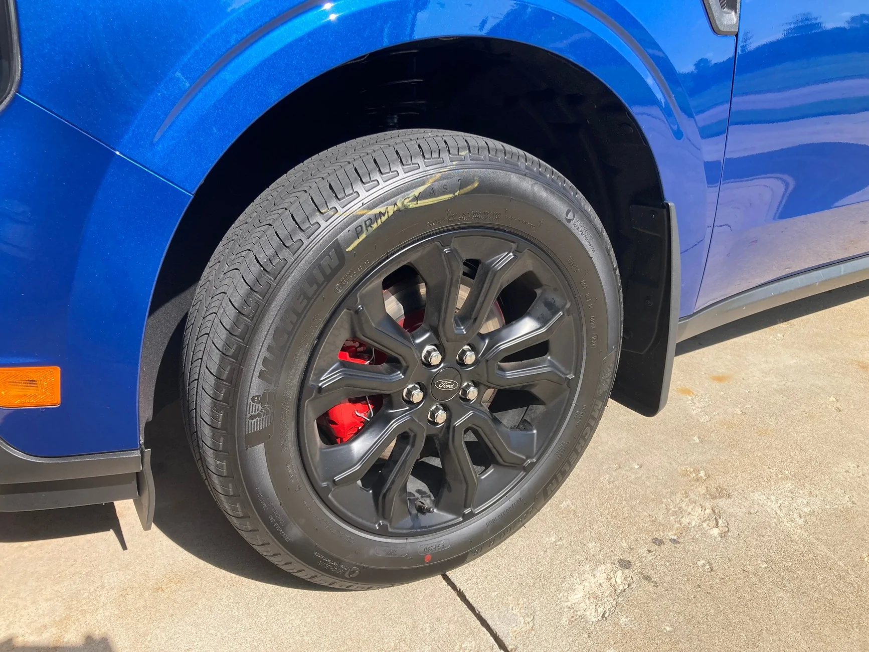

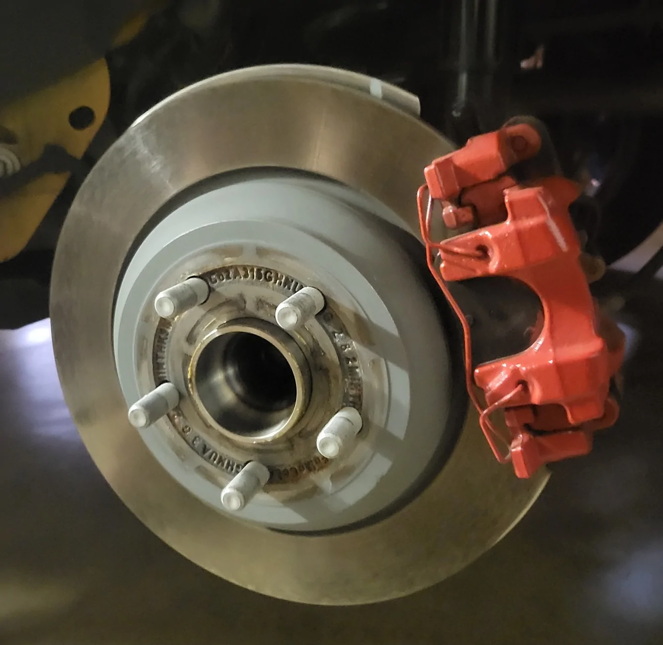

I always paint my calipers. It looks so much better thant bare metal or rust. It's very easy to do. just clean them up, mask it off, 3 coats of color and 2-3 coats of clear. I use high temp engine paint, but it is not necessarry.

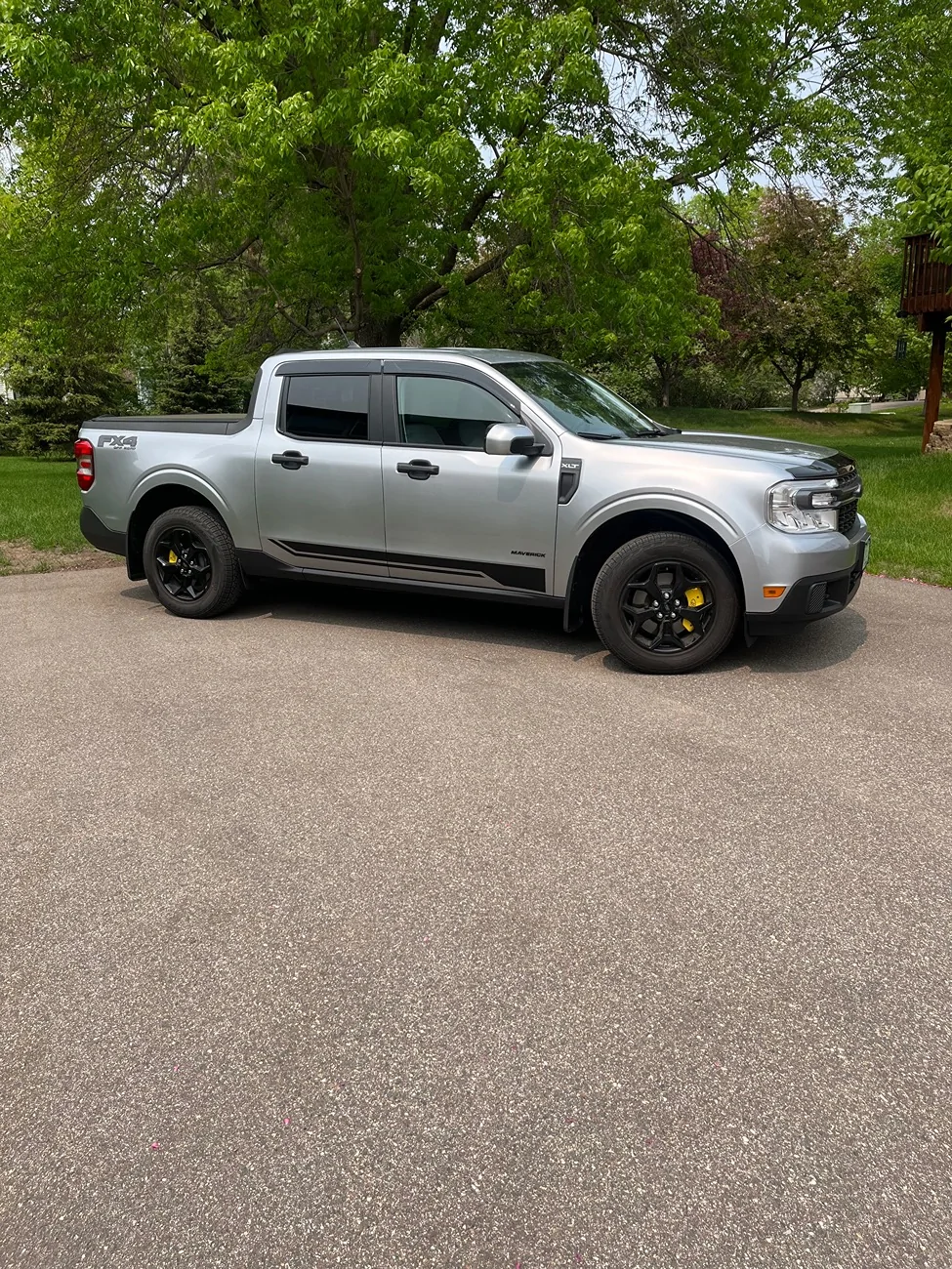

Yep, and I love the look!

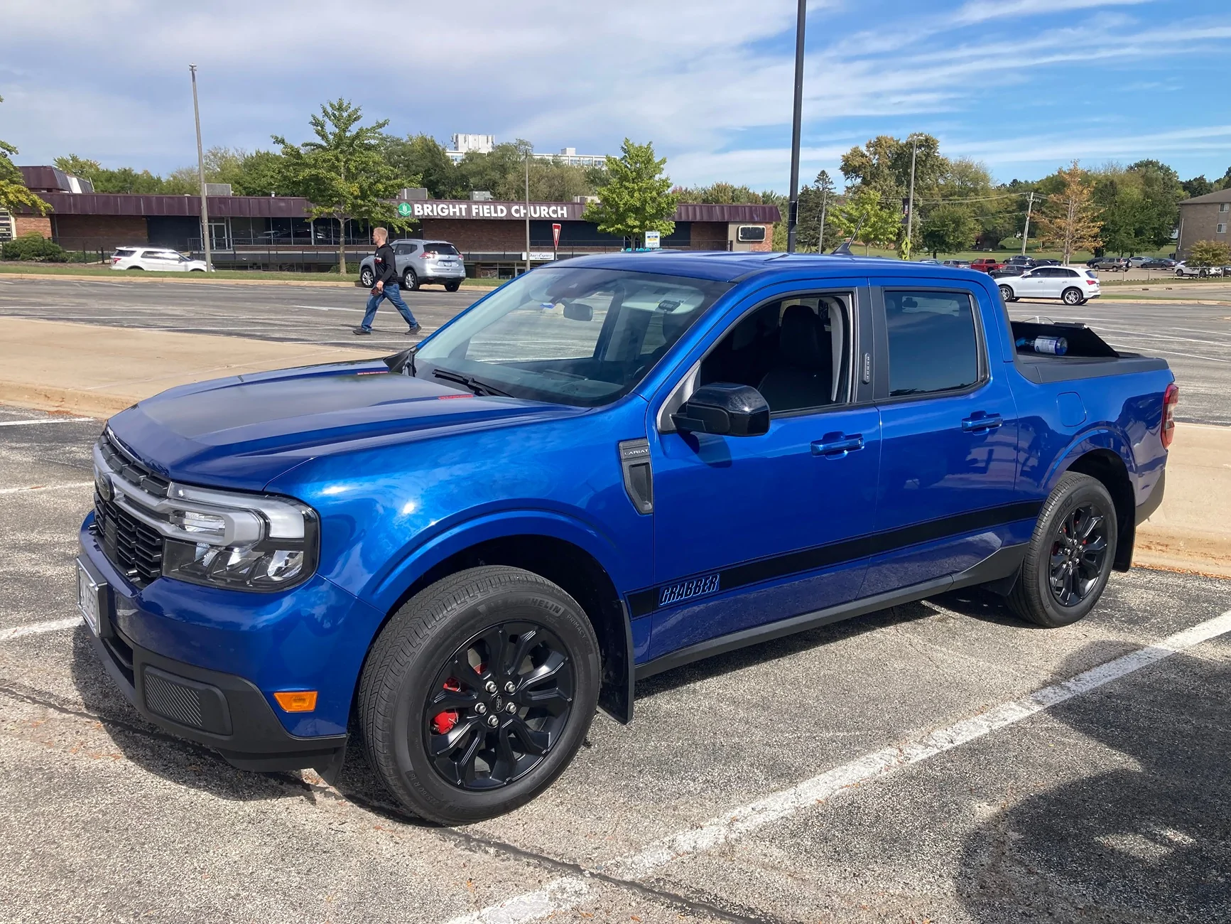

My 24 isn't a Lobo, I made it a "Grabber" and that included painting the calipers and rotor outer perimeter and hubs. Not that difficult, though removing any overspray from the braking surfaces is recommended. I used Duplicolor Caliper paint and it is holding up quite well. Last photo was taken last weekend after a year and almost 3 months, through 14,500 miles.
