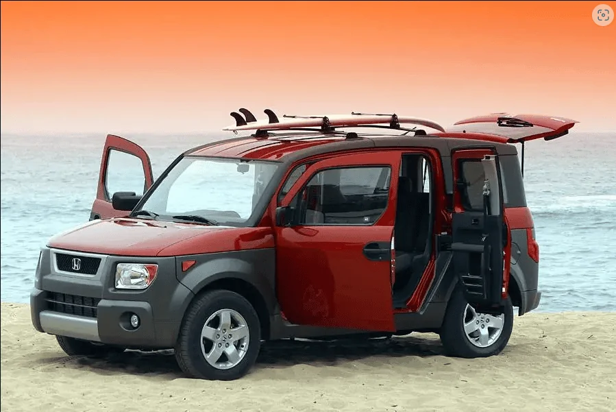

I miss my Honda Element EX AWD. Best vehicle I have ever owned. That was also a first model year and I had zero issues. All my friends hated it until they got in it.

Yes , probably my favorite all time vehicle...AWD was excellent and SUV rear half was like a bed covered pickup. Super reliable even after 255,000 miles. Only reason I sold it is quite a few parts (ie: $10 oxygen sensor) were no longer available for sale from Honda parts. If you have not noticed, there are dozens and dozens of Maverick owners on this size that moved from the Element to a Maverick.
